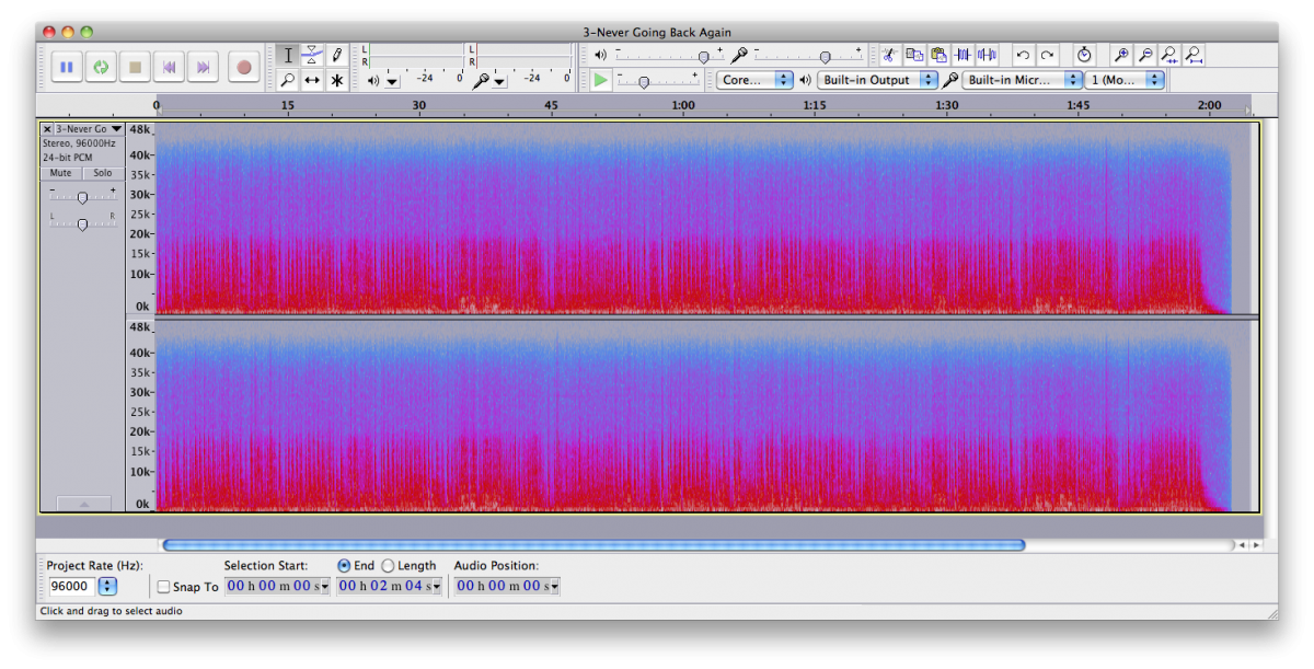

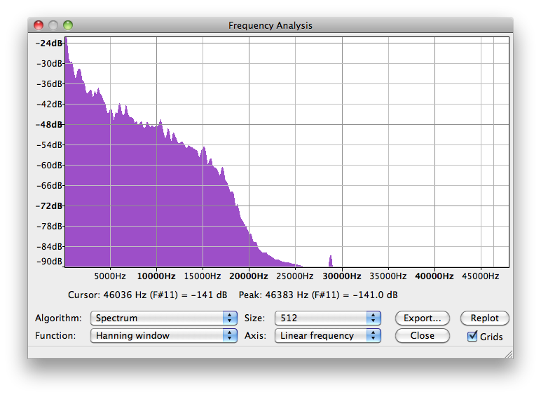

The Monkey Posted November 10, 2011 Report Share Posted November 10, 2011 I just bought Fleetwood Mac's "Rumours" from HD Tracks. It is supposedly 24/96, but with some of the recent hubbub about what is really going on inside the tracks, I downloaded Audacity and ran a Spectrum Analysis on "Never Going Back Again." The screenshot is attached. I don't know how to read these things. Can someone let me know what, if anything, can be seen here? EDIT: Added Plot Spectrum. Quote Link to comment Share on other sites More sharing options...

The Monkey Posted November 10, 2011 Author Report Share Posted November 10, 2011 Over at Computer Audiophile there are all kinds of things being alleged, I guess mostly upsampling. See here: http://www.computeraudiophile.com/content/HD-music-fft-atlas-reference-thread I edited the grab to be consistent with the linked thread. Quote Link to comment Share on other sites More sharing options...

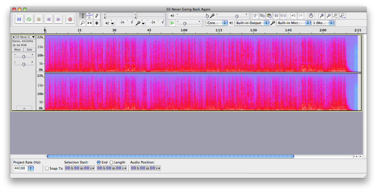

The Monkey Posted November 10, 2011 Author Report Share Posted November 10, 2011 And here's the ALAC file from the regular CD. Quote Link to comment Share on other sites More sharing options...
deepak Posted November 10, 2011 Report Share Posted November 10, 2011 Dinny a lot of the HDTracks come from rips of a DVD-A or SACD. Warner Bros preferred high res format was DVD-A so it more than likely is the 24/48 upsampled. Quote Link to comment Share on other sites More sharing options...

jp11801 Posted November 10, 2011 Report Share Posted November 10, 2011 I really like some of the stuff on HD tracks and feel most are worth the cash. Audacity's tools are not the most accurate (or so I am told) but they give you a rough idea. I'm sure someone will correct me but your first plot shows frequency activity above 22khz so likely it is 24/96 (no that you'd hear distortion and artifacts above 22khz) I'm pretty flip floppy on the whole issue. Recording needle drops high res makes a difference when encoding the analog signal and applying the RIAA curve digitally. Playback is tougher and 24/44.1 is ok or the movie standard of 24/48 is cool as well while I've heard plenty of 24/192 that sound awesome I'm not sure its needed for all recordings. Quote Link to comment Share on other sites More sharing options...
RudeWolf Posted November 10, 2011 Report Share Posted November 10, 2011 I'd just the best mastering, even if it may be redbook. Like Dreadhead I don't place much stock in high res, the mastering will make a much bigger difference (compression, EQ, etc). Same here, bit depth alone will have a hard time messing up a well mastered AND well processed recording. Looking at those spectros (and judging from the pixels I've seen in my time) I'd say that these might as well be different masters. Of course that the HD version will have stuff going on in upper frequencies, but my hearing cuts off at 19kHz so unless I project the sound with a BPP Supertweeter in my face... Also the stuff going on in higher freq can be just noise, beats me- I have a degree in talking out of my ass, not interpreting acoustic data. Quote Link to comment Share on other sites More sharing options...
Torpedo Posted November 10, 2011 Report Share Posted November 10, 2011 Dinny, it's possible we could see clearer differences (if they exist) on top harmonics (let's say from 18 to 22KHz) if you can - Adjust spectral analysis on Audacity at 1024 points (window size), increase dynamic range up to 120dB and use Blackmann-Harris window instead of hanning. - Then take a 2 seconds fragment rich on high frequency harmonics and zoom the analysis on it on both files. If they look the same, in any case we could see if the high Freq. energy on the HDT has some harmonic structure or is mainly noise. Quote Link to comment Share on other sites More sharing options...

Grahame Posted November 10, 2011 Report Share Posted November 10, 2011 (edited) Linkys HD download debacle! Thread: HiFi News Investigates the Truth Behind HD Downloads Spectragraphs are useful tools but are often misinterpreted. Some observers see bands of color in the ultra sonic range and claim, "they've a lot of detailed HF content" on a particular track. The fact is the low level stuff that's often represented is just noise that's been moved out of the audio band. http://www.itrax.com...cording-quality The Stones "Route 66": HD or Not? Given that it's possible to rip the High Rez Audio tracks from DVD-A's ( E.g. using foobar2000 ) + there are means for SACDs , you can check to see if they have any "real" High frequency content. It's also interesting as to where people think this high frequency information comes from, if you look at, say, the frequency response of studio microphones, especially those in use when the original recording was made Edited November 10, 2011 by Grahame Quote Link to comment Share on other sites More sharing options...
