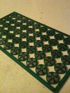

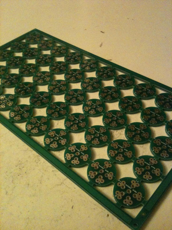

luvdunhill Posted December 1, 2011 Report Posted December 1, 2011 PCBs will be here on Tuesday. Chances are, some of you will have them in a week from today. Please, make sure I have your shipping address. If I don't, I'll be unhappy. Quote

morphsci Posted December 10, 2011 Report Posted December 10, 2011 The PCBs arrived today. They are so damn cute. Quote

manaox2 Posted December 10, 2011 Report Posted December 10, 2011 I received my boards yesterday Marc, they look great. Thanks! Quote
ironbut Posted December 11, 2011 Report Posted December 11, 2011 Got my boards as well. Thanks a million Marc! Quote
