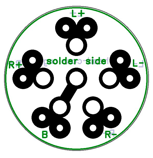

luvdunhill Posted November 13, 2011 Report Posted November 13, 2011 I am contemplating a jack PCB. I was thinking of a round board with just two wire holes next to each pin. No mounting holes. If anyone is interested, let me know. All i really need to decide is the wire diameter, i tend to use small gauge wire, but would accommodate something larger if there was a strong opinion. Also if you have better ideas let me know as well and I can accommodate them and perhaps a connector if there is strong desire for that (but it would have to be other side, as opposed to the above boar that has it on the bottom, which won't fit in my case) Quote
spritzer Posted November 14, 2011 Report Posted November 14, 2011 Something like this then: I drew this back when the T2 project started but never made any... Quote
luvdunhill Posted November 14, 2011 Report Posted November 14, 2011 yup, you got it! I'd probably actually cut them out round too. Quote

luvdunhill Posted November 27, 2011 Report Posted November 27, 2011 (edited) final cut, added a bottom silk and notation for which side is which. Also, the hole for the pins just fits the larger diameter on the pin surface. The reason is, sometimes the nuts come loose and I wanted to push the board down onto the nuts to prevent this from happening. Also, it gives more material to solder to. This is different than say how the T2 boards work, in which the hole diameter is the smaller of the pin diameters. Edited November 27, 2011 by luvdunhill Quote
