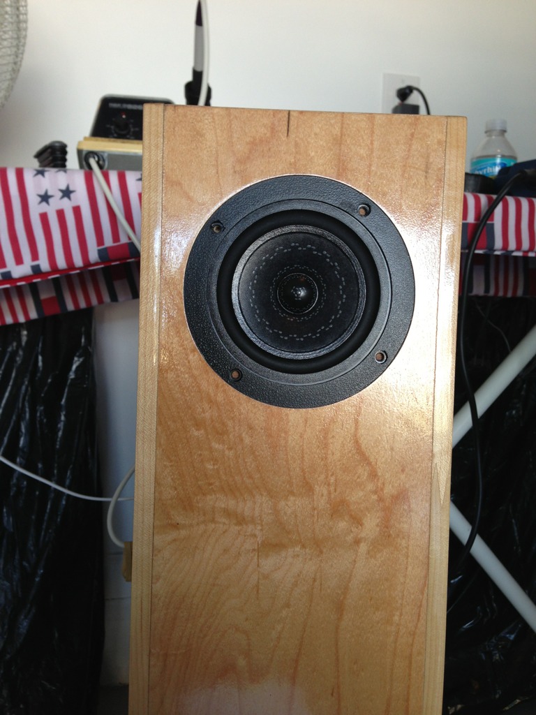

crappyjones123 Posted December 25, 2012 Report Share Posted December 25, 2012 While putting together the speakers I ran into some issues. Help would be much appreciated. 1. I placed the driver in one of the cabinets but the holes aren't lined up parallel to the sides and the top - the screw holes aren't squared like they are supposed to be. The driver is in the recessed slot where it is supposed to be and I can't get it out of there to adjust the position of the driver. Any thoughts? I am going in blind if I try to poke it out from the back hole but I am scared I will damage the driver if I try to poke it out. There is a piece of wood that blocks view of the front hole from the back hole. 2. The other driver was centered correctly with 3 screws holding it down but the 4th one's top stripped half way down into the wood. I can't screw it in further (nor do I want to in case I need to change the driver). Can't pull it out either. The gentleman at Home Depot said that the screws aren't readily available so I am not sure where to find replacements from however I am considering using plain old phillips head oval wood screws even though they won't look as nice as the supplied screws. Supplied screws are hex nut wood screws. I've tried the rubber band technique. Didn't help. Quote Link to comment Share on other sites More sharing options...

crappyjones123 Posted December 25, 2012 Report Share Posted December 25, 2012 1. Tilting was tried. It didn't work. Gave the back of the cabinets some good whacks with a hammer. Nothing. The panels were Cnc cut there there is little to no room. Quote Link to comment Share on other sites More sharing options...
crappyjones123 Posted December 25, 2012 Report Share Posted December 25, 2012 Attached a photo so people see what my problem is. It's a very tight fit from the sides as the driver is flush with the front panel. Quote Link to comment Share on other sites More sharing options...

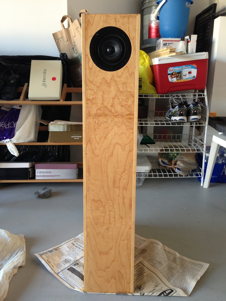

crappyjones123 Posted December 25, 2012 Report Share Posted December 25, 2012 (edited) Solved the other problem with using an sae hex key instead of metric. The other cabinet is done completely for now. It is (relatively) cold here so the oil isn't drying all too well after 4 coats. Finishing shall resume in the spring or as soon as there is more sun out during the day. But now it looks like this. Thoughts? Edited December 25, 2012 by crappyjones123 Quote Link to comment Share on other sites More sharing options...
wink Posted December 26, 2012 Report Share Posted December 26, 2012 You could use a spike and attack it through the screw holes. Or, get an old small screwdriver and bend the end of the blade about 3mm from the end. Force the blade between the back of the speaker flange and the panel and pull toward you. You may have to work your way around each screwhole in turn until the speaker comes out. Any damage will be hidden when the speaker is remounted properly. Quote Link to comment Share on other sites More sharing options...
