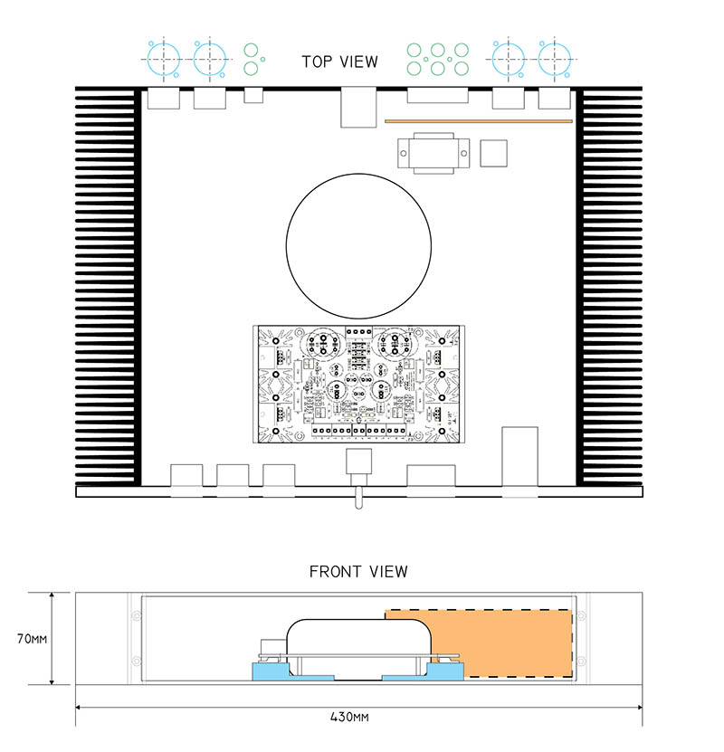

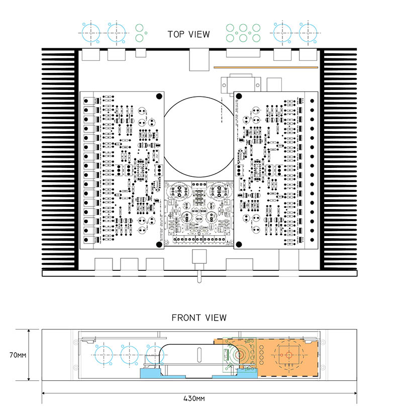

penmarker Posted October 31, 2017 Report Posted October 31, 2017 (edited) They might have changed the pricing, now its $60.52 for 8 LSK170 and $69.47 for 8 LSJ74. That there alone costs as much as some mini headphone amps. I might just gamble choosing among ~4 THAT340 instead since we can get it locally/easily from Element14. Anyway, I've purchased a chassis and thinking about doing a single chassis build. I've made a rough layout of what it could look like, appreciate it if others could chime in. 2 images; the first shows only bottom floor layout without the amp boards above it. The second shows all boards including proposed front panel layout. Toroid is in the middle and amp will be powered by single Beta22 mounted on heatsinks in blue. Orange board at the rear right is a balanced relay switcher with a small 12v transformer+BR for power. Amp boards will be attached on the top of the case and fastened to the walls with standard L profile like others. Because of the size of the transformer, the only location it could be is in the middle where there aren't any tall components on the amp board above it. Edited October 31, 2017 by penmarker
