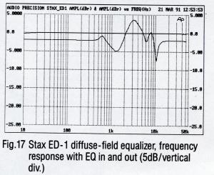

John Buchanan Posted July 9, 2011 Report Posted July 9, 2011 Stax did this with their ED-1 - an attempt to bend the frequency response of their Lambda Professional Earspeaker to the ideal diffuse field frequency response.
