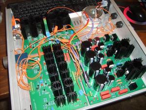

livewire Posted August 30, 2011 Report Share Posted August 30, 2011 I'd like a KGSSHV board / onboard PSU from your leftovers, when will you be accepting requests for those? To clarify - the KGSSHV consists of 2 each amp boards, left and right channels and 1 each PSU board. The PSU board is only available with onboard heatsinks, there are two different style amp boards available. One style has onboard heatsinks (2 each pcbs required) - or - the second style which utilizes off-board heatsinks. (2 each pcbs required) My prototype KGSSHV (pictured below - click to enlarge) has all three boards that employ onboard heatsinks. The other style amp pcb is physically smaller, allowing for a more compact build, especially if one wants to do a sleek two case version ala the BHSE. (sans tubes of course) Link to comment Share on other sites More sharing options...
ujamerstand Posted August 30, 2011 Report Share Posted August 30, 2011 Just curious, have you had any sort of issues with hum or noise with the transformer so close to the inputs? Link to comment Share on other sites More sharing options...
livewire Posted August 30, 2011 Report Share Posted August 30, 2011 No, none whatsoever. Totally black noise floor. I was worried about that initially, the SumR trafo I ordered had core band shielding. Since we are on that subject, I will detail some changes made since this pic was taken. The internal cable shown has 1KV insulation but no special shielding around it. When I changed over to a quad DACT I replaced the input cables to the DACT with shielded Belden 1800 stuff to insure good noise rejection. Of course I cleaned up the other cable's routing as well and got rid of the wire nuts. That was for testing only. As you know, I had a lot of that to do when I torched the PSU twice. The trafo is also now much larger, occupying that entire corner of the case. Link to comment Share on other sites More sharing options...

livewire Posted August 30, 2011 Report Share Posted August 30, 2011 (edited) If only we could fit the KGSSHV onboard in a single case with the new power supply Said case would not fit in my rack though Single case build for the onboard KGSSHV minimum size is 16"W X 16"D X 4"H. I used a Par Metal case of this size. 3" high is doable, but special HV insulated sheeting would be required to keep the underside pcb traces from shorting out to the case. (Or use shorter height heatsinks. KG warned against this, as things could overheat.) Edited August 30, 2011 by livewire Link to comment Share on other sites More sharing options...
