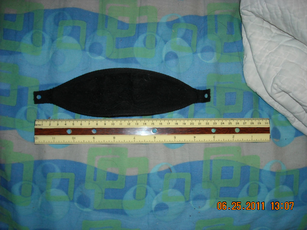

soldermizer Posted June 29, 2011 Author Report Posted June 29, 2011 Here is a pic of the removed headband. The one on the the Lambda reg. is very similar. It doesn't show well, but the extended measurements are: length = 23.5 cm; width (pulled at widest part) = 8.5 cm. There is no evidence of stretching or other damage to the unit. My adjustment for my as-yet rarely worn Lambda regular is about middle adjustment for a good "doesn't fall off" fit. Perhaps my Pro's simply have an arc assembly which has lost its springiness? In any case, my short term lesson on leather-izing my Pro's is: earpads relatively easy, headband not so easy (because for best function, it needs to have the plastic insert thingy, otherwise it just flops around and gets twisted.) Since I have much spare leather, I think I'll just experiment with the "West Virginia" method of covering up the default headband. Film at eleven.

soldermizer Posted June 30, 2011 Author Report Posted June 30, 2011 Thanks for the tip. Next I will probably try (in order, because laziness): gather my "rev 0" leather headband in the center, to figure out how much tighter it needs to be. Cover the existing band with leather (probably top and bottom) = the luxury of leather but lacks the tightening option of the headband; finally, make a thicker headband and re-install it. Stock headband was ok, it was just at the bottom of its adjustment (for biggest heads). Mom always said I was "big headed" but this referred to ego, not a gigantic cranium. If I get something half decent I will report and probaby append it to my DIY tutorial.
