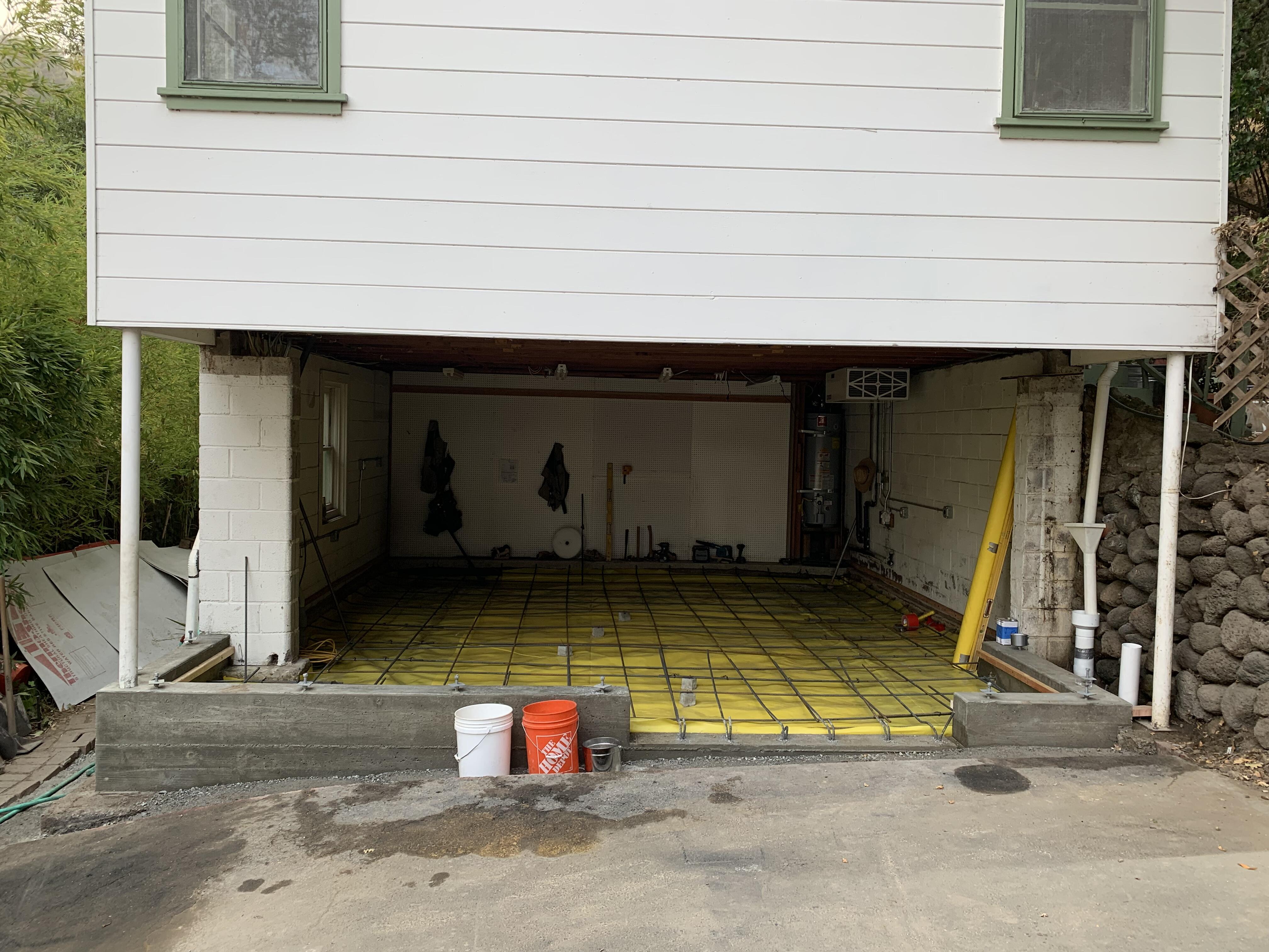

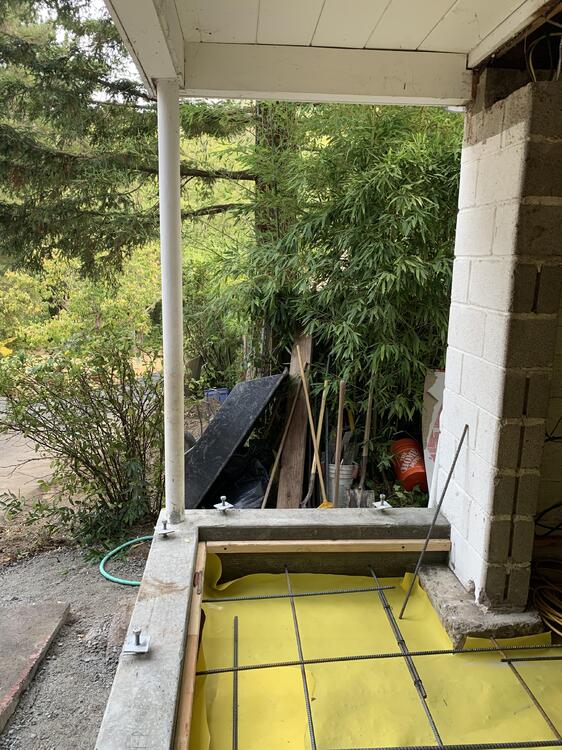

purk Posted September 25, 2021 Report Posted September 25, 2021 28 minutes ago, swt61 said: The rebar standing vertically is under the new double door. It will get bent down, before pouring the new slab, to further tie the new slab into the new footings. #5 @ 12” spacing? Quote
swt61 Posted September 25, 2021 Report Posted September 25, 2021 #5, and as close to 12" spacing as possible. 33 minutes ago, Augsburger said: I note no mention of how you are going to run the audio speaker cables down into the dungeon shop. Have you forgotten our HC DNA? Wires? We don't need no stinkin' wires! I see some Edifiers in the shop's future. 1 Quote
Voltron Posted September 26, 2021 Report Posted September 26, 2021 47 minutes ago, purk said: #5 @ 12” spacing? Correct! The contractor thought the extra steel was worth the small difference even where he could have used 3 or 4. The lally column on the left that is hidden behind the wood brace was wrapped with rebar to really tie it in. Both columns were undermined part way so that they key into the footings under the foundation wall. The temp posts and beams will come out when they remove the forms from the shop side of the foundation wall. The new slab will be tied in as Steve described and will top out five inches below the top of the foundation wall. A big improvement over the prior garage slab that ranged from 2.3-3" with no rebar and the lally column pads were just on dirt. 3 Quote

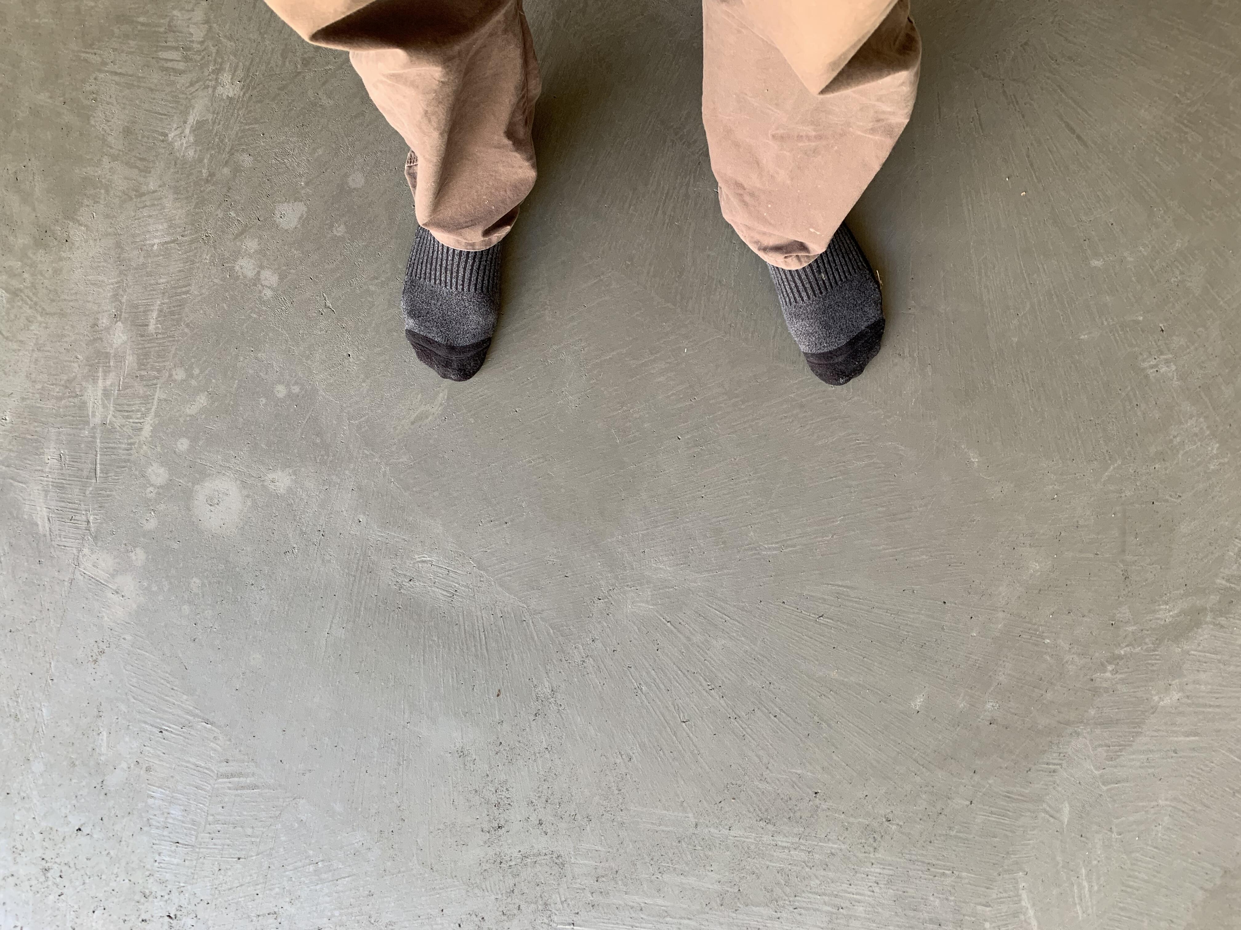

swt61 Posted September 26, 2021 Report Posted September 26, 2021 So it'll be safe even for a fat bastard like me to walk on! Seriously though, the goal is a strong and smooth slab, because all of the big tools will be rolled into and out of place as necessary. Al hired a great crew. I'm impressed with their work ethic and attention to detail. That and the fact that I haven't had to pick up a shovel. 1 Quote

purk Posted September 26, 2021 Report Posted September 26, 2021 Extra reinforcement will really come in handy in many ways. It will minimize slab cracking also allowing greater flexural and shear strength. Concrete is strong in compression but weak in tension. Quote
swt61 Posted September 26, 2021 Report Posted September 26, 2021 (edited) 4 hours ago, Craig Sawyers said: The main thing for a workshop in an ex-garage is to make sure the floor slopes slightly downhill to the door to prevent rain ingress. Doesn't take much rake to be effective. No slope. We will have a curb on the front wall, and around the sides of the extension, except under the double doors, which will have a sheetmetal pan installed under it, to further ward off any water. Not to mention the slope of the ground in front of the garage carries the water away from the shop. All things we've considered. This will not have a garage door anymore, so no need for a flat, curbless entry. Edited September 26, 2021 by swt61 4 Quote

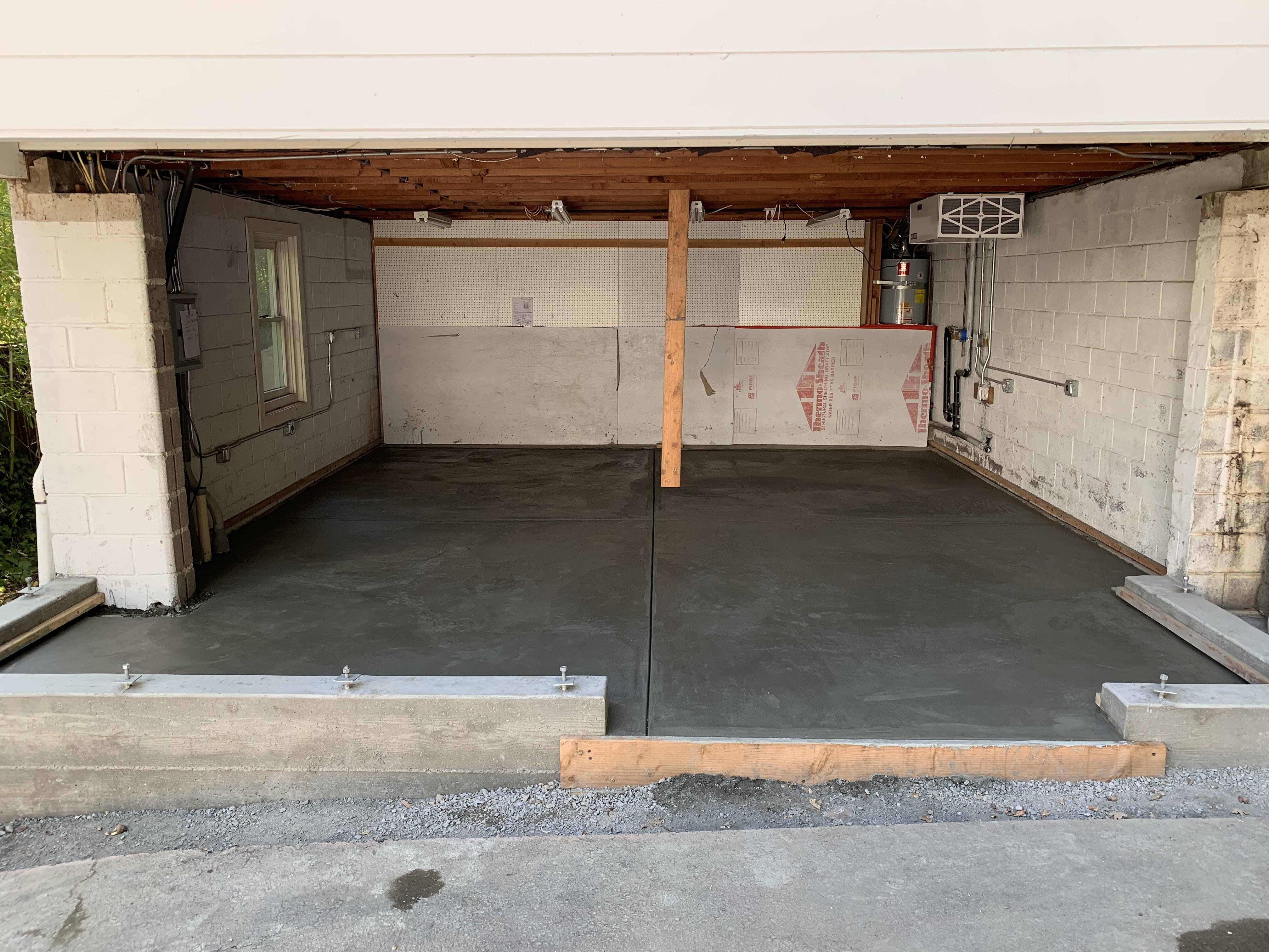

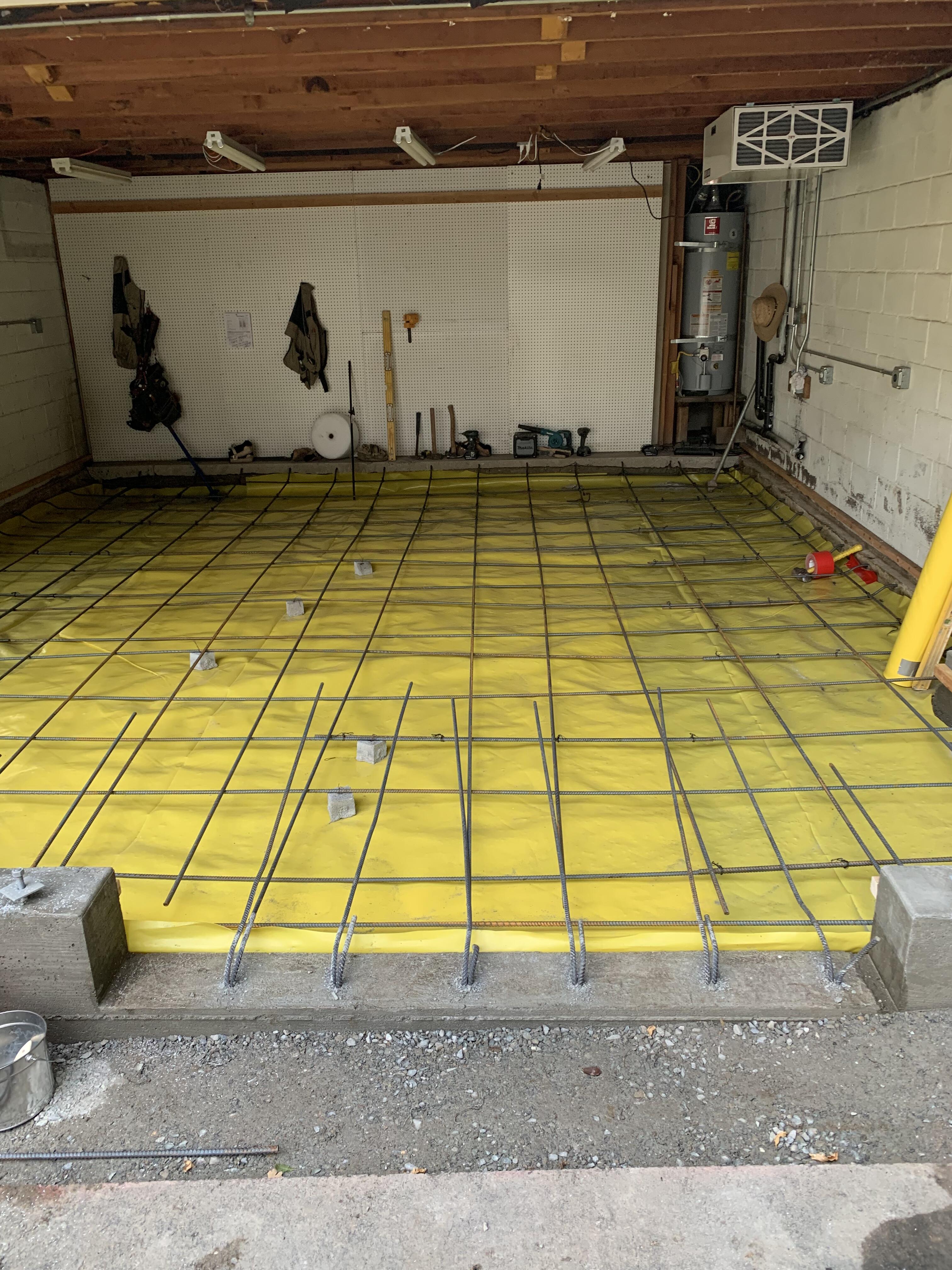

Voltron Posted September 28, 2021 Report Posted September 28, 2021 Moar steel and a vapor barrier. 15 1 Quote

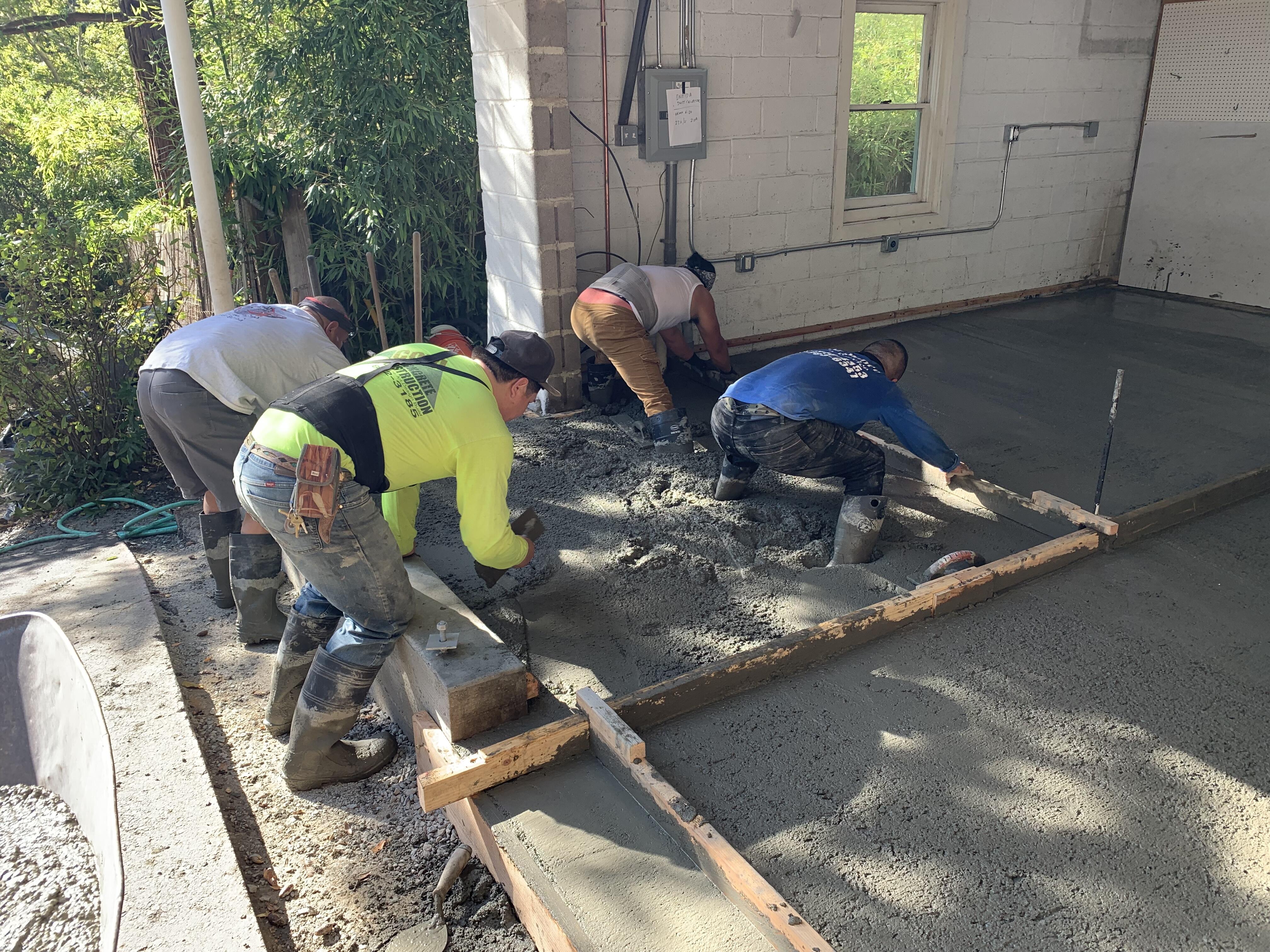

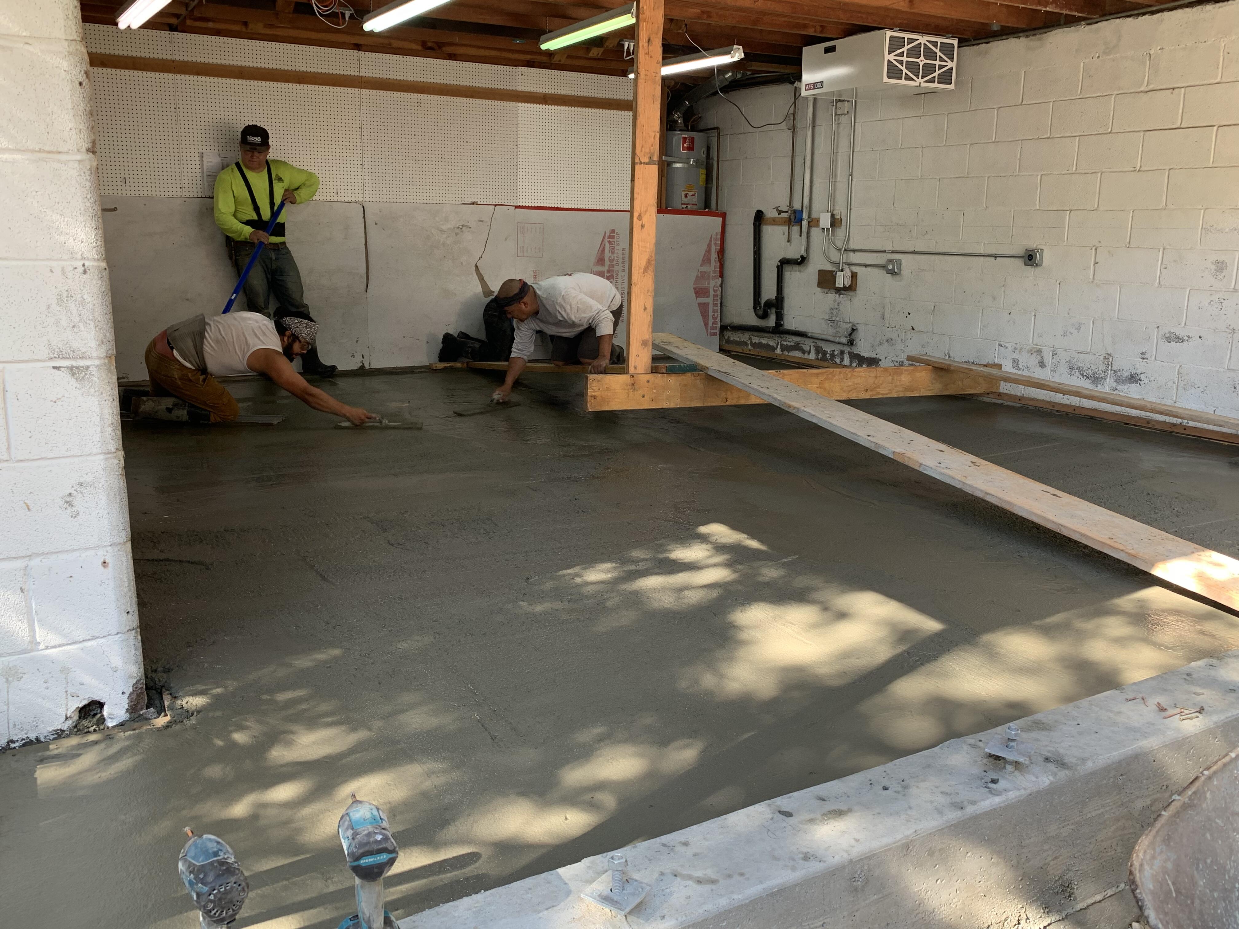

Voltron Posted October 2, 2021 Report Posted October 2, 2021 (edited) And...it's done. We'll, the concrete part. Steve and I need to build a wall, put in doors and a window, get a little electrical done, and then start making sawdust again. This time with a serious dust collection system and air filter in place. Edited October 2, 2021 by Voltron 19 Quote
