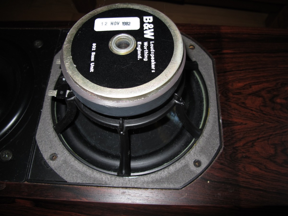

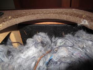

Zonker92 Posted November 15, 2010 Report Posted November 15, 2010 Did you know that lefties are brain-damaged from birth and live five years shorter lives than righties? At least that's what I told my sinister sister-in-law. OK, this morning I popped mine open and but for the spider spunk it's the same as the Monkey's. November 82 is the date on the bass driver I pulled. I was pleased to see a lot of internal bracing (making them almost Matrices I guess) and some heavy sound damping boards stapled to the inner walls and inner base. My crossover (APOC, no battery) looks much like the one I showed on page 3 of this thread, but without the fucked-up capacitor. The colors are a little different too. Are these electrolytics? Should I replace them? If I wanted to bypass the APOC I would cut the (three?) diodes out and remove the relay? Quote

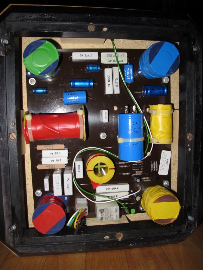

spritzer Posted November 15, 2010 Report Posted November 15, 2010 Those are electrolytics and I for one would replace them. These are about as old as me so well past their sell by date. If you can't fit polyprop caps in there I'd recommend something like the Nichicon ES series which are non-polar. They are radials though... Quote
Zonker92 Posted November 15, 2010 Report Posted November 15, 2010 Thanks! I'm counting seven caps, and I can solder and identify a cap from a diode or resistor or transistor, but that's about the extent of my Mad electrical Skilz. Which is another way of saying I wouldn't know which caps to replace them with. Are the white rectangular units caps, too, along with the blue tubular ones? I guess I could send a high-res photo and this schematic to one of the Parts Express gurus and ask them to give me a parts list of comparable caps. I just don't want to run into the risks Monkey quoted here about screwing up the crossovers with the wrong replacements. Still gotta figure out how to bypass the APOC, too, if I so choose. I guess on the schematic posted above, I could just "short circuit" the entire protection circuit at the bottom of the page? Quote

spritzer Posted November 15, 2010 Report Posted November 15, 2010 The white sand cast bricks are resistors and you can certainly get better units such as the non-inductive Mills and the Mundorf stuff. The other white boxes (such as the one in the upper left hand corner above) are film caps. You could replace them as well and it might be worth to do so. As for choosing parts, we can help you with that. If either of you has a high res picture then that would be a great thing to have and also measure the distance between the mounting holes and how much wider a new cap could be. Quote
Zonker92 Posted November 15, 2010 Report Posted November 15, 2010 Thanks! That's a very generous offer and I do have a huge photo of the board. But (dammit) at the urging of some enthusiasts I put my camera into RAW mode so now, predictably, I can't open the files in Photoshop CS2, and the RAW plug-in (3.7) isn't helping. Shit. Sigh. Maybe I'll tear it open again and go back to shooting JPGs, as I've been doing quite happily for ten years now. It's super-easy to get at the crossovers, but the cabinets are really heavy to tip over and set right again safely. Quote
