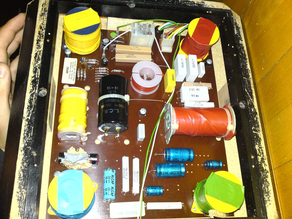

Zonker92 Posted November 8, 2010 Report Posted November 8, 2010 I found this thread and had to register to chime in: I have a minty pair of 802 Series 80s, but I guess mine are a slightly newer style, without the rear controls. I'm posting to say that I understand that their crossovers are located under the fabric covers on top of the lower cabinets, just under the heads. I don't really plan to mess with mine, since my speakers really sound terrific to me, although this thread does give me some concern about dried electrolytes. I found this photo on line, which appears to be an 802 crossover with the APOC circuit. I don't know if it's stock, but I think so. The "Model 802" owner's manual I downloaded says they are maintenance fee; they don't need a battery and are powered by the amp. I tried to look at my crossovers just out of curiosity, a few days ago. I removed the heads and tugged at the fabric covers but they wouldn't budge, so I didn't force them. Based on this photo, I don't think the crossovers are accessible from the mid-bass driver openings ... [EDIT] But then I just found this thread which claims that they are battery-powered and that the batteries do need to be replaced, so maybe the owner's manual I have is the wrong one, as this photo. I'm kind of confused at this point. Eric Quote
Zonker92 Posted November 8, 2010 Report Posted November 8, 2010 But see this: AudioKarma.org Home Audio Stereo Discussion Forums - View Single Post - B&W Series 80 Model 802 Speakers The brochure here states that the series 80 did have APOC. I'm thinking these speakers had several versions. (See here: http://www.audioasylum.com/audio/speakers/messages/23/230902.html) But what did "Series 80" mean anyway? Was it a reference to the 1980s? Quote

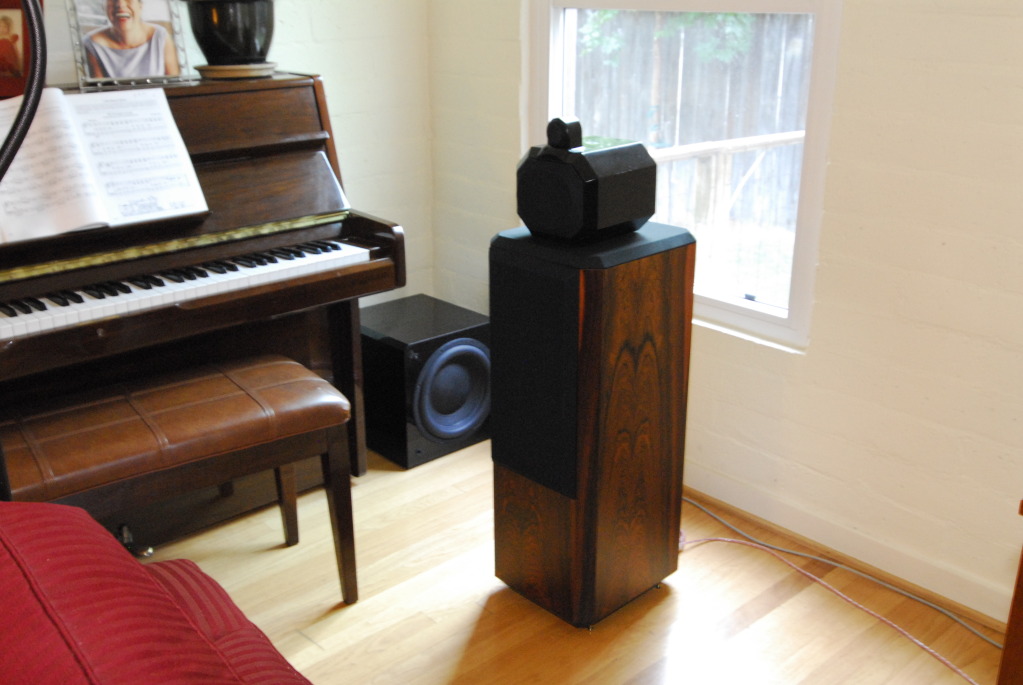

Zonker92 Posted November 8, 2010 Report Posted November 8, 2010 Thanks, Monkey. Mine are super-clean; I think the (bookmatched) veneer is rosewood. Looks like new. They don't have the hoods over them or the posts for the hoods, but that's fine with me. The mid-bass drivers are not ported so no spiders in mine, I hope. (I recently bought some JBL 4311s for $25 on Craigslist and spent about $400 restoring them for my garage stereo; they had a dead mouse and a lot of mouse turds inside, and a Happy Meal toy.) I guess what I want to know is:Which version of the Series 80 do I have?Do they need new batteries or even have batteries?Do they have a matrix enclosure?What the heck does "Series 80" even mean? My surfing on Audiogon, eBay, here and elsewhere just gave me more questions than I had already. I've seen what appear to be my speakers, but with controls on the heads. I've seen them with ports and without. I've seen them with cloth tweeters and metal ones. I've seen them with single pairs of terminals and dual pairs. I've seen them referred to as Series 80s, IIs and IIIs. I've seen people say they have APOC or don't, and they have batteries or don't. My best guess is that the portless ones with controls were first (802 Series 80 v1?), then mine (portless without controls) (802 Series 80 v2?), then ported with soft domes and no controls (Matrix Series II?), then ported with metal domes and no controls (Matrix Series III?). But that's just my guess at this point. Phew. Too much caffeine I guess. 1 Quote
Zonker92 Posted November 9, 2010 Report Posted November 9, 2010 Then there's this: Speaker Asylum - Re: B&W 802's Series 80 - JerryS, July 31, 2006 at 09:40:06 There were three versions of the 802 before the N802, IIRC. The first had the APOC (clipping protection), and was just called 802. Then came the Series 80 802 Series 2 and Series 3. The Series 80 all used the Matrix enclosure. The Series 2 had the APOC; the Series 3 did not. I had the "802 Series 80 Matrix Series 2". Disconnecting the APOC made a big improvement to the sound. I also upgraded resistors and caps for just a minor improvement. At the time the Series 3 was introduced, there was some talk that it did not sound as good as the Series 2 because when the power handling of the drivers was increased to eliminate the APOC, the sound quality suffered. I did not verify this. The 802 Series 2 had a list price of $4000, and the active "bass booster" BAF was an extra cost option. Many times I have wondered if selling my 802-2 was a mistake. Please see the link to my review below. I think this is wrong. The 802 matrix series 2 and 3 photos I've found did not refer to their being "Series 80." I think maybe the Series 80 (versions 1 and 2) came first, with no ports, then came the Matrix Series 2 and 3, which were ported. Quote
