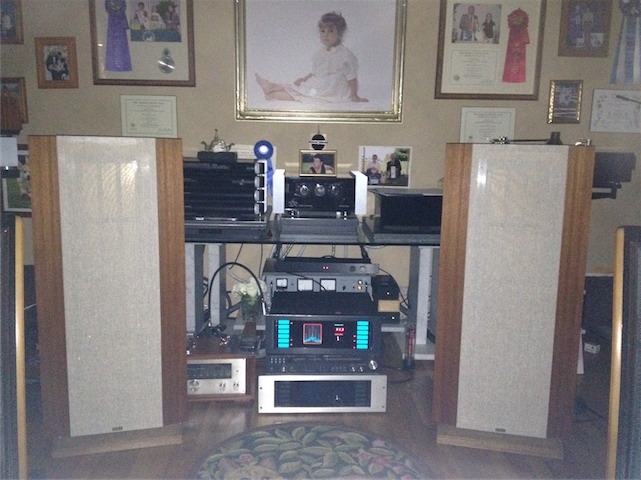

faust3d Posted December 4, 2010 Author Report Posted December 4, 2010 Played with positioning and found this works the best: Plus now my apartment looks like a magazine advertisement from the 70's
faust3d Posted December 5, 2010 Author Report Posted December 5, 2010 I really should get sepia colored glasses.
