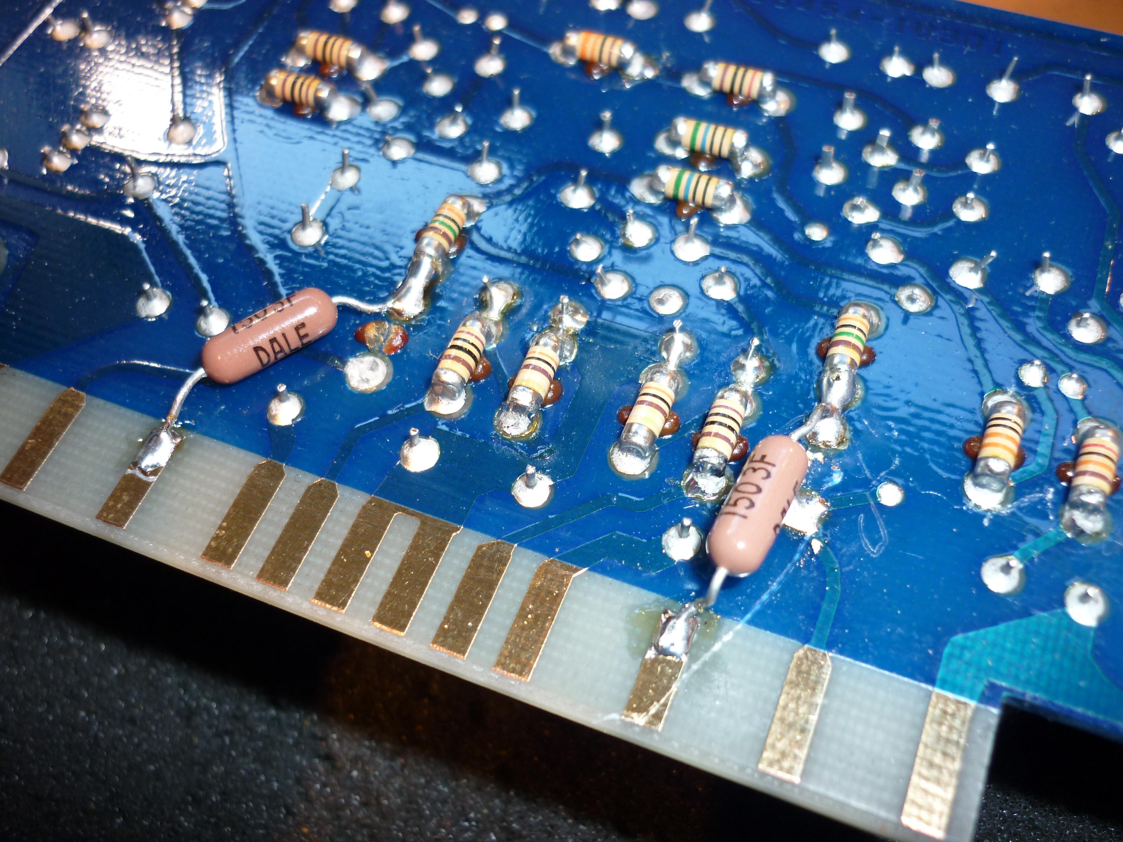

kevin gilmore Posted October 29, 2019 Author Report Share Posted October 29, 2019 picture attached 1 Quote Link to comment Share on other sites More sharing options...

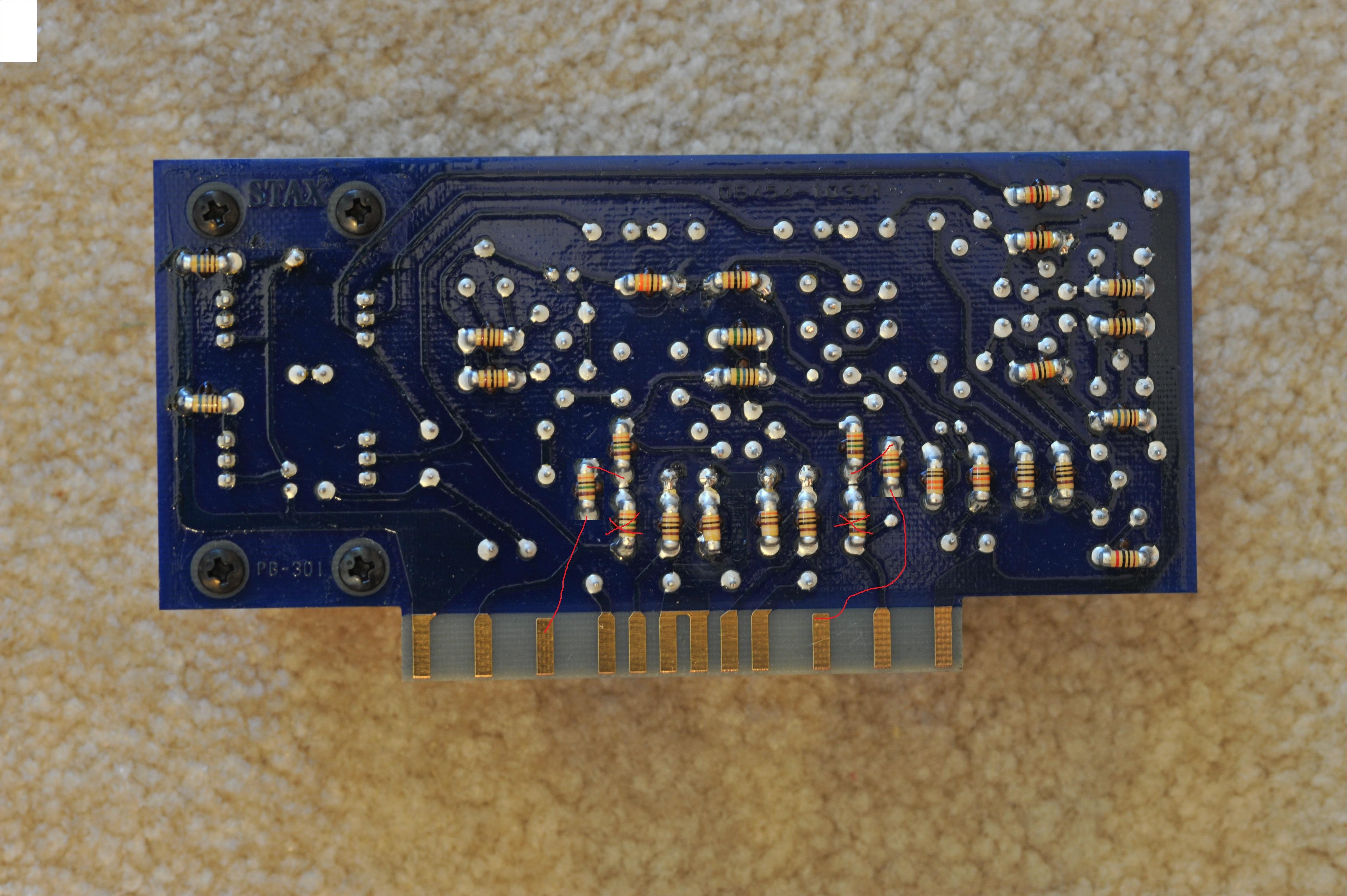

spritzer Posted October 29, 2019 Report Share Posted October 29, 2019 Here is how I did the first one: 1 Quote Link to comment Share on other sites More sharing options...
Something Incongruous Posted October 29, 2019 Report Share Posted October 29, 2019 You're very kind, thank you both Really appreciate it. (and here's to hoping one day i'll get to email about a Carbon. There's this bank i've my eye on..) Quote Link to comment Share on other sites More sharing options...
