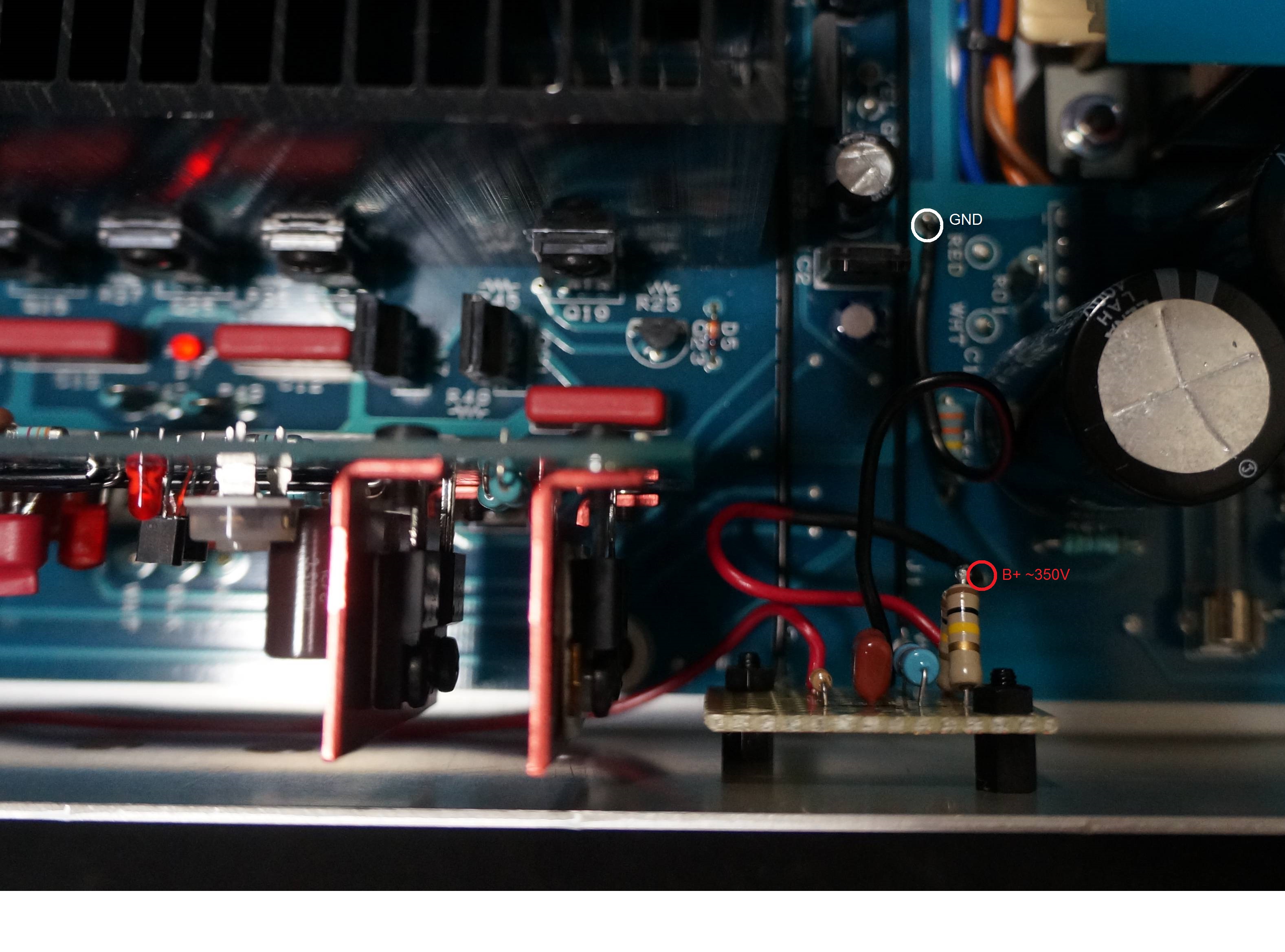

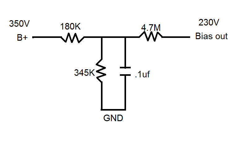

Arthrimus Posted June 17, 2016 Report Posted June 17, 2016 Is there a place on the 727's board where a normal bias line could be tapped? I will be adding normal bias to my amp since I only have normal bias phones right now. I could just tap the 120v line and put in an SRD style bias supply but if there is a place on the board that could be tapped for the bias supply that would require less components that would be cool to know. Quote
spritzer Posted June 17, 2016 Report Posted June 17, 2016 The B+ fed through a voltage divider will work just fine. Just be warned that it is an epic pain to get the Stax sockets out of the chassis. Quote
Arthrimus Posted June 17, 2016 Report Posted June 17, 2016 (edited) Oh I know. Believe me, that part of the operation is already complete. I installed the six pin sockets last night. I like the daughter board they are using now. The old jumpers between the sockets were far from elegant. Edit: So if I'm understanding you spritzer, I'll basically be building the SRM-1 Mk2 low bias supply. B+ from the 727 is 350v correct? So a voltage divider for this would be B+ into a 180K resistor with a 345K resistor to ground then a .1uf capacitor to ground before a 4.7m resistor to the bias pin. Edited June 18, 2016 by Arthrimus Quote

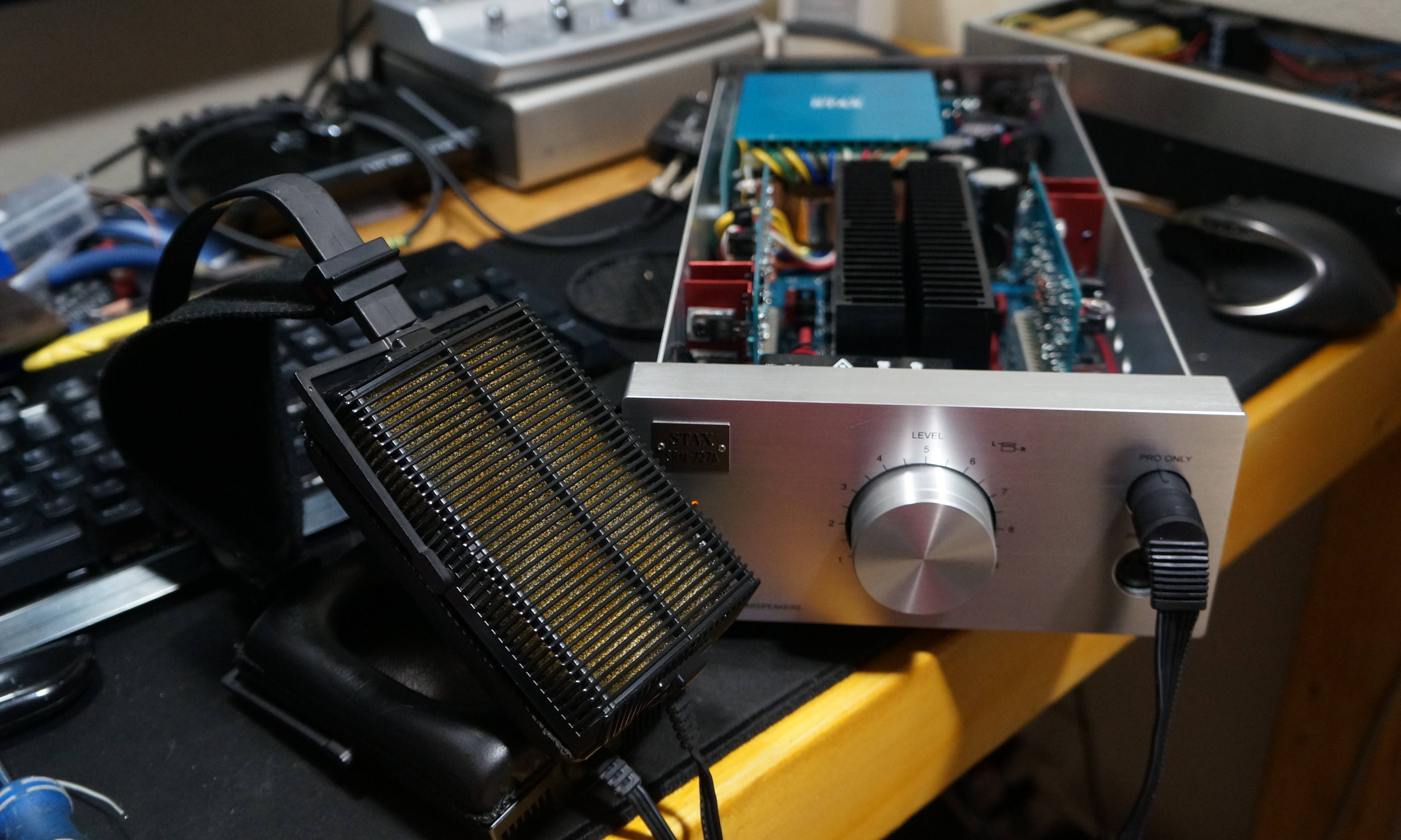

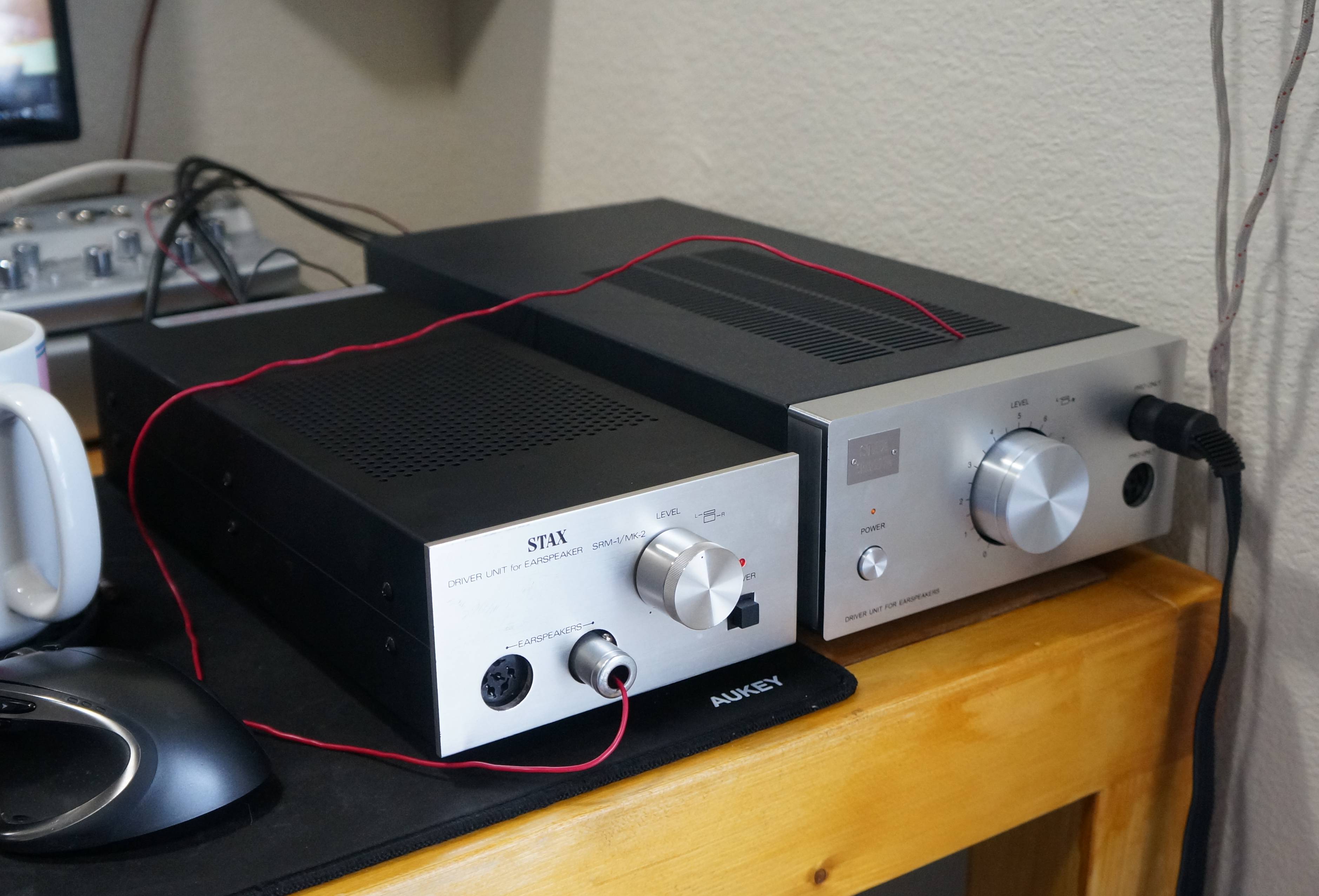

Arthrimus Posted June 20, 2016 Report Posted June 20, 2016 (edited) My step down transformer arrived today and the SRM-727a is singing. I'm still waiting for a couple of the components for my normal bias supply to get here so for now I'm borrowing the bias supply from my SRM-1 Mk2. I also volume matched them with a 50hz sine wave and a voltmeter and am doing some A-B comparisons. So far what I've learned is that the SRM-1 Mk2 is a really good sounding amp. I'm really not that impressed by the 727. Of course I haven't yet performed the feedback and gain mods, and I only have a pair of SR-Lambda NB to test with but still. I think in stock form the SRM-1 Mk2 probably sounds better than the 727a. This is all part of my multi year plan to acquire an Omega 2 so it was a necessary upgrade regardless. Off to do some mods! Edited June 20, 2016 by Arthrimus Quote

kevin gilmore Posted June 20, 2016 Author Report Posted June 20, 2016 there had better be a chassis to chassis connect between the two of those, otherwise you are in for a surprise! Quote

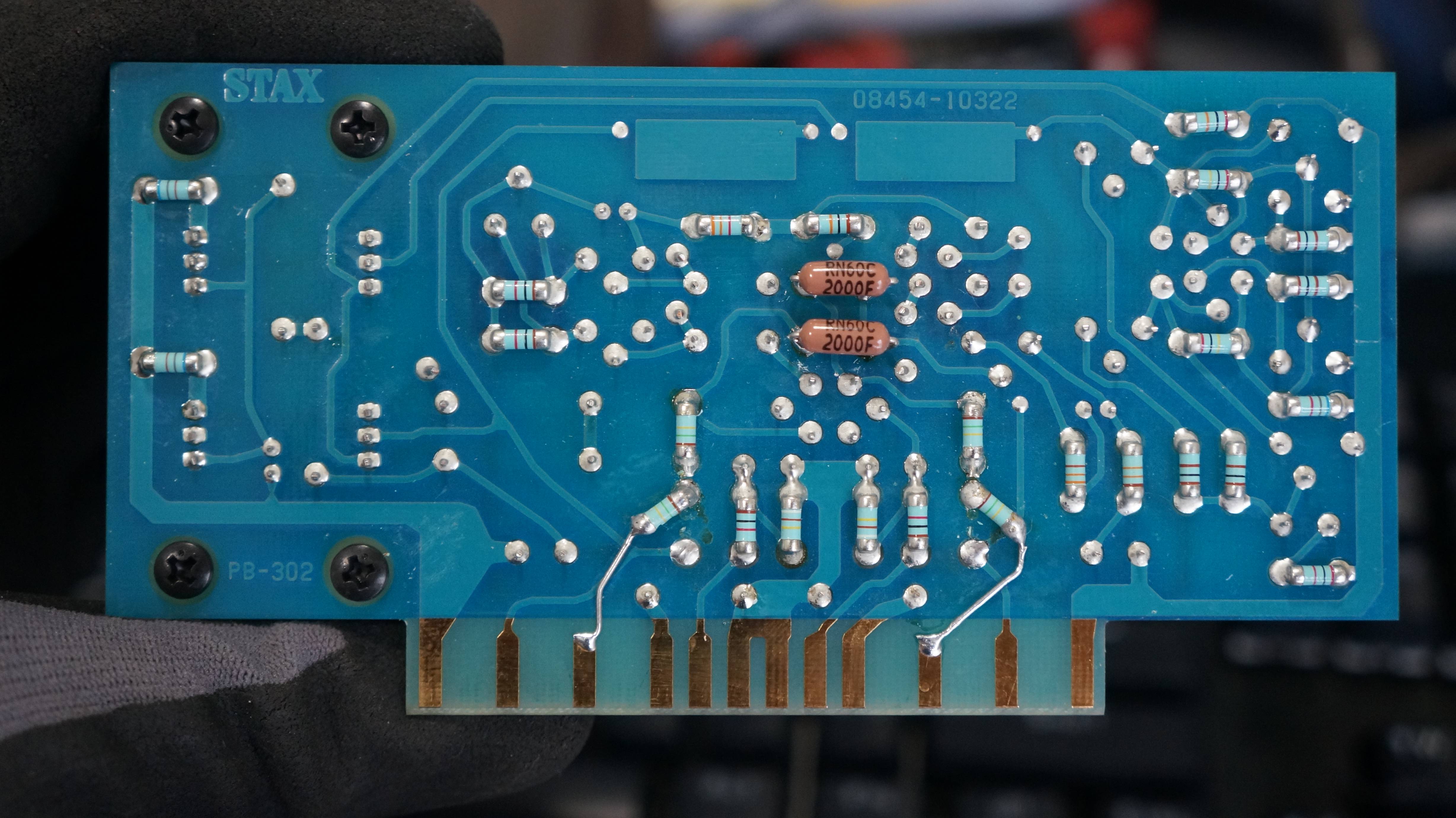

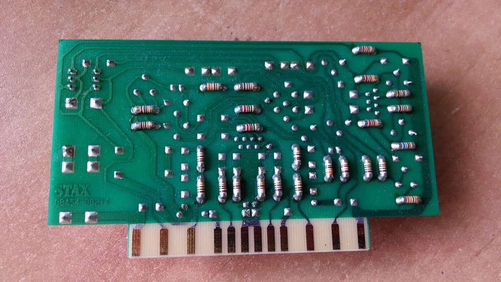

Arthrimus Posted June 20, 2016 Report Posted June 20, 2016 (edited) There is. The ground lugs on both amps are bonded together. Edit: The mods are complete and it sounds a lot better now. This new version of the board has hardly any glue on the resistors so I was able to remove them with little damage. The feedback resistors tested good so I just reused them. The bass struck me as the most problematic thing with the amp before the mod, but now it's under control and sounds really good to these ears. The gain fix was also substantial, before the mod the 727 had to be turned past 2:00 to match the SRM-1 Mk2 at noon, now the situation is almost exactly reversed. I still don't think it sounds substantially better than the SRM-1 Mk2 but as I said before this was a necessary upgrade for my future plans. Edited June 20, 2016 by Arthrimus Quote
Arthrimus Posted June 24, 2016 Report Posted June 24, 2016 (edited) Well I don't know how many normal bias only SRM-727s exist, but I have one. I got the bias board built and installed today. I'm still waiting for one of the resistor values to arrive here, so for the moment I've ghetto rigged a couple of 100K resistors in series to get 200K on the first resistor, and I've switched the second resistor in the divider to 300K because I needed some for my SRX plus build and I figured I'd kill two birds with one stone. B+ runs a little hot on my amp at 365v so all together this setup yields a 225v Bias. I've got some 165K resistors enroute to replace the rigged 200k resistor on the input side so the final board should yield around 235V bias which I'm thinking will be just fine. The board is mounted to the side of the chassis on some nylon standoffs. Ground and B+ were tapped off of the test points on the board as indicated in the picture below. For ground you could actually just ground to the chassis using brass standoffs and connect ground on the bias board to one of the standoffs. I didn't have any brass standoffs so I just ran a wire for ground. She's powered up and my Lambda NBs are singing with the amp completely untethered so I'm happy. Mod success! If anybody else wants to build a bias supply like this the above schematic and values are correct as confirmed by spritzer. I'd also like to amend my previous comments on the sound of this amp. It's been a slow burner for me, but I've really warmed up to the sound. It's a little warmer than the SRM-1 MK2 which I think in short term A-B testing makes the 727 sound a little veiled. But actually all of the detail is there, it's just not as in your face as with the SRM-1 Mk2. I'm not great with all the audiophile lingo, so it's tough for me to describe exactly what this amp does, but I guess if I had to generalize I'd say it sounds more natural and effortless than the SRM-1 Mk2. It's strength is especially apparent with percussion instruments. I've listened to this amp for around 20 hours at this point, going through a significant chunk of my music collection that I'm really familiar with, and I prefer it's presentation over the SRM-1 Mk2 on everything I've heard so far. Well I think I'm done here, this is my new main amp, at least until I build the SRX Plus, but that will probably be a while. Edited June 24, 2016 by Arthrimus 3 Quote
