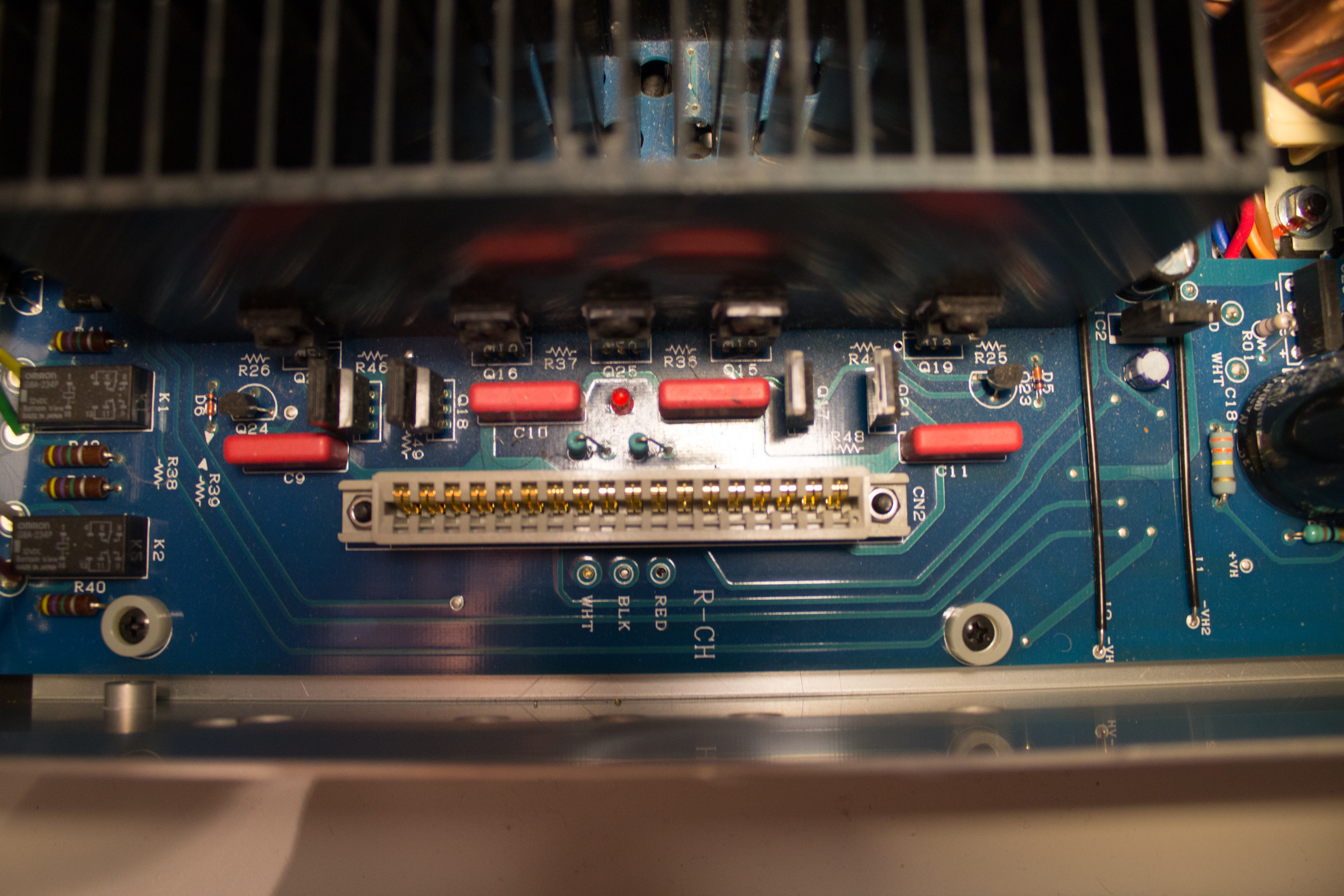

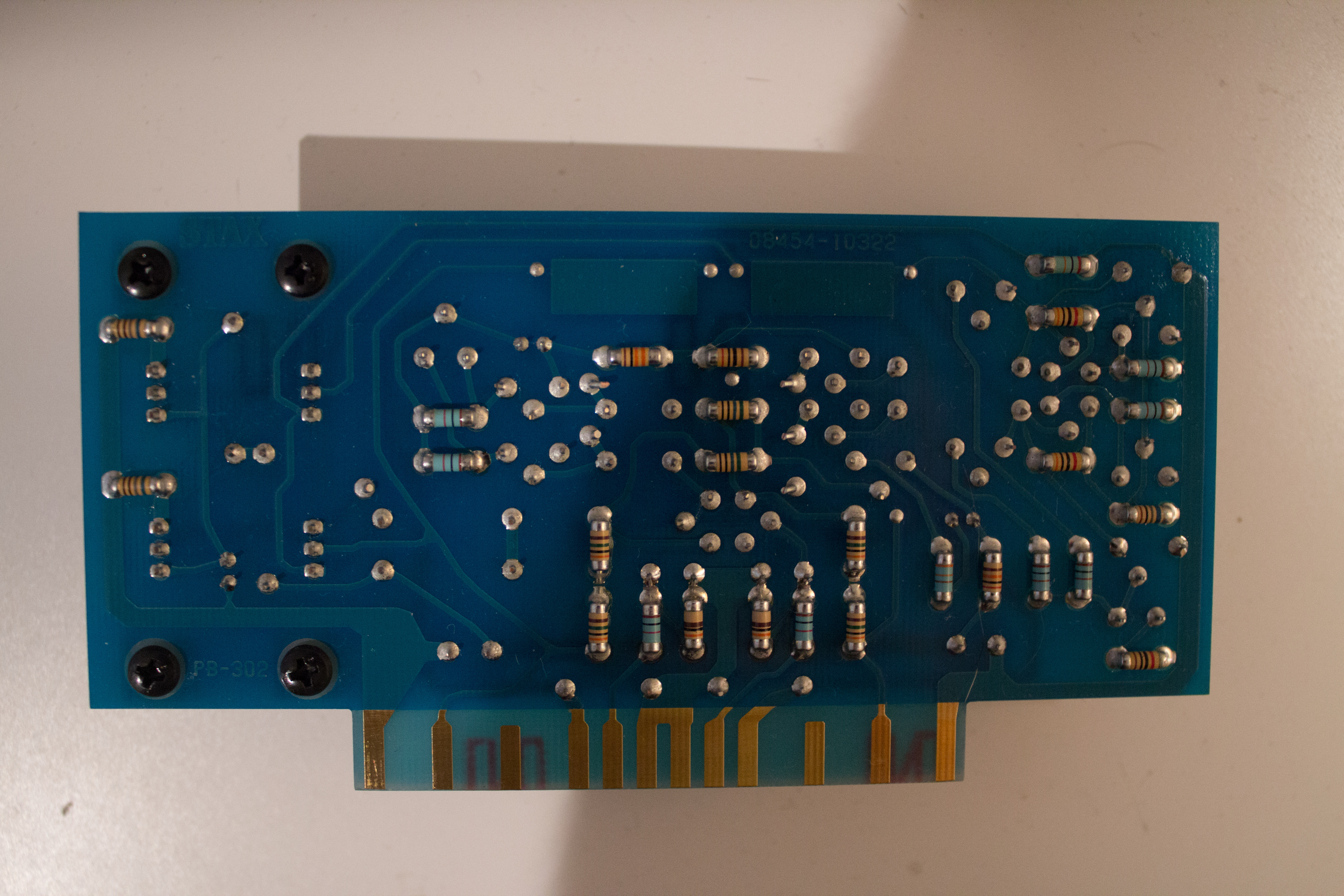

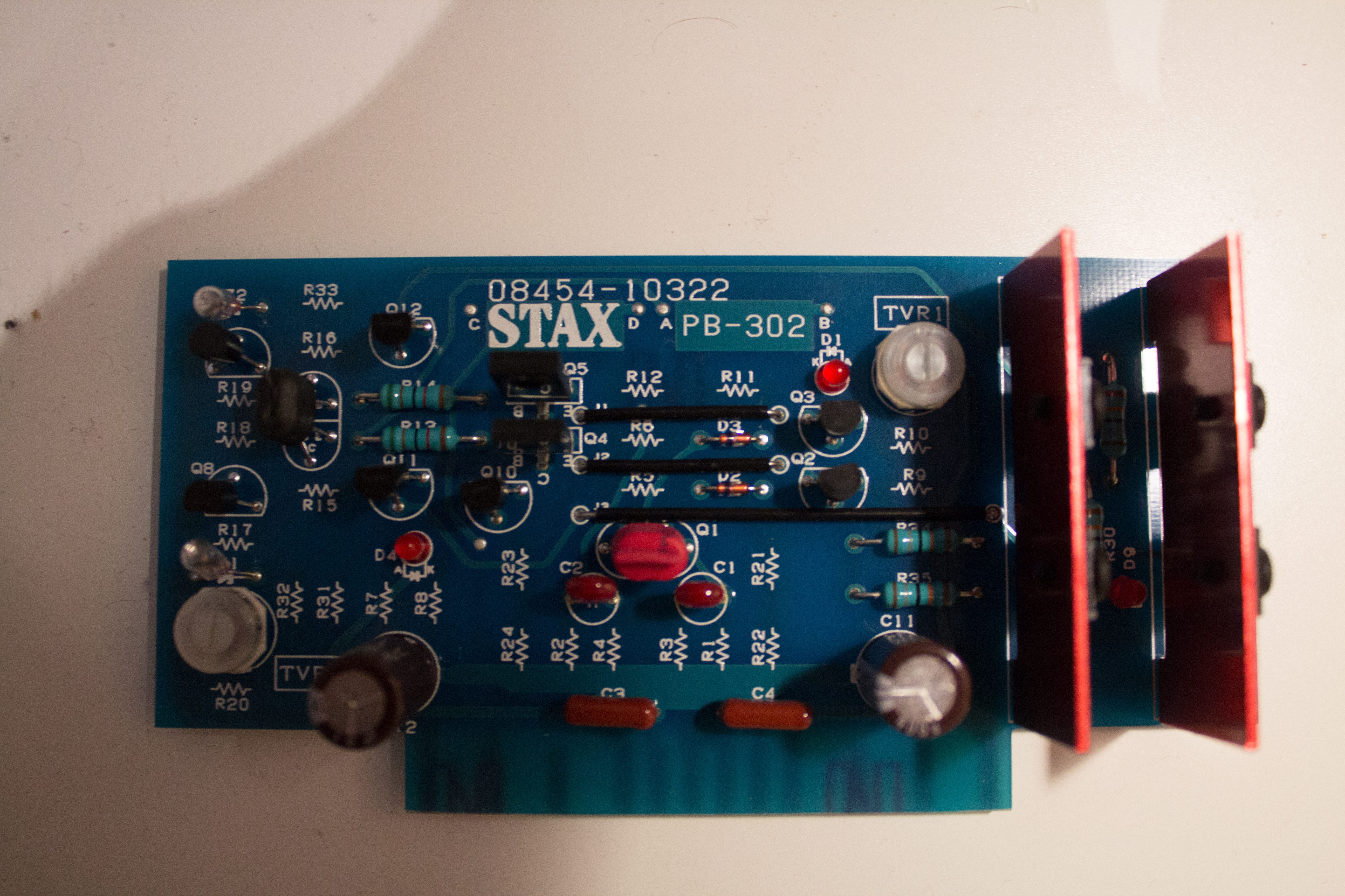

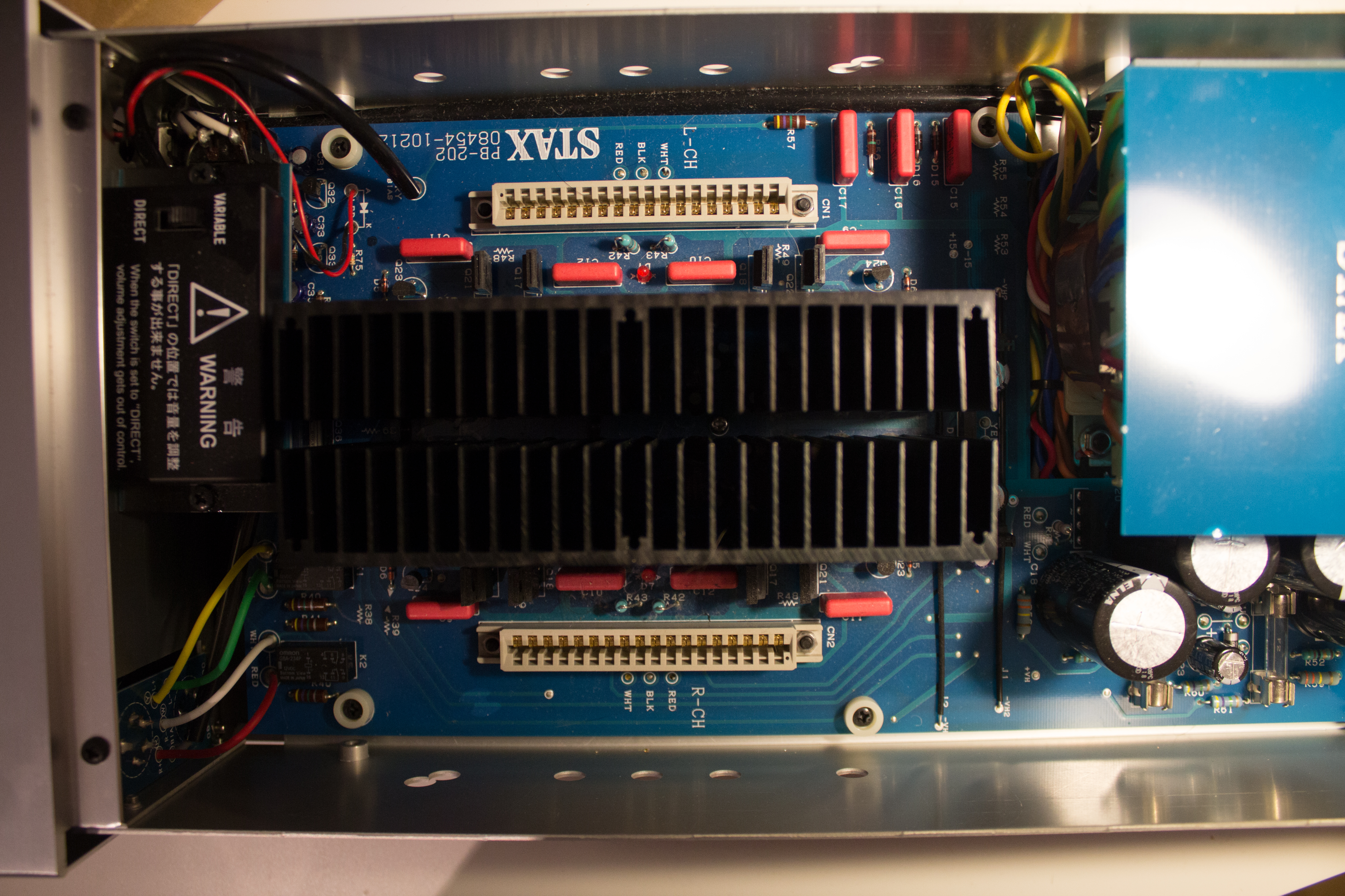

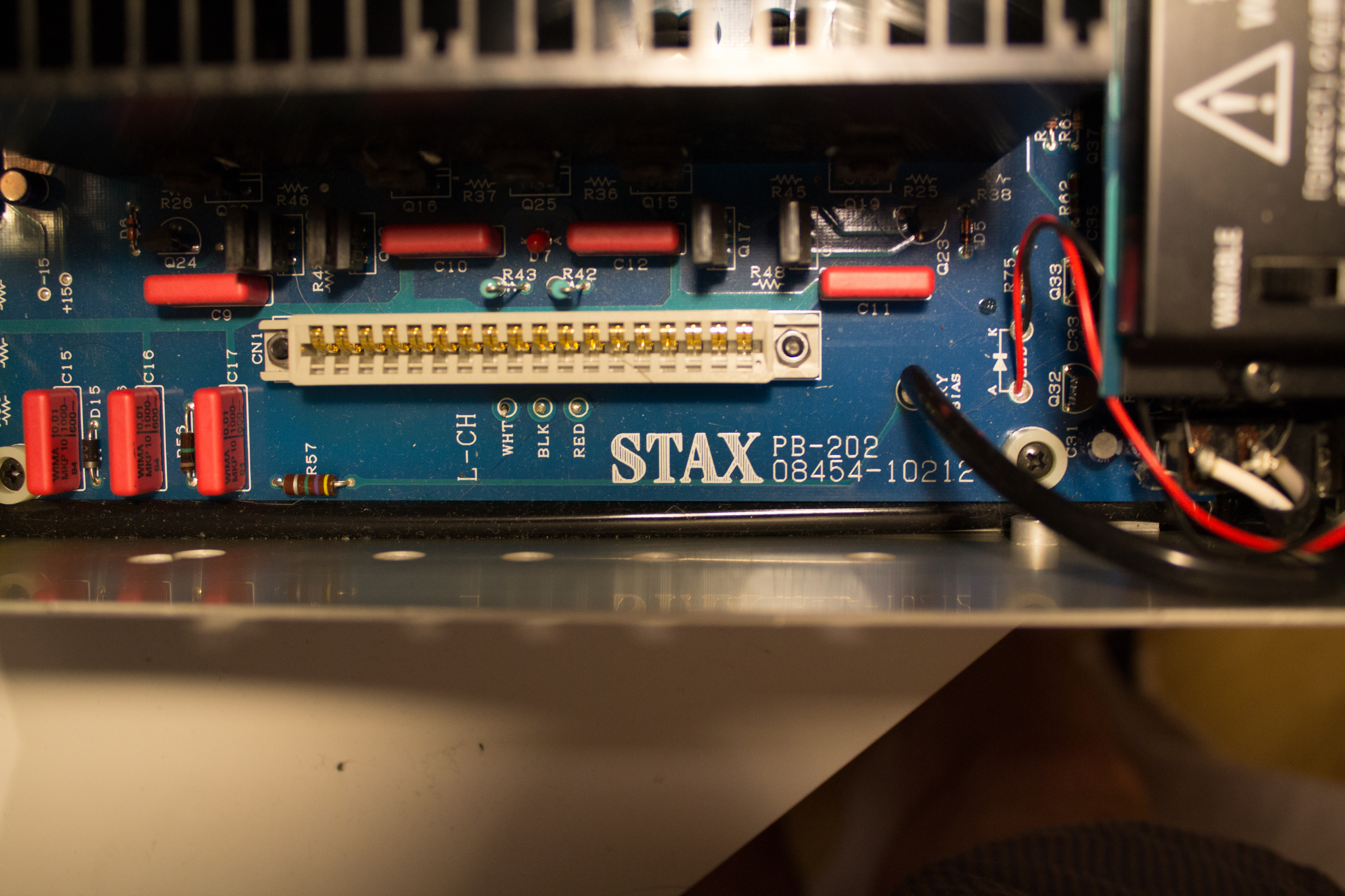

charlo89 Posted May 1, 2016 Report Posted May 1, 2016 I think I will mod my 727A. I open the amp but my board are a bit different, I think it's only aesthetic. On Spritzer's picture, the boards are flocked "PB-301" on mine it's "PB-302" is there any difference ? Quote
spritzer Posted May 1, 2016 Report Posted May 1, 2016 I didn't know there was a new version of the amp boards so can you post some pics? Quote
charlo89 Posted May 1, 2016 Report Posted May 1, 2016 (edited) The main board changed too. EDIT: here is the 301 picture found on Head-fi, no more C41 C42 C44 C45 and some strange cables on the 302 Edited May 1, 2016 by charlo89 Quote
spritzer Posted May 1, 2016 Report Posted May 1, 2016 Hmm why on earth are they using jumpers on a double sided board? Seriously!! The feedback is still identical though. Two 150K resistors in series so just remove the bottom one and connect the new resistor between the top pad and the empty socket connection. Quote

charlo89 Posted May 5, 2016 Report Posted May 5, 2016 (edited) I forgot to thank you. I don't have 150k resistance in stock, anyway I need to order some components from mouser, I will do the mod on my return from vacation. Do you have any idea why the amp has a second version ? Edited May 5, 2016 by charlo89 Quote
spritzer Posted May 5, 2016 Report Posted May 5, 2016 Who knows why Stax swapped it out. Might be some part issues as the amps are filled with out of production transistors. Quote

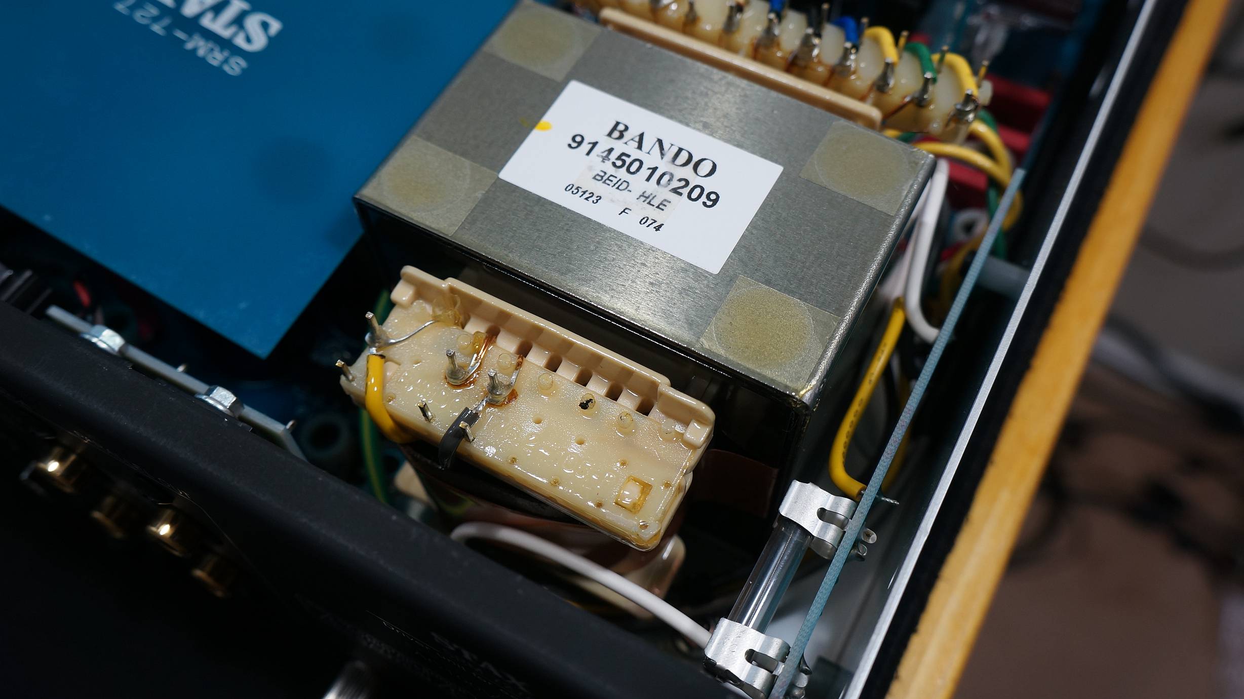

Arthrimus Posted June 17, 2016 Report Posted June 17, 2016 So how violently will an SRM-727a explode if I were to plug it into my healthy 123V USA outlet? Stax is getting really mean these days, my newly acquired 727a is the same revision as charlo89's and the transformer doesn't even have the 120V windings cut anymore, they simply are not even there on this new transformer. I have a step down transformer on order but I'm impatient and foolish. What's the damage if I do it? Quote
wink Posted June 17, 2016 Report Posted June 17, 2016 Don't do it, just don't......! Even if you get away with it this time, it may embolden you to try it when the consequences may be considerably more severe. Good practice and habits should never be sacrificed on the altar of expedience, unless you know what you're doing or you don't mind the fallout. Quote
spritzer Posted June 17, 2016 Report Posted June 17, 2016 Blown capacitors, blown transistors and other nice things... Quote
