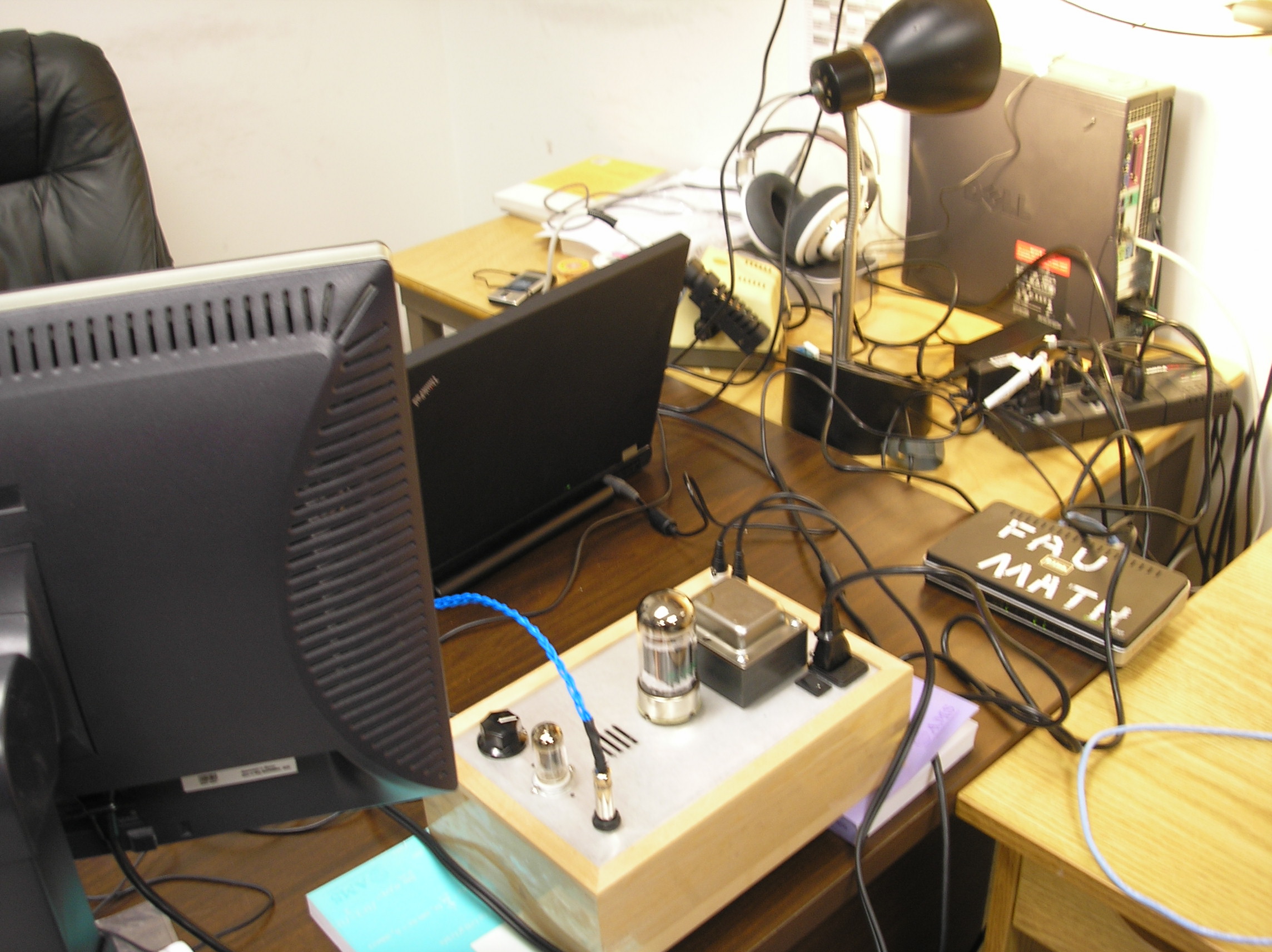

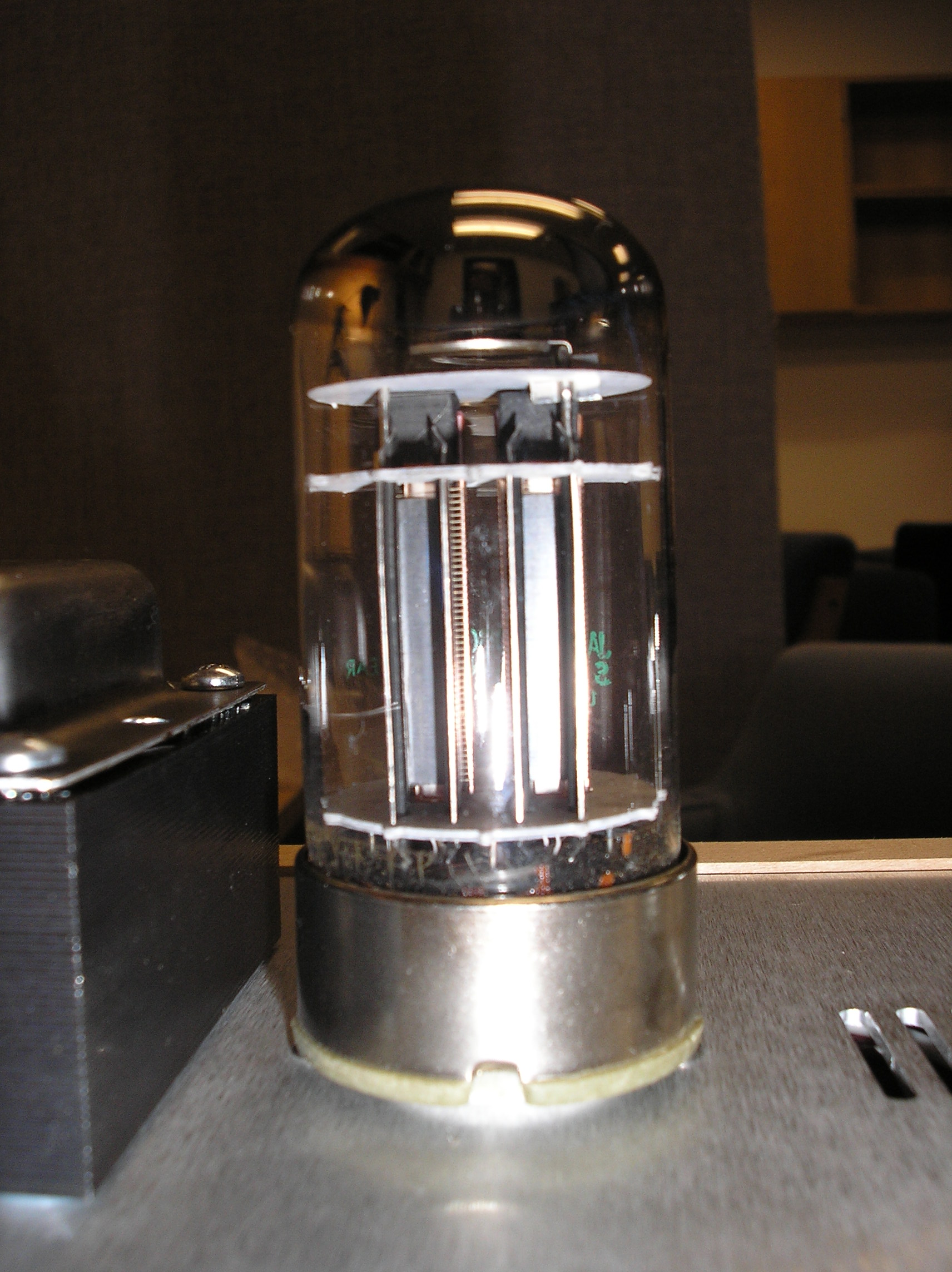

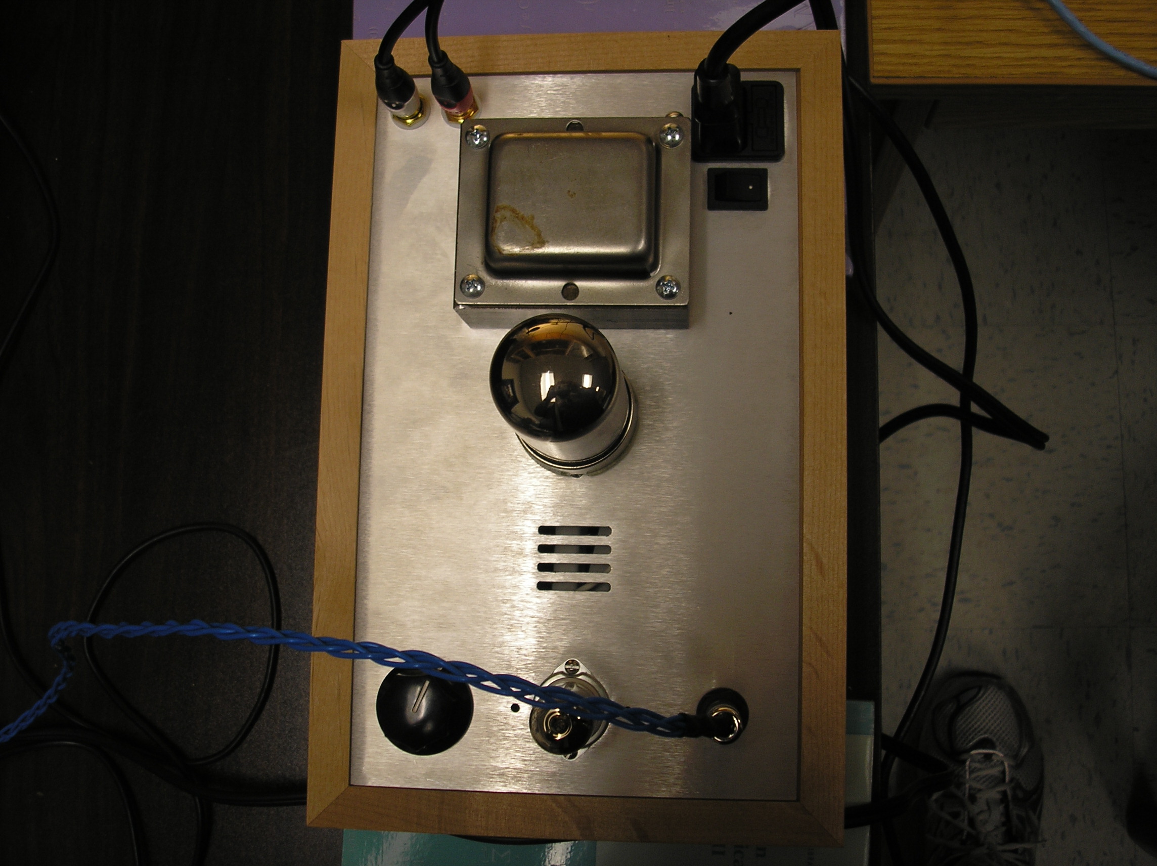

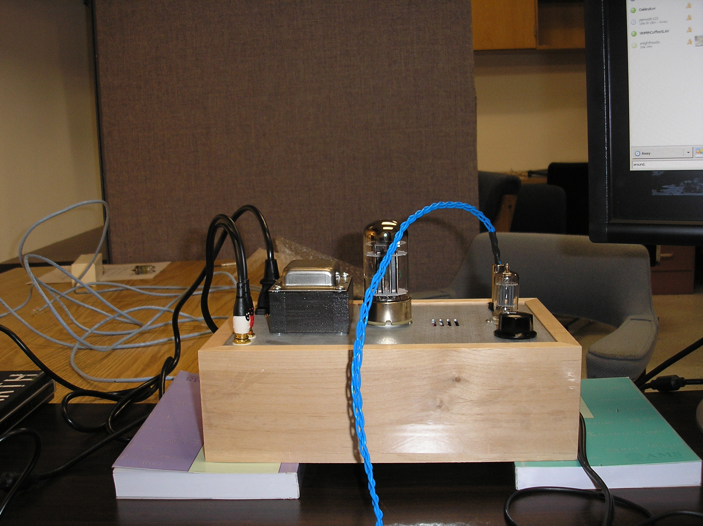

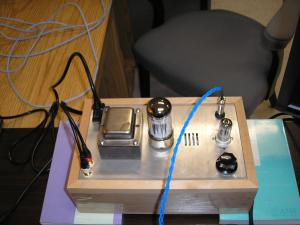

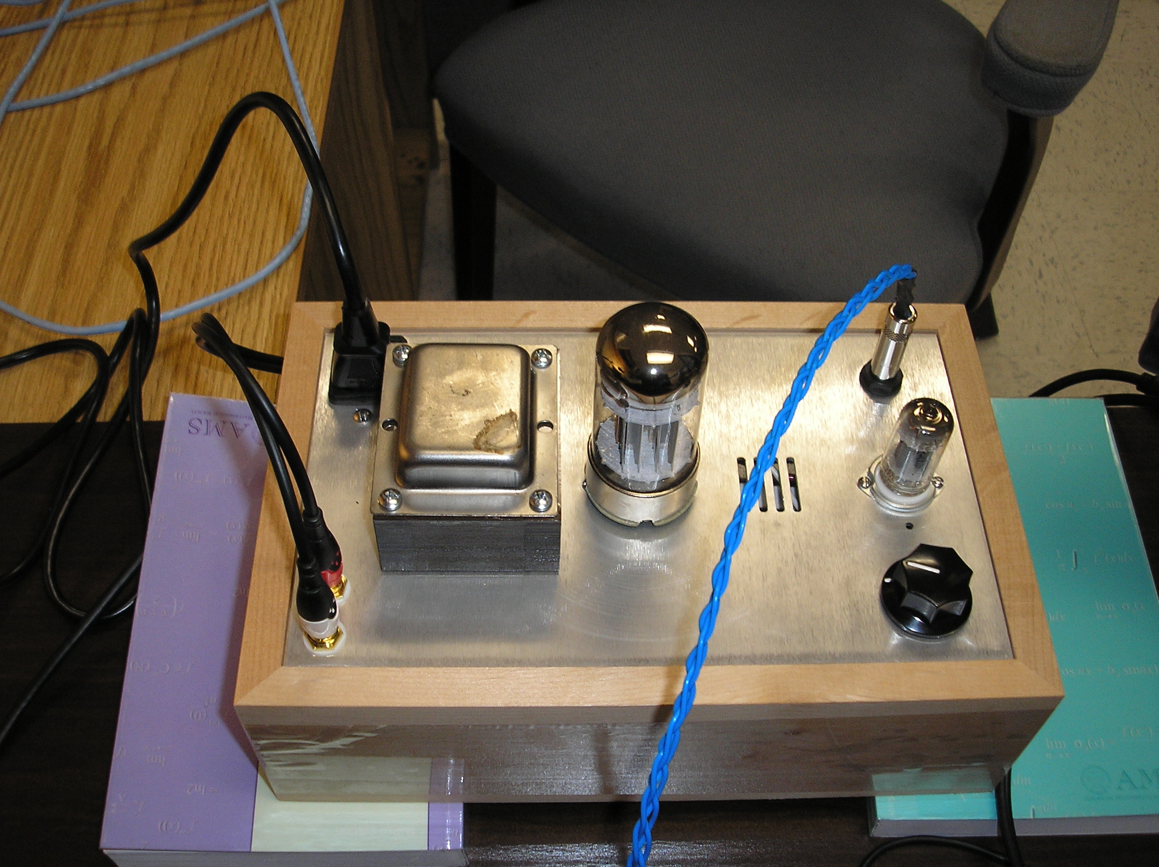

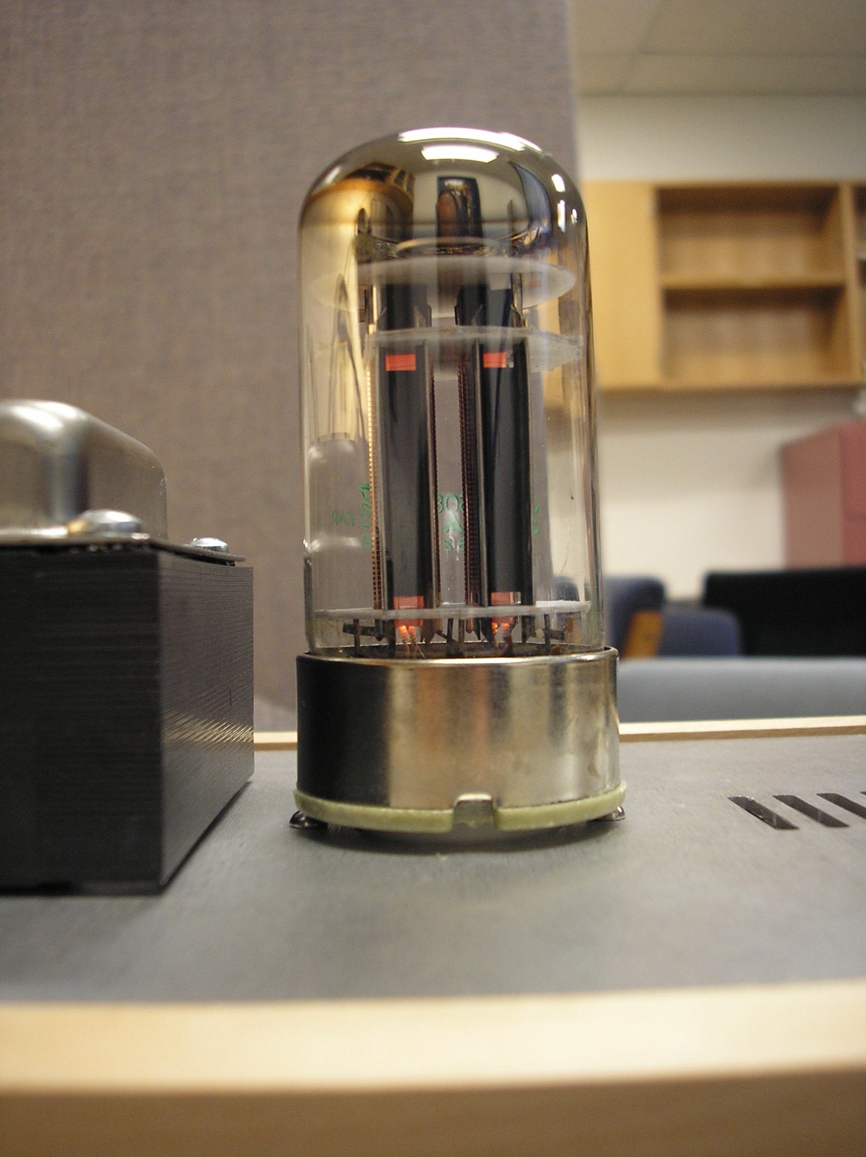

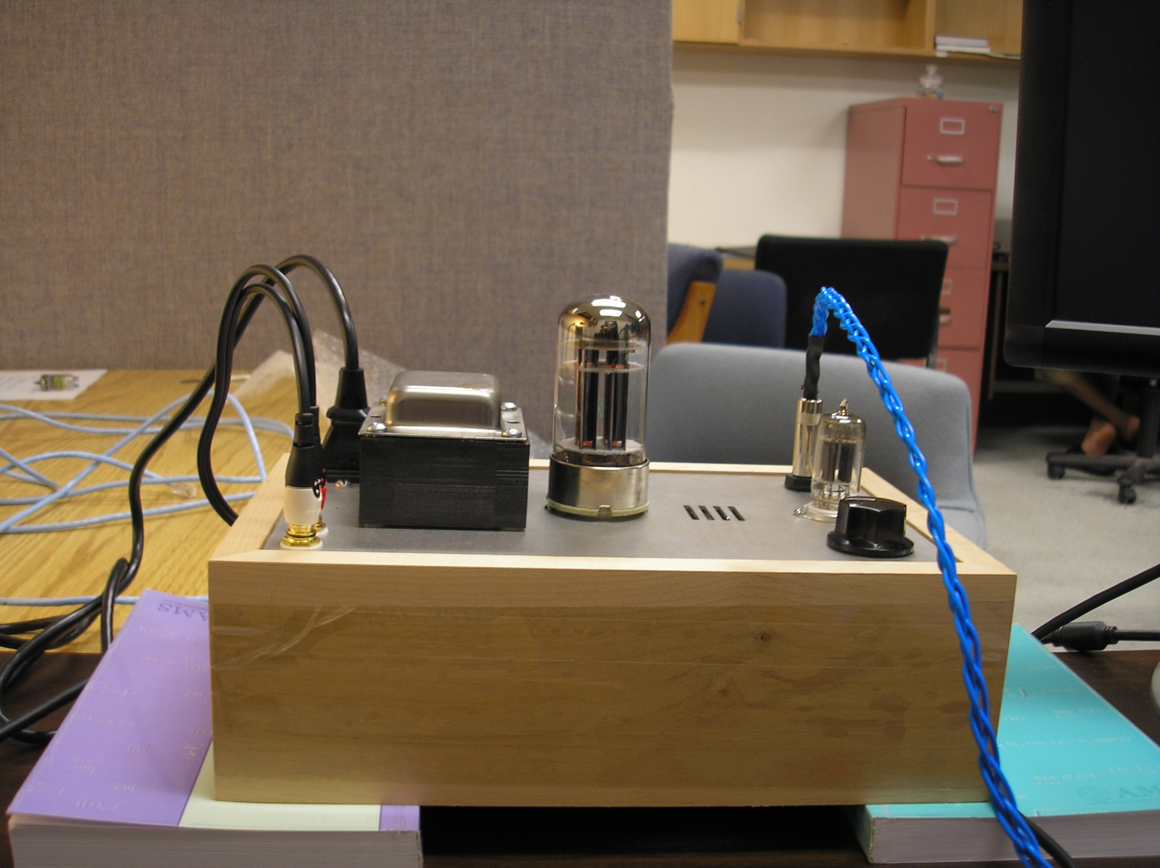

crappyjones123 Posted August 28, 2010 Report Posted August 28, 2010 unfortunately the leads are all gone. i will end up just buying 2 more (anyone have an extra pair lying around? will pay for parts and shipping obviously. shipping with digikey is more expensive than the parts themselves...). i am more scared of having done damage to the board as i am sure that will be a much more expensive replacement if required. here are some pics. upskirt ones later when i turn off the amp but as of right now the toones are playing so dont want to turn it off sounds mighty nice.[ATTACH=CONFIG]3572[/ATTACH][ATTACH=CONFIG]3569[/ATTACH][ATTACH=CONFIG]3566[/ATTACH][ATTACH=CONFIG]3573[/ATTACH][ATTACH=CONFIG]3567[/ATTACH][ATTACH=CONFIG]3574[/ATTACH][ATTACH=CONFIG]3568[/ATTACH][ATTACH=CONFIG]3565[/ATTACH] Quote
