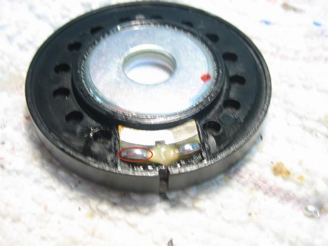

peculiarism Posted July 31, 2010 Author Report Posted July 31, 2010 I tried to take some photos of the solder tab and driver, but the tab is so small (only a few mm), that the photos are too blury to make out. Instead i searched online for a picture of the same driver, only in this photo of course the tab is still attached. It is also covered in solder and you cant really see the tab itself. There is a solder pad above the one i removed, this one is about double the size of the lower tabs. I think i probably applied too much heat, but what can i do now??? [ATTACH=CONFIG]3410[/ATTACH] Quote
naamanf Posted July 31, 2010 Report Posted July 31, 2010 Can you still see the voice coil wire that goes to the tab? Quote
peculiarism Posted July 31, 2010 Author Report Posted July 31, 2010 voice coil wire? There is nothing where the tab used to be, just a flat, black surface - no wires, holes or anything... It is only the bottom left tab that has come off... are they irrepairable? Quote
naamanf Posted July 31, 2010 Report Posted July 31, 2010 voice coil wire? There is nothing where the tab used to be, just a flat, black surface - no wires, holes or anything... It is only the bottom left tab that has come off... are they irrepairable? Well not sure about the particular driver but where the tab is/was should have also been where the voice coil wire attached. It's probably very small and hard to see. If the tab came off because of to much heat it might have melted into the plastic underneath. If you can find it and there is enough left to solder to you could solder your cable directly to it. Quote
