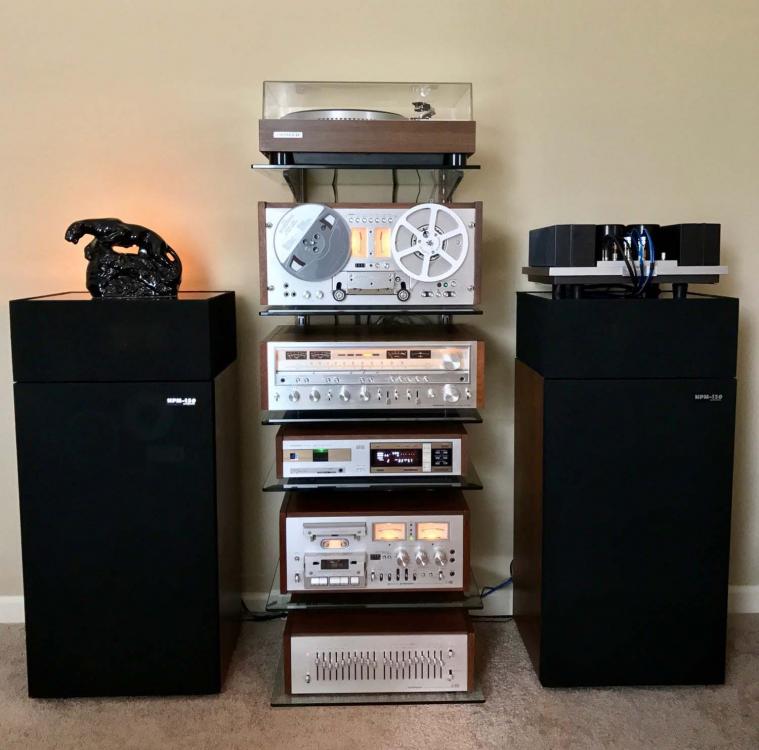

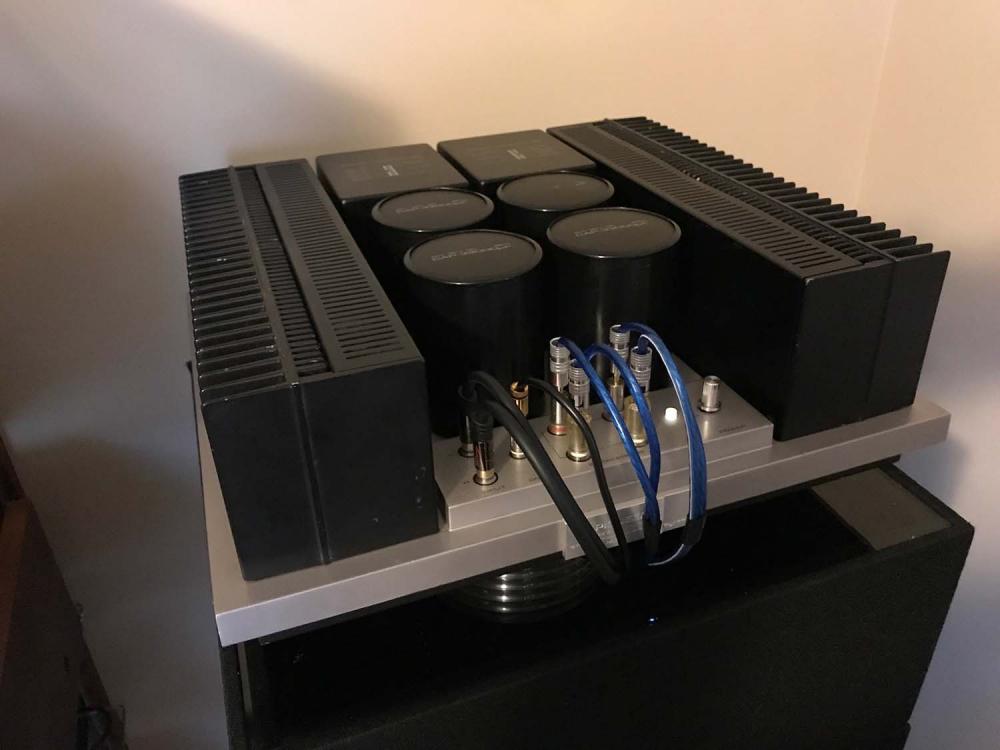

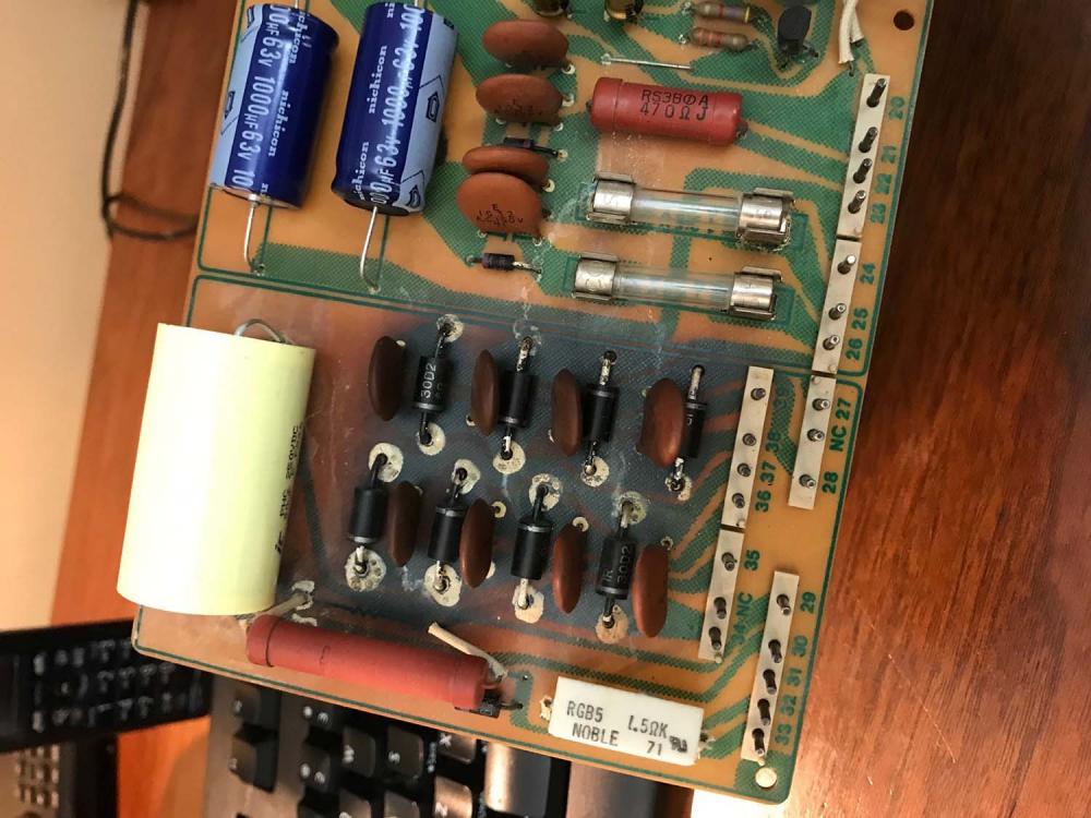

darkhawk22 Posted July 7, 2017 Report Posted July 7, 2017 Thanks for all the great info. in the previous comments. I just purchased an M-22 a short while ago and did a fairly extensive rebuild myself. I replaced all the Electrolytic Caps and burnished the contacts on all the relays. During the process I accidentally popped/shorted one of the output transistors and had to source a replacement. Once I got the replacement, I re-seated all the main transistors and added new thermal compound and adjusted the idle current and output. The power section of one of the boards gets quite hot so I replaced the Diodes and Ceramic caps there leaving additional space for air flow. Lastly, I added larger rubber mounting feet for air flow and cable routing. 4 Quote
swt61 Posted July 7, 2017 Report Posted July 7, 2017 Very nice addition to a retro-cool system. I would think that a little more spread on those speakers would be an improvement in stereo imaging though. 2 Quote
mwl168 Posted July 7, 2017 Report Posted July 7, 2017 5 hours ago, swt61 said: Very nice addition to a retro-cool system. I would think that a little more spread on those speakers would be an improvement in stereo imaging though. And maybe move the speakers a few feet away from the back wall too if possible. 2 Quote
