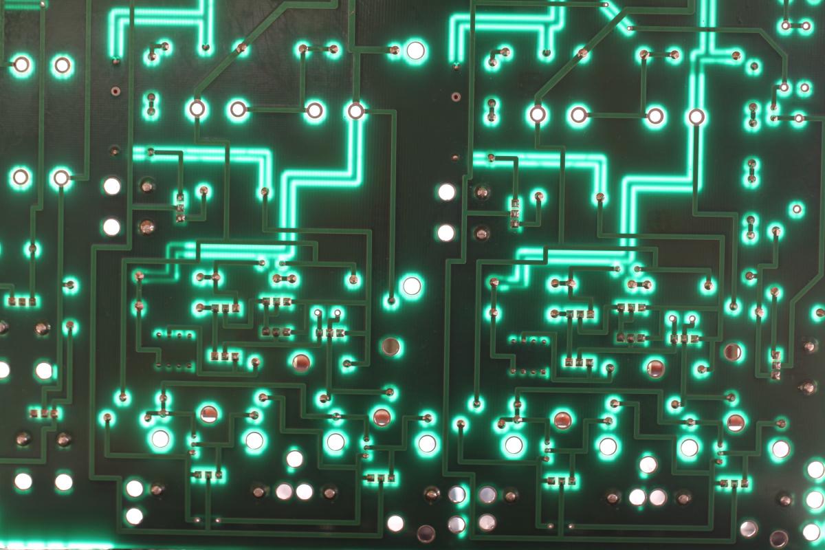

Inu Posted November 30, 2012 Report Posted November 30, 2012 (edited) I think arced between resistor and GND pattern... Edited December 1, 2012 by Inu Quote

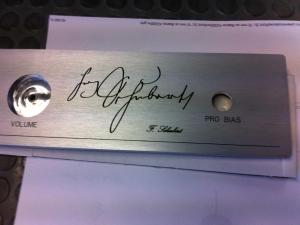

schubert Posted December 22, 2012 Report Posted December 22, 2012 Here is the front of my future "F.Schubert KGSShv" project : Quote
livewire Posted December 23, 2012 Report Posted December 23, 2012 Uh, what says the script in the middle? Quote
jwzhan Posted December 23, 2012 Report Posted December 23, 2012 (edited) I believe that's Franz Schubert's signature... Edited December 23, 2012 by jwzhan Quote

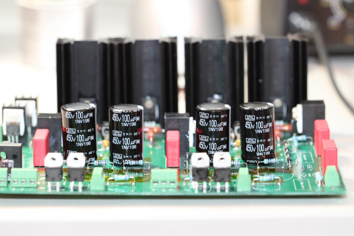

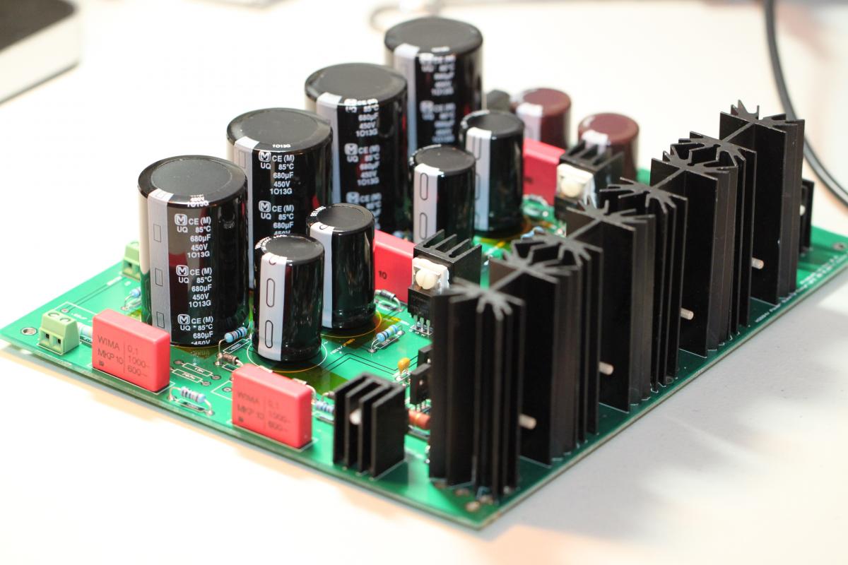

eggil Posted December 24, 2012 Report Posted December 24, 2012 (edited) Well, the power supply for my second KGSShv powered up without a hitch : -15,+15, -504, +504 I am using the IXYS parts. Edited December 24, 2012 by eggil Quote
Victor Chew Posted December 24, 2012 Report Posted December 24, 2012 (edited) Nice work and pictures Enrique. The 580v bias measures ok as well? Edited December 24, 2012 by Victor Chew Quote
jwzhan Posted December 24, 2012 Report Posted December 24, 2012 Very nice indeed, especially those Kapton. Who doesn't like the look of orange colored tape on high end audio equipments! Quote
eggil Posted December 24, 2012 Report Posted December 24, 2012 (edited) Actually, after your horror story I decided to go ahead and use it. Not pretty, but nobody is going to open the hood after is done. Victor, I was too sleepy to play with high voltage last night and stopped before measuring bias. I will tonight. EDIT: Bias measures at 580V and then slowly drifts upwards to 587 V and stays there. I figure that would not damage the stators but I am not sure. Edited December 25, 2012 by eggil Quote
