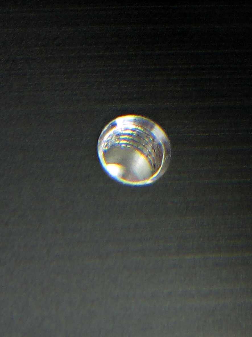

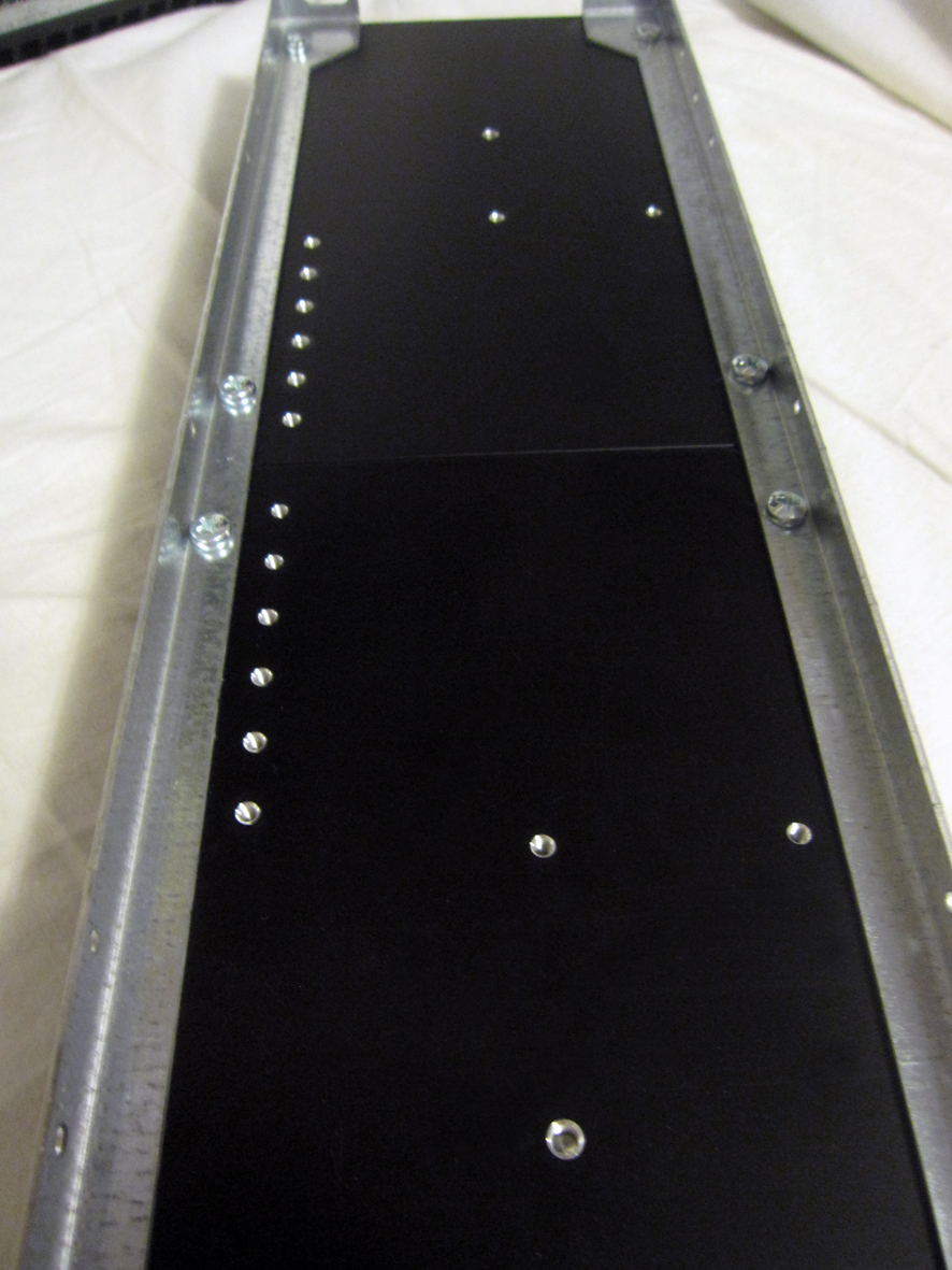

cobra_kai Posted December 8, 2011 Report Posted December 8, 2011 (edited) Well got mine up and running tonight! I would have had it working last week but I had some khozmo related misfortune. I take back any good thing I said about them - check out this picture of my attenuator and tell me what's wrong... Long story short when I was tracking down why I was only getting sound out of one channel I must have knocked something loose and I managed to fry both boards. I replaced all the semis in both channels other than the CCS which were still working correctly. Now it's back up and adjusted - got balance under a half volt on both channels but the left channel I couldn't get under 2V offset, which I figured wasn't a big deal. Here are some quick pics: I'm listening to it now on O2 mk1s and all I have to say is wow! Definitely a big step up from the SRD7 Edited December 8, 2011 by cobra_kai
Lil Knight Posted December 8, 2011 Report Posted December 8, 2011 Fugly! Good to see it works. Now if only someone could get Dynafet up and running too
cobra_kai Posted December 8, 2011 Report Posted December 8, 2011 What you don't like silver? It matches my Beta 22/Alpha 10 stack. I have to do a bit more wire management and the leds backlighting the volume knob aren't quite the right shade of blue so I need to try some others. Oh and if khozmo ever gets me 2 caddocks to put in the missing spot I will put those in (right now I put in some vishay dale RN series). Next up: the T2
