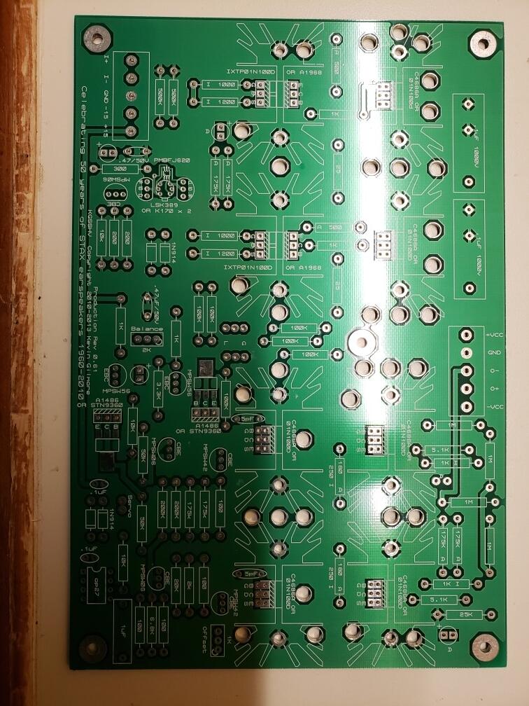

bajjisw Posted March 3, 2020 Report Share Posted March 3, 2020 Here are the pictures. They had to be resized to fit here. The power supply says production rev 0.9 The amp board says production rev 0.61 Quote Link to comment Share on other sites More sharing options...
JoaMat Posted March 3, 2020 Report Share Posted March 3, 2020 Here are some files, the best I could find. kgsshvproductiondualmot.PDF kgsshvps8g.PDF kgsshvBOM.xlsx The BOM has to be reworked with the components you want to use. Some might be harder to find. Take look and see if this is useful. 1 Quote Link to comment Share on other sites More sharing options...

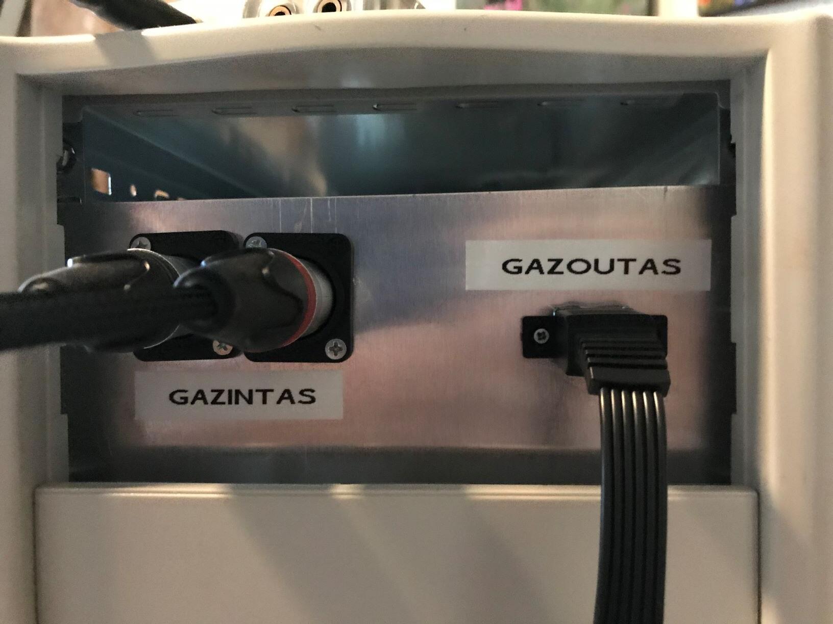

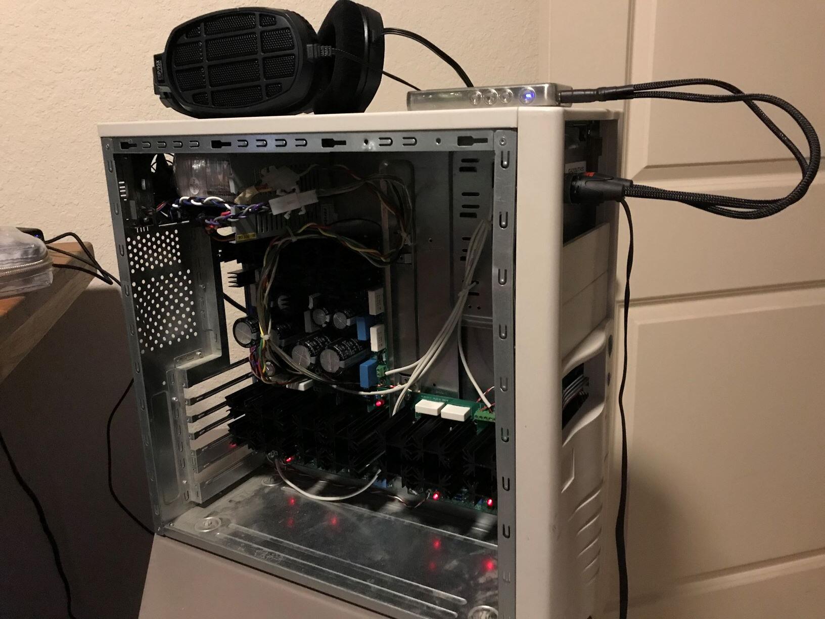

DanFan Posted March 27, 2020 Report Share Posted March 27, 2020 Here's my KGSSHV build to offset all the fantastic, professional-looking ones posted in this thread (milling your own front plate?!). I had an old computer case lying around, so used that as the chassis. Thanks a lot to Spritzer. I started with his kit and BOM, and then exchanged about a hundred emails with him. I lowered the values of the pull-down resistors on the amp boards to eliminate hum. Other than that, the thing worked the first time. The player is a HiBy R6Pro, and I'm listening with Koss ESP/95X phones from Massdrop. 13 Quote Link to comment Share on other sites More sharing options...

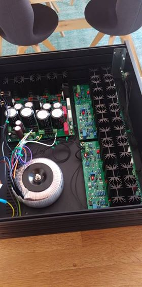

bwck2000 Posted April 28, 2020 Report Share Posted April 28, 2020 I managed to get my kgsshv project done without creating some big mess and spark, and I want to thank KG for his design , Birgir and many member here for their generous contributions. oyaide L/i50 OFC is used as umbilical cords but is not shown here. later on a L/R balance control will be installed. The power and the amplifying section is about the same size so they can be stacked together. The heat sink size is less than ideal and it runs so hot that I can barely touch. My IR thermometer reads 47 oc but I think it is inaccurate due to the shiny appearance of the heatsink. But then I think at least these heat sinks are bigger than those on-board ones so this should not be a problem. Two stax plug are installed becoz I have dozens of them taken apart from stax extension cords. There are some small issues during startup. The power supply board had some sparking on the bias section becoz some paint is off and probably there are some small filament peeled off from the leg of the 1n4007. It needs some epoxy to cover up the arcing spot. There is also something with the amp board. At first there is no sound, balance sits at 700v and two burnt 50k resistor on each board next to the stn9360. It turns out that I installed some mpsa06 instead. Luckily it fires up after replacement. The first second it plays it blows 717 away. Big soundstage , great dynamic and details. Pretty much no complain and is hard to beat except that vocal can be more engaging. Drives omega, es1a and 007 equally well. I think it somehow sounds sweeter than the carbon I built long thime ago. 6 Quote Link to comment Share on other sites More sharing options...
