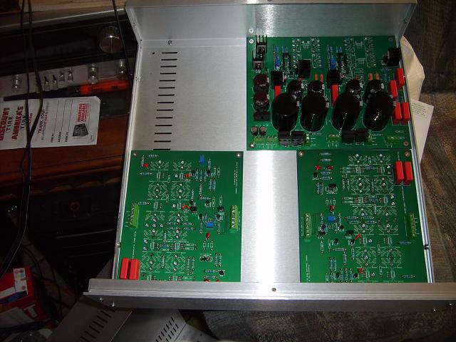

livewire Posted December 8, 2010 Report Share Posted December 8, 2010 Mine is coming together, the boards just fit inside the case. (Par-Metal 20-16164) Waiting for the trafo to get here to finish the build. (mouse-over or click to enlarge) [ATTACH=CONFIG]4017[/ATTACH] Quote Link to comment Share on other sites More sharing options...
spritzer Posted December 8, 2010 Report Share Posted December 8, 2010 Looking at that pic I'm glad I asked Kevin to add those extra holes for the smaller 100nf caps. Ohh and that case is really on the tight fitting side of things... Quote Link to comment Share on other sites More sharing options...
livewire Posted December 8, 2010 Report Share Posted December 8, 2010 Looking at that pic I'm glad I asked Kevin to add those extra holes for the smaller 100nf caps. Ohh and that case is really on the tight fitting side of things... Yes it is, but it should work out just fine. When I ordered the enclosure (and didnt have the boards yet) I thought that I might have to overlap the boards a little bit, using different height standoffs. Turns out that wont be necessary. I really like the placement of the vent slots, right above and below and to the sides of the major heatsinks. Should aid in helping the "chimney effect" venting. Quote Link to comment Share on other sites More sharing options...

Lil' Knight Posted December 9, 2010 Report Share Posted December 9, 2010 Mine is coming together, the boards just fit inside the case. (Par-Metal 20-16164) How many vent columns at the bottom does your case has? I'm asking because from what I saw on the drawing on their website, it should have 4 like the top, no? Quote Link to comment Share on other sites More sharing options...

livewire Posted December 9, 2010 Report Share Posted December 9, 2010 How many vent columns at the bottom does your case has? I'm asking because from what I saw on the drawing on their website, it should have 4 like the top, no? Mine has four on top, two on the bottom, one on each side. See the pic that I posted above. Hmmmm? Maybe I've got a defective case? I'm not gonna lose any sleep over it, the top ones are the most important for venting the heat. It is good to have them along the sides and bottom to pull cool air in. If you've noticed, the boards have vent holes in them too to aid with drawing fresh air up from the bottom, past the fins of the heatsinks. Nice touch. ::two thumbs way up!:: Quote Link to comment Share on other sites More sharing options...
