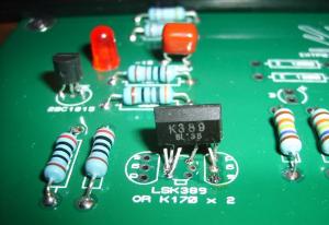

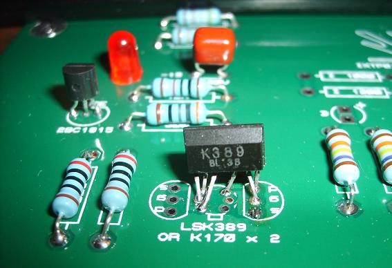

MASantos Posted December 6, 2010 Report Posted December 6, 2010 They look legit, but the amp PCB is not set up for these; it is set up for the Linear Systems version in the TO-71 package, or pairs of 2SK170 singles. http://www.linearsystems.com/datasheets/LSK389.pdf Is there any way to bend the pins to fit the pcb? The 2sk170 with the little heatsinks could be much better matched tough with enough quantities and patience. Quote
spritzer Posted December 6, 2010 Report Posted December 6, 2010 You might be able to bend the 2SK pins to fit but the LSK389 is reasonably easy to find. Quote

livewire Posted December 7, 2010 Report Posted December 7, 2010 You might be able to bend the 2SK pins to fit but the LSK389 is reasonably easy to find. Yes you can, I've done it. Very difficult to do, I dont recommend it. (mouse-over or click pic to enlarge) Get the LSK389 with a top hat heatsink. Much more purdy![ATTACH=CONFIG]4002[/ATTACH] Quote
