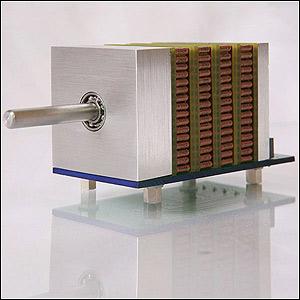

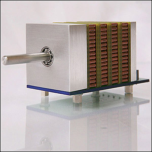

wink Posted September 23, 2010 Report Posted September 23, 2010 My Khozmo showed up yesterday. ordered last month. The steps are more firm amd pronounced than the DACT. [ATTACH=CONFIG]3711[/ATTACH] Quote

wink Posted September 23, 2010 Report Posted September 23, 2010 parts connexion now carry khozmo attenuators, but they don't carry the 50k quad. https://www.partsconnexion.com/conrtols_attenuator_khozmo.html Quote
