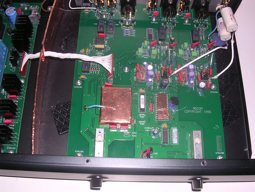

DefectiveAudioComponent Posted April 8, 2010 Report Posted April 8, 2010 I need to get a new DAC after damaging my E-MU 0404 USB dac. There are nice new (used) DACs out there for about 200 euro, the E-MU, the V-DAC, and the cambridge audio DAC magic. But there are also vintage DACs, like this ADCOM 700 (that someone seems to have done some strange mods to) [ATTACH=CONFIG]2965[/ATTACH] or the Parasound D/AC 1000, or this Orelle DAC [ATTACH=CONFIG]2964[/ATTACH] What do you people think? Should I go vintage or almost new? Quote

Pars Posted April 8, 2010 Report Posted April 8, 2010 For the Adcom, the film caps with long leads is pretty questionable. Better to use a DC coupled discrete stage instead of mucking with opamps and coupling caps. The copper tape shielding is fine, and does appear to be grounded. No idea on the other DAC. Quote
cetoole Posted April 8, 2010 Report Posted April 8, 2010 Agreed, and even if you stick with opamps, I see no reason why there is the need for the big flying coupling caps. PCM1702 has output around 0v, dual rail opamp supply, so opamp output should be around 0v (minus various tolerances). If it is too far off, it is easy enough to servo. Quote
spritzer Posted April 8, 2010 Report Posted April 8, 2010 I personally wouldn't touch that Adcom though I must say I like that copper shield between the PSU and the main circuitry. Also replacing all the film caps with Wima's yet leaving out the aging electrolytics... Quote

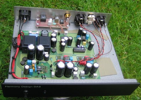

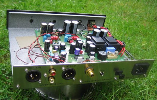

DefectiveAudioComponent Posted April 11, 2010 Author Report Posted April 11, 2010 Older versions (around 2001-2005) of the Harmony Design DA9 would also be close to what I'd like to pay. ( Harmony Design ). (the oldest are cheaper, the newer usually a bit more) Upgrading to the latest version costs about 200 euro so that is not an option (usually cheaper to buy a new one then). (Harmony Design DA9 - DAC [English]) [ATTACH=CONFIG]2978[/ATTACH] [ATTACH=CONFIG]2977[/ATTACH] Quote
