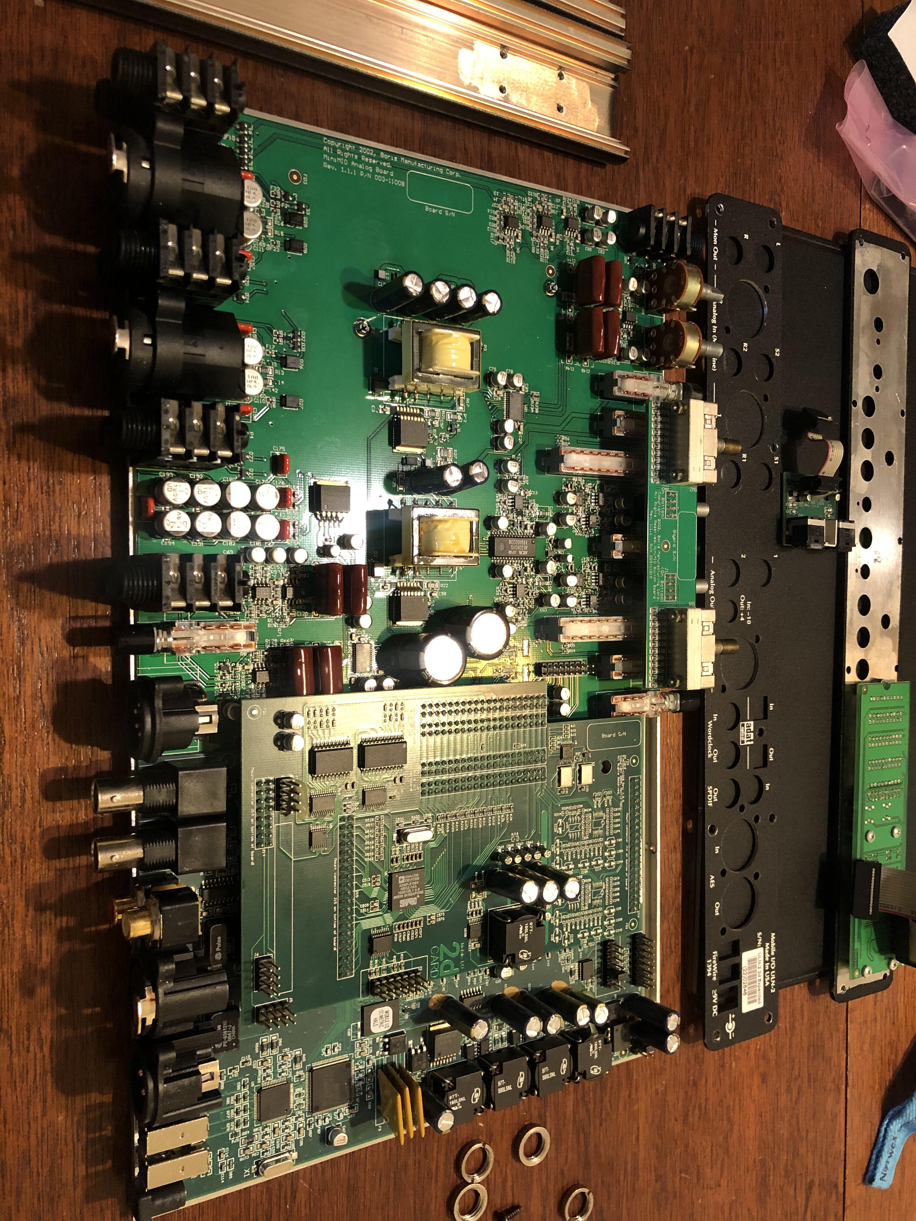

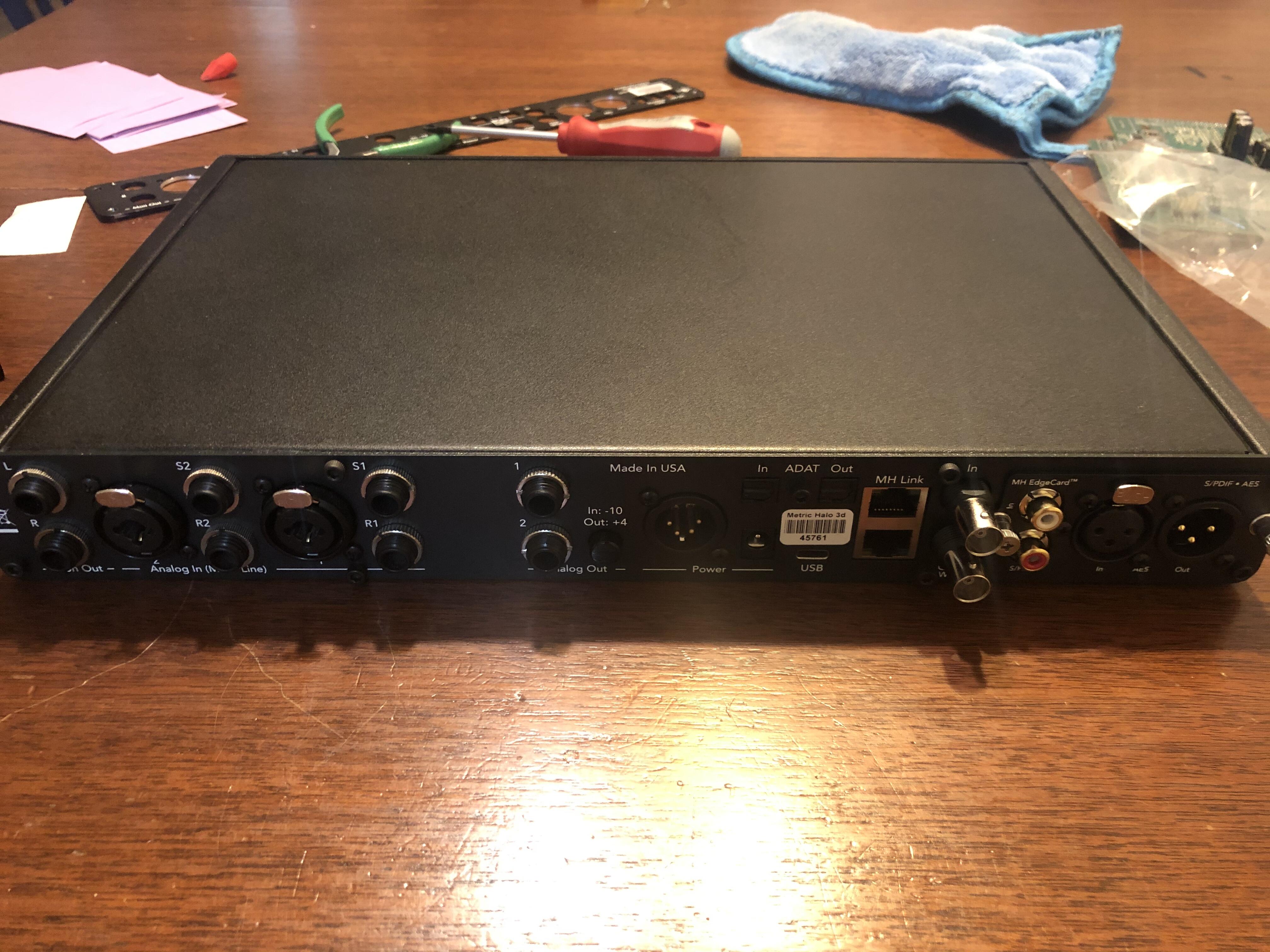

luvdunhill Posted February 21, 2020 Report Share Posted February 21, 2020 Breathed new life into @VPI and @morphsci old unit 4 Quote Link to comment Share on other sites More sharing options...

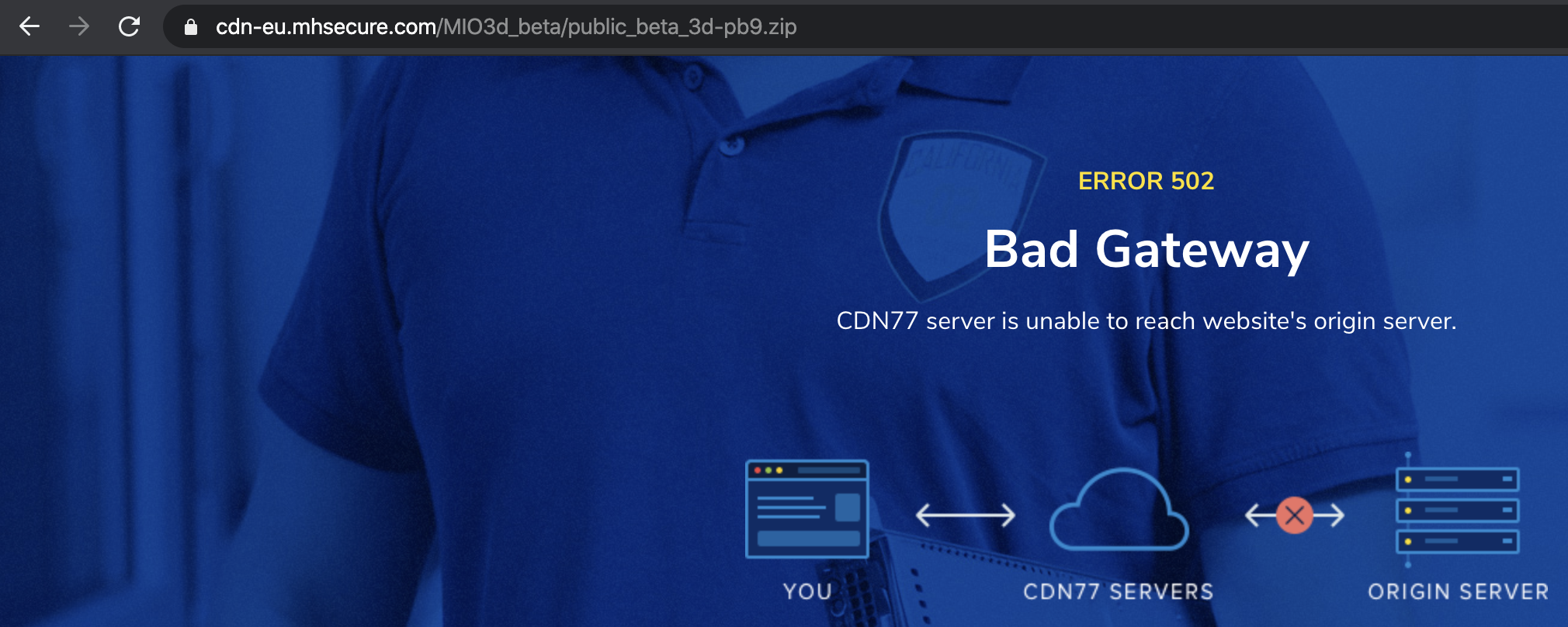

ironbut Posted February 21, 2020 Report Share Posted February 21, 2020 Did you try and install the Mac pb9? https://mhsecure.com/3d_public_beta/ Quote Link to comment Share on other sites More sharing options...
luvdunhill Posted February 21, 2020 Report Share Posted February 21, 2020 11 minutes ago, ironbut said: Did you try and install the Mac pb9? https://mhsecure.com/3d_public_beta/ Yeah, the link is back. I have things working via Ethernet. I'm not sure why I can't get CoreAudio to pop up with the USB interface. It's not even showing up in System Report. Do I need to install a driver? Quote Link to comment Share on other sites More sharing options...
