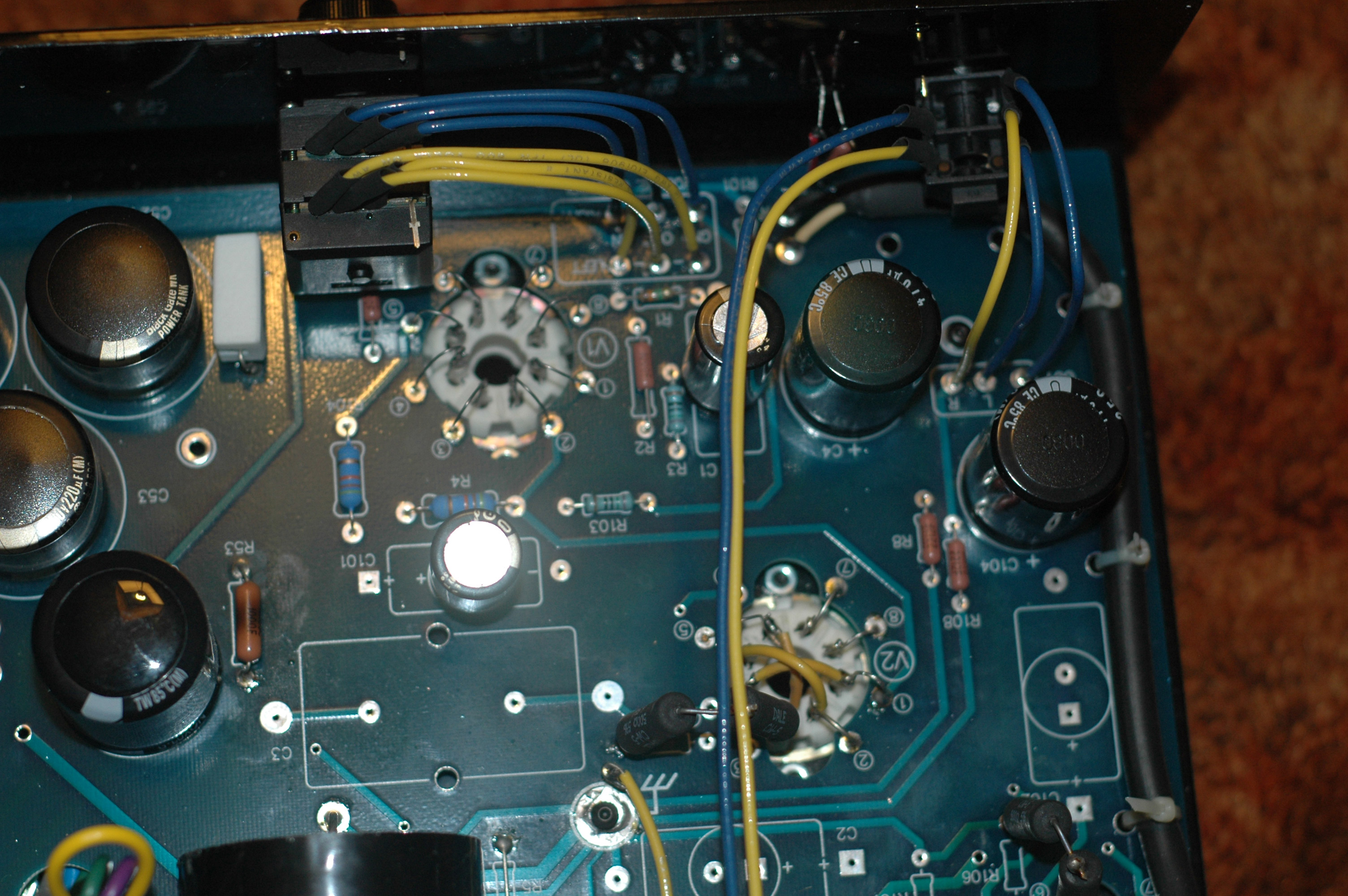

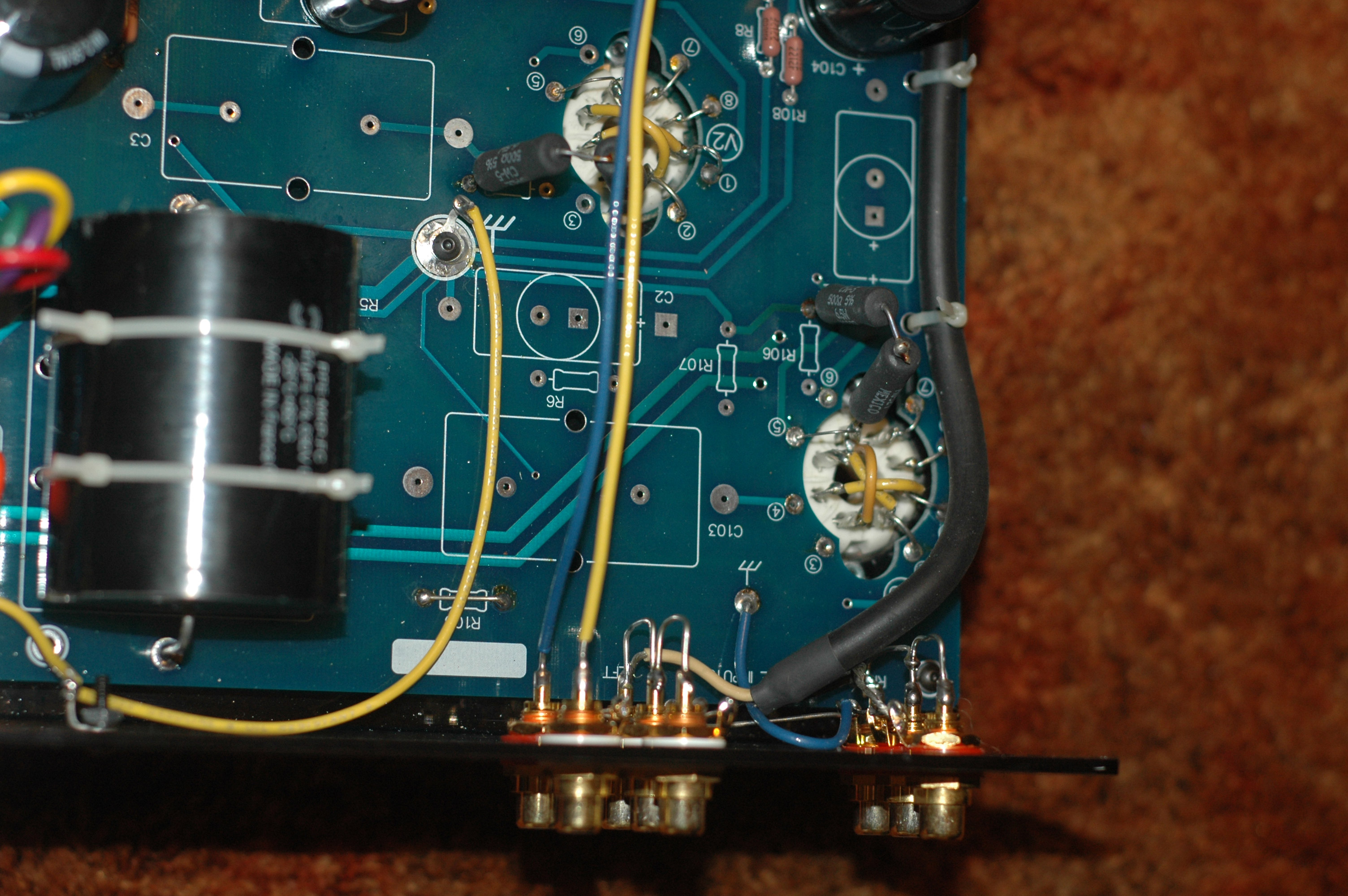

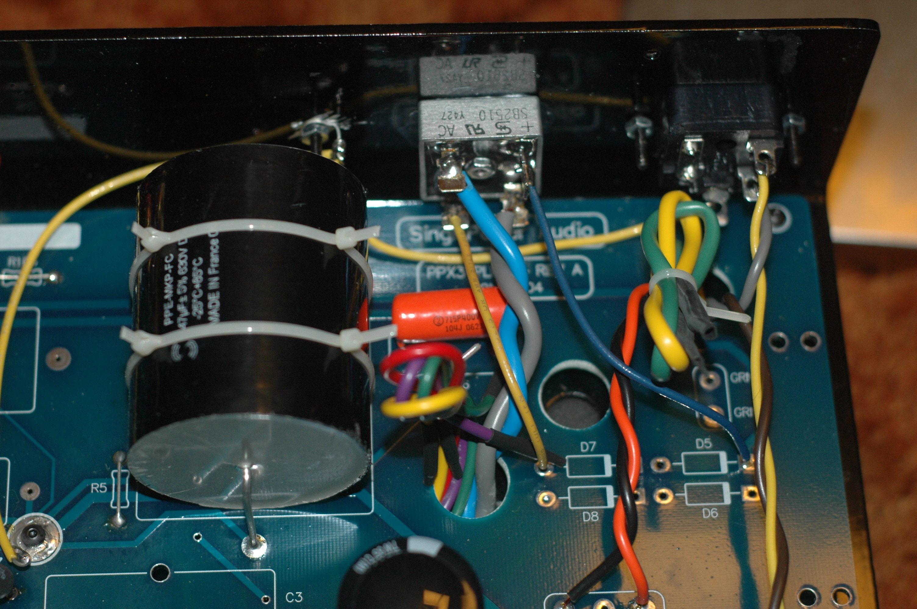

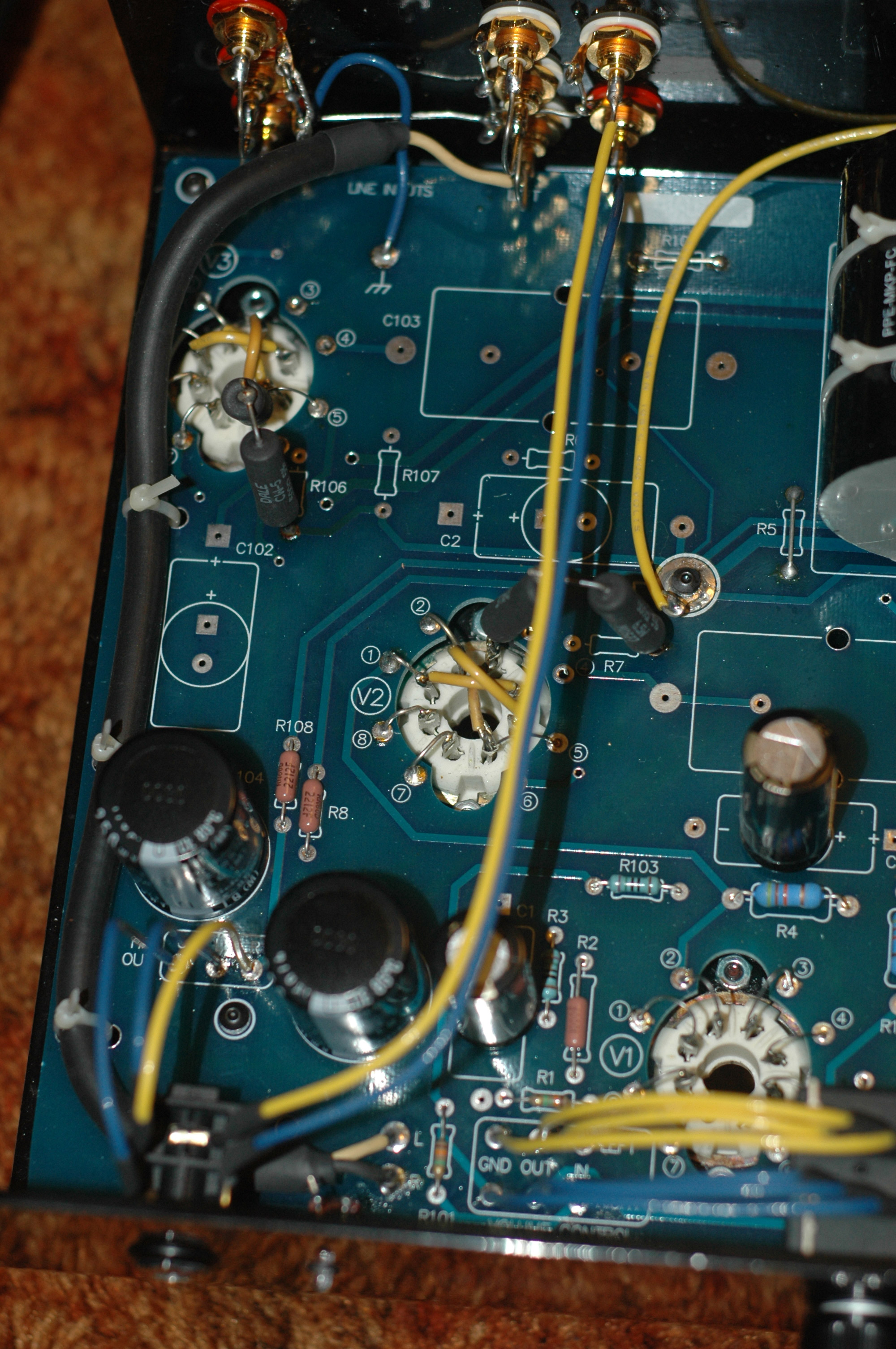

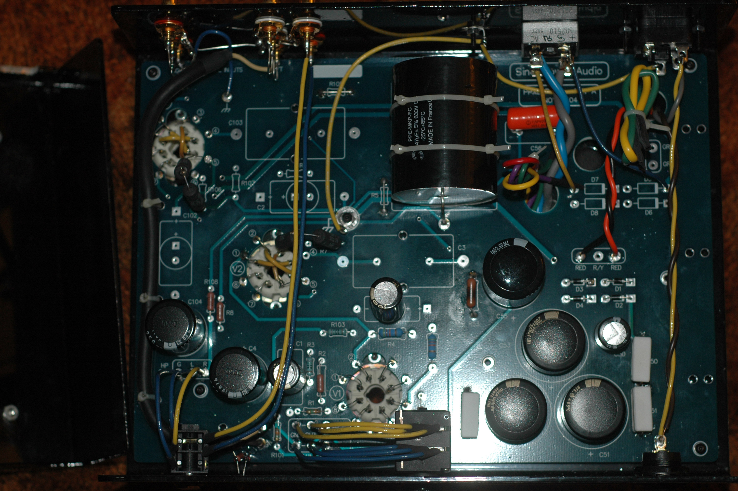

spritzer Posted March 20, 2010 Report Posted March 20, 2010 Open it up and post pics. With SP one never knows what to expect so it could be something simple or very complicated but pics would be the best way to go. Quote
blessingx Posted March 21, 2010 Author Report Posted March 21, 2010 tkam: I hadn't tried a cheater plug, but just did and no luck. spritzer: Attached are a few photos. Could take more, but these were quickies. Nothing looks disconnected, burned out, etc. though not sure if there are problems with the design. That was a gimme in the joke department. If anyone has an ideas I'm be much appreciative. Quote

spritzer Posted March 21, 2010 Report Posted March 21, 2010 Ok, better then most but R53 will not last much longer and might even be way out of spec by now. It's a 100R so any 2W resistor would work there as 1/2W is clearly not enough. The preamp output is taken from the headphone jack but the ground is shared with the input sockets so you might be dealing with a ground loop. They are more likely in the P2P wired amps but certainly possible in these amps since Mikhail never could solder worth shit. If you a 1/4" to RCA cable then you test if it is the ground that is causing the hum. You also have no input selector so the inputs are all connected together. You need a 3P4T switch for that which is dirt cheap and simple enough to wire up. I would also cut the loudness taps on the volume control if there is any danger they are shorting to ground. Quote

spritzer Posted March 21, 2010 Report Posted March 21, 2010 You can see the nominal gain of a tube type in the data sheet under u or mu. It's only a guide though as for instance the nominal impedance of a speakers but it's fine for this purpose. The ECC tubes are high gain tubes so and not really something you need for this role. Edit: A 6SN7 as the input tube would indeed be a good place to start as Marc pointed out. If you know how to solder then I'd definitely replace that 100R resistor (just make sure all the caps are discharged before doing any work inside the amp) and fitting a simple DPDT toggle switch on the back would give you two inputs and the third pair of RCA's could be wired as a loopout. It would be a great beginners project as some older switches are huge and easy to work with. From the looks of the lead wires this amp has a Plitron transformer and with the birdge rectifiers mounted on the chassis this amp could give you years of trouble free service. Quote

nikongod Posted March 26, 2010 Report Posted March 26, 2010 can you try 3x 6SN7 for example? Edit: A 6SN7 as the input tube would indeed be a good place to start as Marc pointed out. NOOOOOO!!!!!!! DO NOT DO IT!!!111 The output stage runs too much current for a 6sn7, even with both sections paralleled. The 5998 is a low mu tube so that would make sense. Its a cathode follower. The gain of the output stage is ~1 no mater what tubes you use, output impedance should (theoretically) be lower with 5998. Im pretty sure the hum comes from the B+ which is not as well filtered as it is on the PPX3. PPX3 has larger resistors (more ohms) in its CRCRC supply. From screwing around with my Extreme, I would swap the plate resistors in the gain stage with SS CCS's. The good news is it can PROBABLY be done without pulling the PCB. The bad news is my amp hisses and I dont know why (Its not oscilation, I just dont know where the noise starts). It may be that I have noisy cathode LED's (another mod I did to the amp) and I am too lazy to swap them back to resistors & caps to test that theory. Something to note if you do decide to do this is that the amp must NEVER be tube rolled outside of a certain family. Quote
