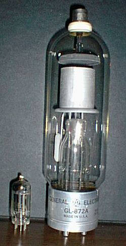

aerius Posted March 25, 2010 Report Posted March 25, 2010 I do have a half dozen 872-A rectifiers, but I need a filament ransformer the size of a lawnmower to run them. Bummer. I have a couple of those which I found in a surplus store and was planning to use as a giant night light. The local surplus suppliers didn't have a suitable transformer so I ended up using a computer PSU to power the filament. The project didn't get very far since I didn't have a socket for the tube and it was entirely put together with clip leads.
voodoochile Posted March 26, 2010 Author Report Posted March 26, 2010 My RCA book says 7.5A, up to 8A if the V is 5.25. Upshot is only dropping 10v I suppose. 15 amps for a full wave setup? It would make a neat nightlight, but the transformer would be quite a heater. These things are huge... [ATTACH=CONFIG]2929[/ATTACH]
