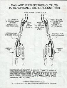

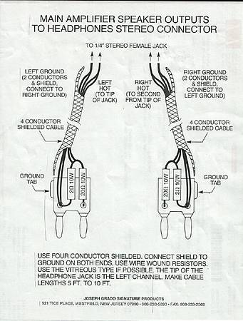

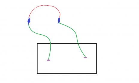

Eh had the wacky idea of running my HP's on the F1, but I would have to get them reterminated to balanced because the F1 is a true differential design, so the grounds can't be tied together, they need to be separate.

Depending on your mood regarding the redoing them balanced.... Taking the HP1000 apart is easy. I'd probably do that rather than hacking up a good vintage cable. Put the real cable back on later :)
