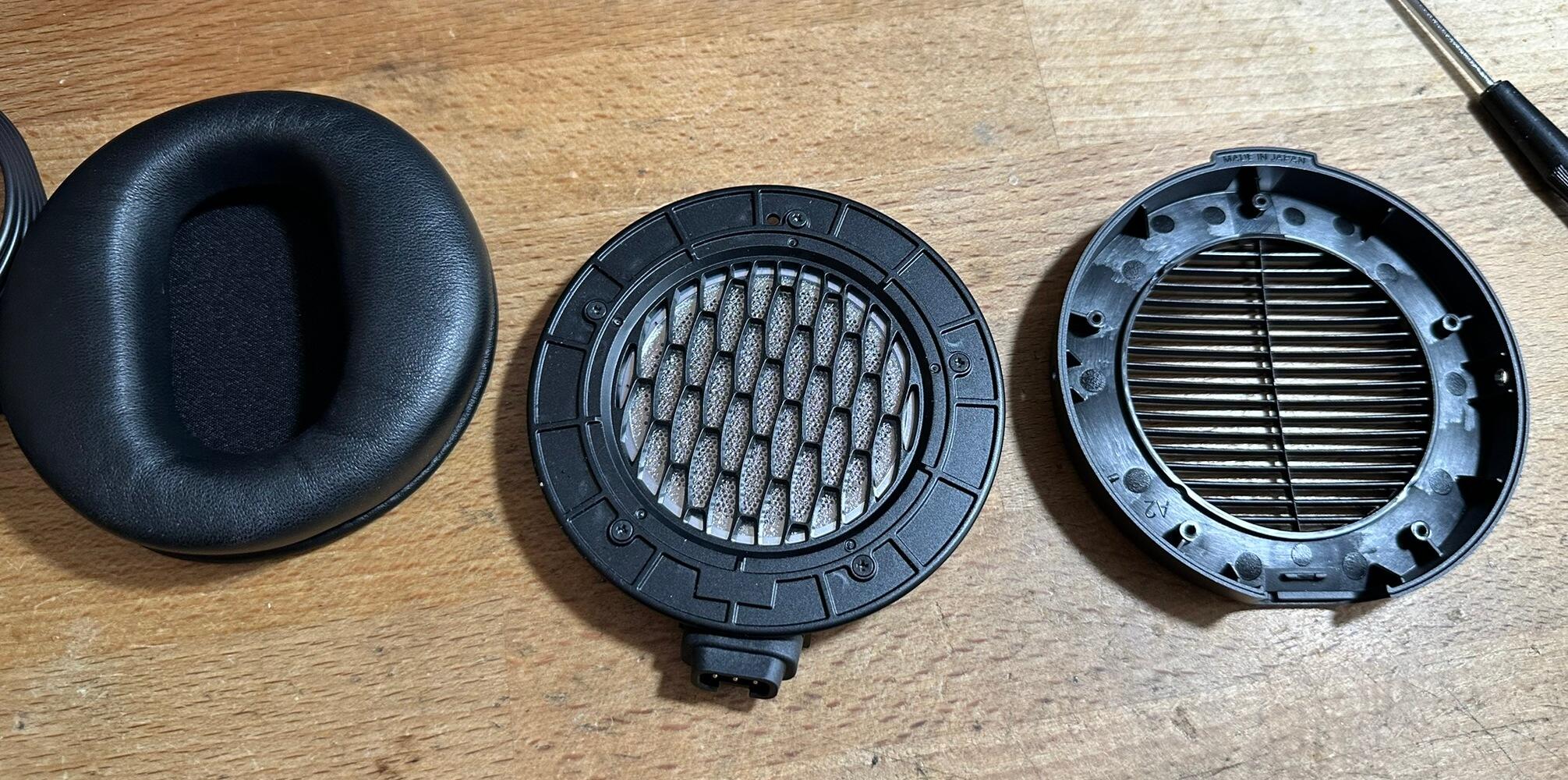

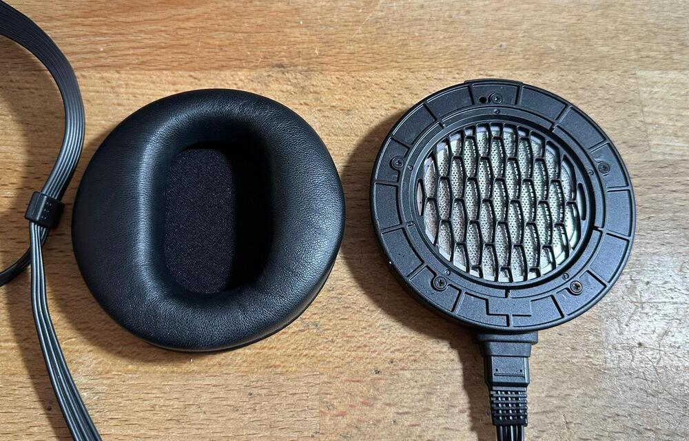

Well I took them apart so some pics:
The earpads just pull off and are much better made than the 009 pads.
Remove 5 screws and the back just falls off.  Notice the hole next to the top screw... yeah that's a port.  Stax did miss a trick here as they could have sealed the back and front completely with a rubber gasket similar to the HE60.

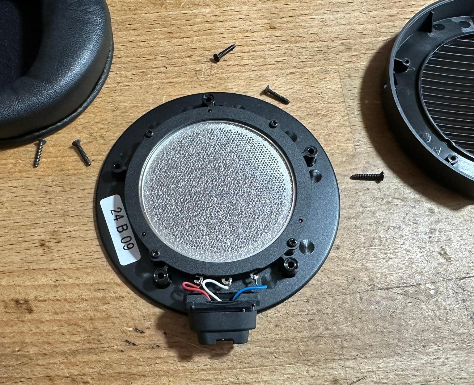

Here is the other side and the drivers is just held in place by those 4 screws.  The plate holding the driver together appears to be made from metal and it does exert a bit of force down on it.

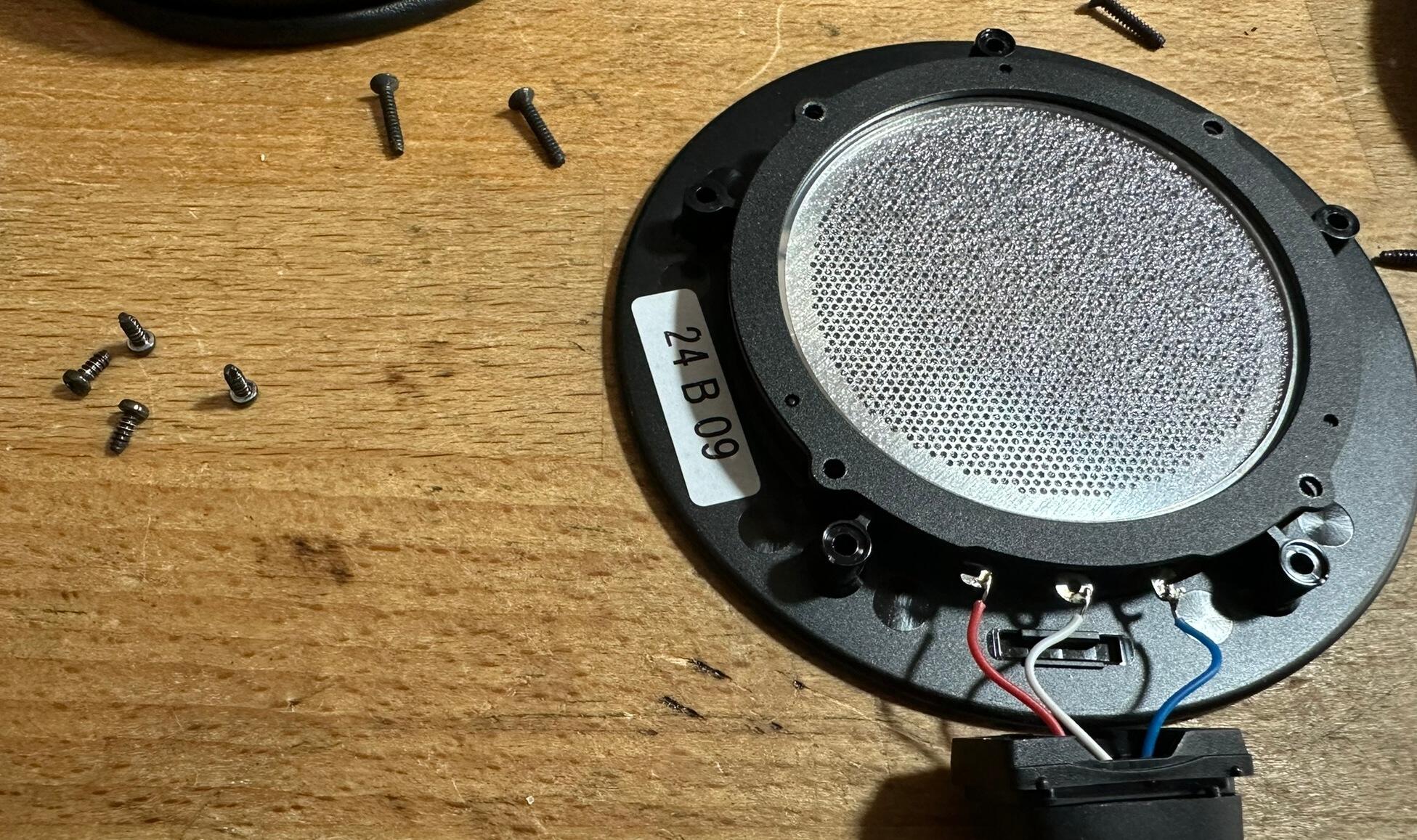

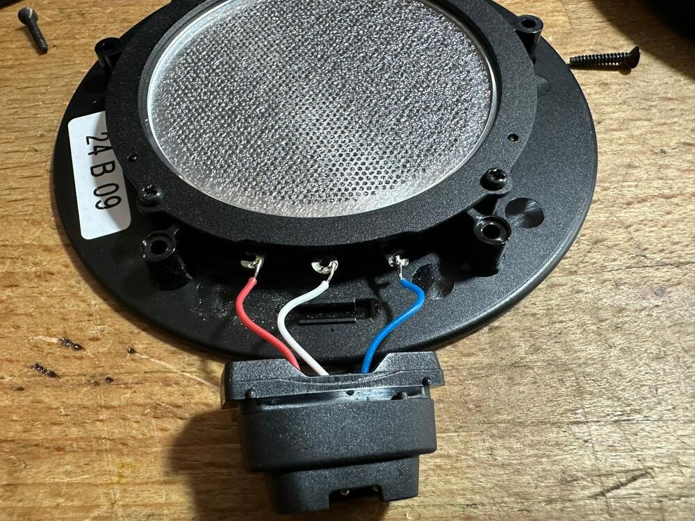

I don't love the soldering on this though...
Screws are out and I did look inside the drivers and it's standard Stax fair from the x07 series.  Metal stators and metal retaining rings for the diaphragm and dust covers.

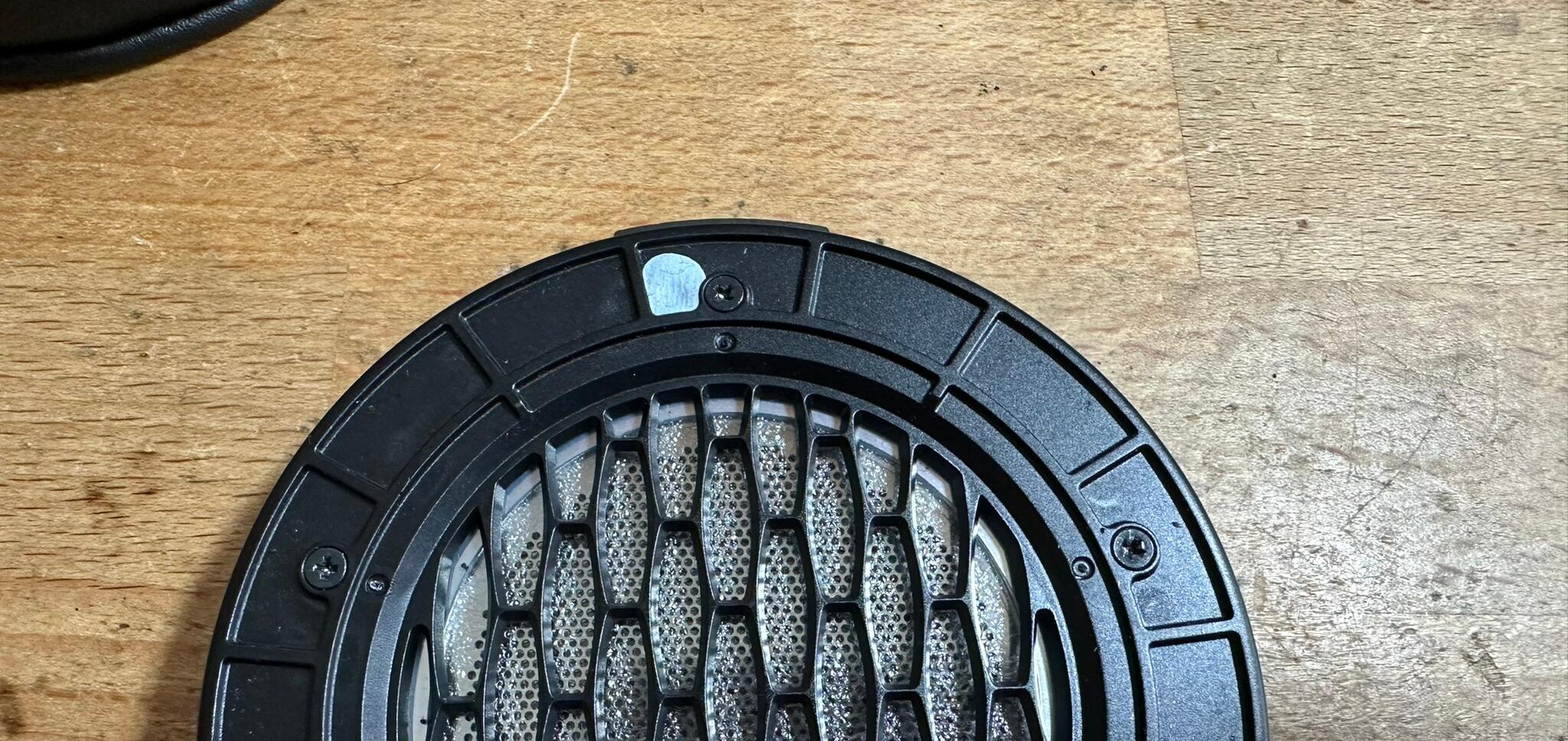

Here is a port block idea but I can't really test it as this set is borked...
