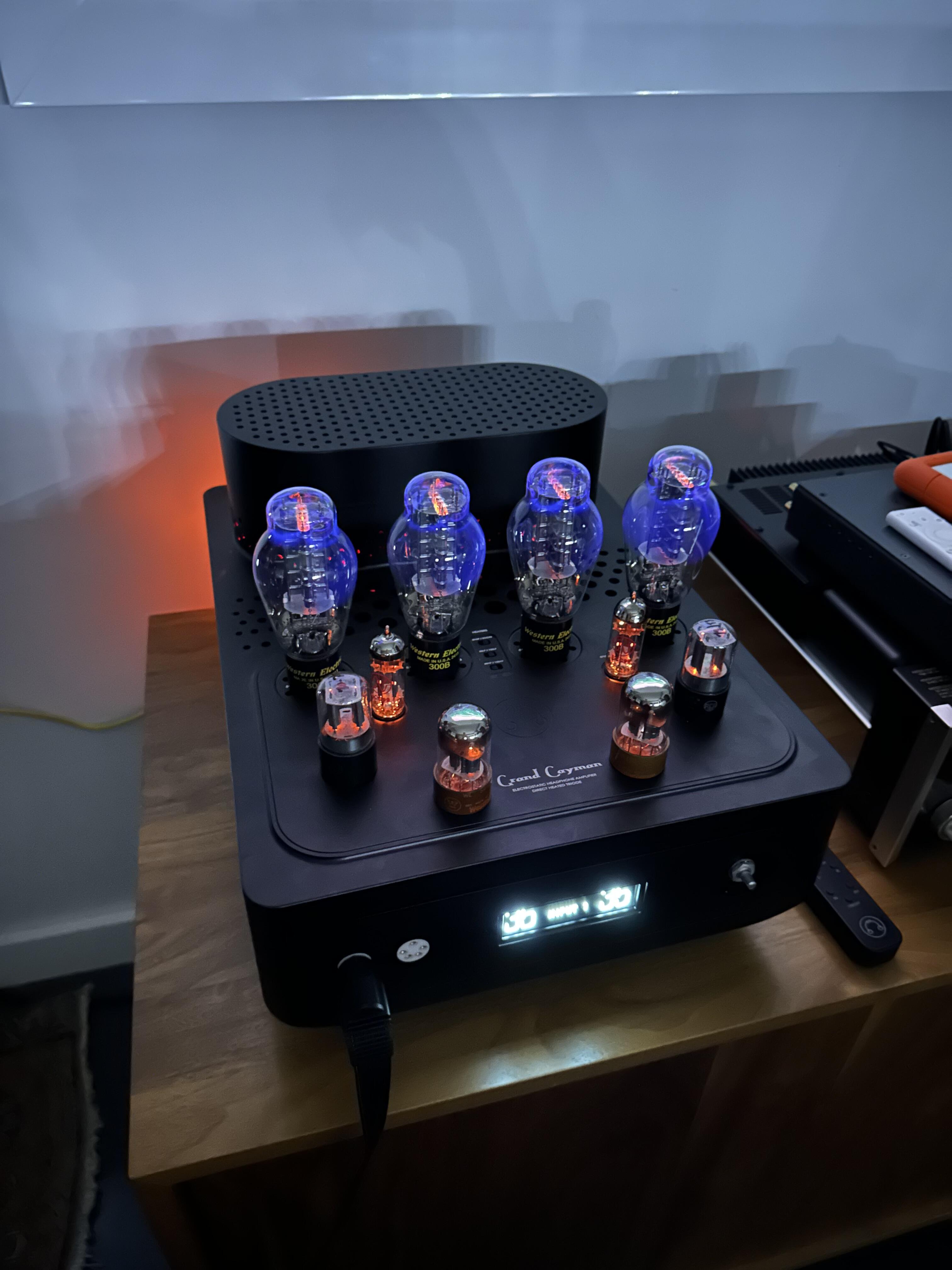

justin Posted March 7, 2024 Report Posted March 7, 2024 (edited) Here’s a quad of Western Electric 300B in the Grand Cayman. Just something i am trying while waiting on the first batch of finished enclosures to arrive (the power transformers just got here by boat) how does it compare with 20B? So far, here are some bullet points - Surprisingly low noise. This is with dc heaters. The blue hawaii, or Grand Cayman with 20B or 300B all have about the same noise floor, using decent tubes. - The gain is a bit low. About 375x with WE 300B, 425x with EHX, and the EML 20B version is about 700x. [note: i havent tried changing any feedback setting yet] for comparison most Stax amps are between 500x and 1000x gain the lower gain could work out great if adding a preamp in front of the amp, but for a quick increase to 1000x gain simply replace the input tube 6SN7/12SN7 with a higher gain 6SL7/12SL7 As one would expect, distortion is higher. About .1 to .2% under load, or about 10x as high as the 20B which one sounds better is likely going to be very subjective and will have to wait until i get a 2nd one put together for proper A/B comparisons Edited March 7, 2024 by justin 18 Quote
Jon L Posted March 10, 2024 Report Posted March 10, 2024 On 3/7/2024 at 11:32 AM, justin said: Here’s a quad of Western Electric 300B in the Grand Cayman. WE300B tubes were only making 5.5 watts vs 8 watts of Shuguang 300B-Z in this video. It's a bit puzzling and I wonder if other 300B tubes may be a better option in the 'stat amp? Quote

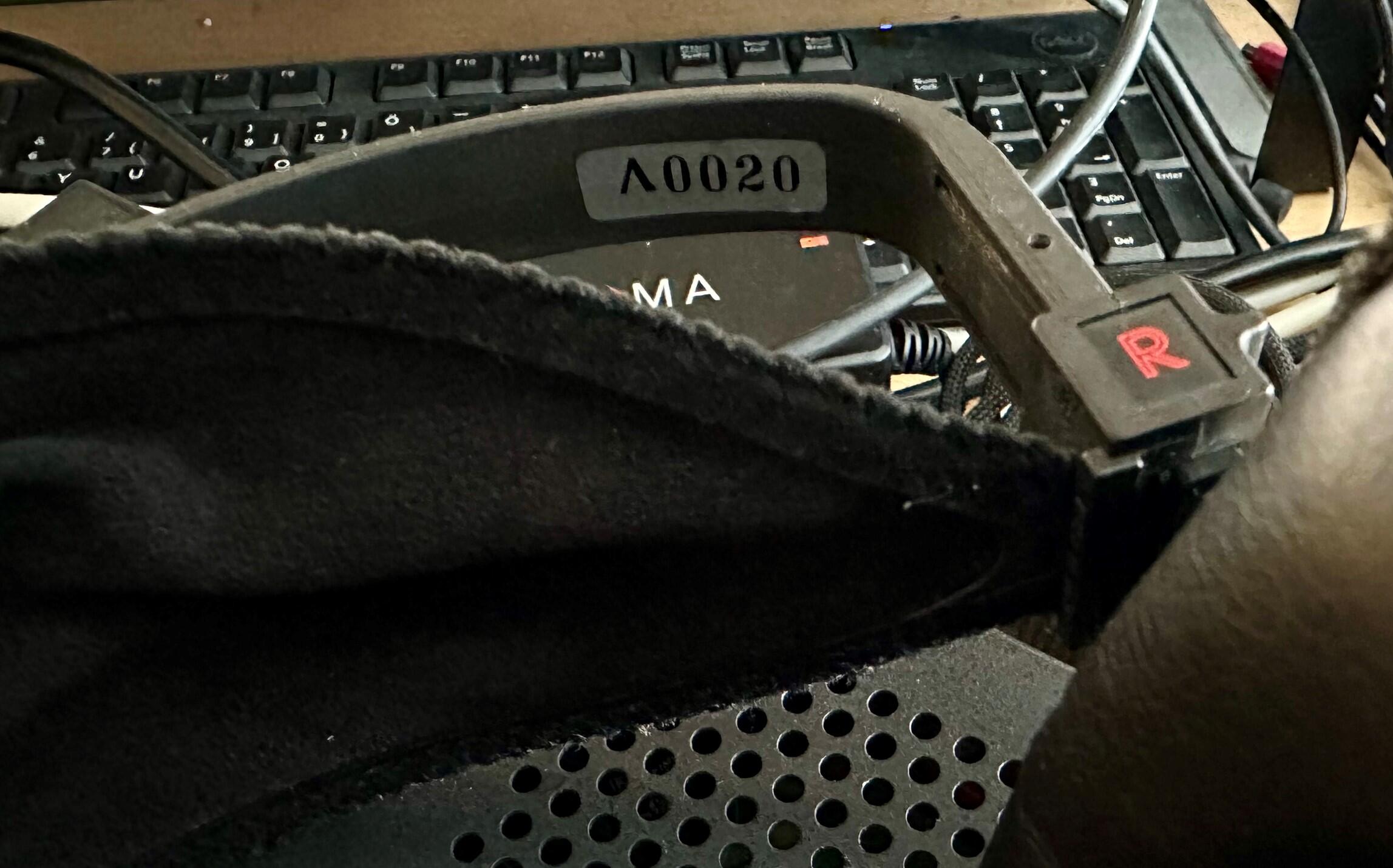

spritzer Posted April 6, 2024 Report Posted April 6, 2024 This is funny, I just bought some SRD-7's to use as donors for my own boxes. A SR-Lambda was included with one of those energizers and just look at that serial number... Aside from the foam in the earcups being crusty and the earpads having been replaced at some point, they play perfectly for a 45 year old set. 14 Quote
