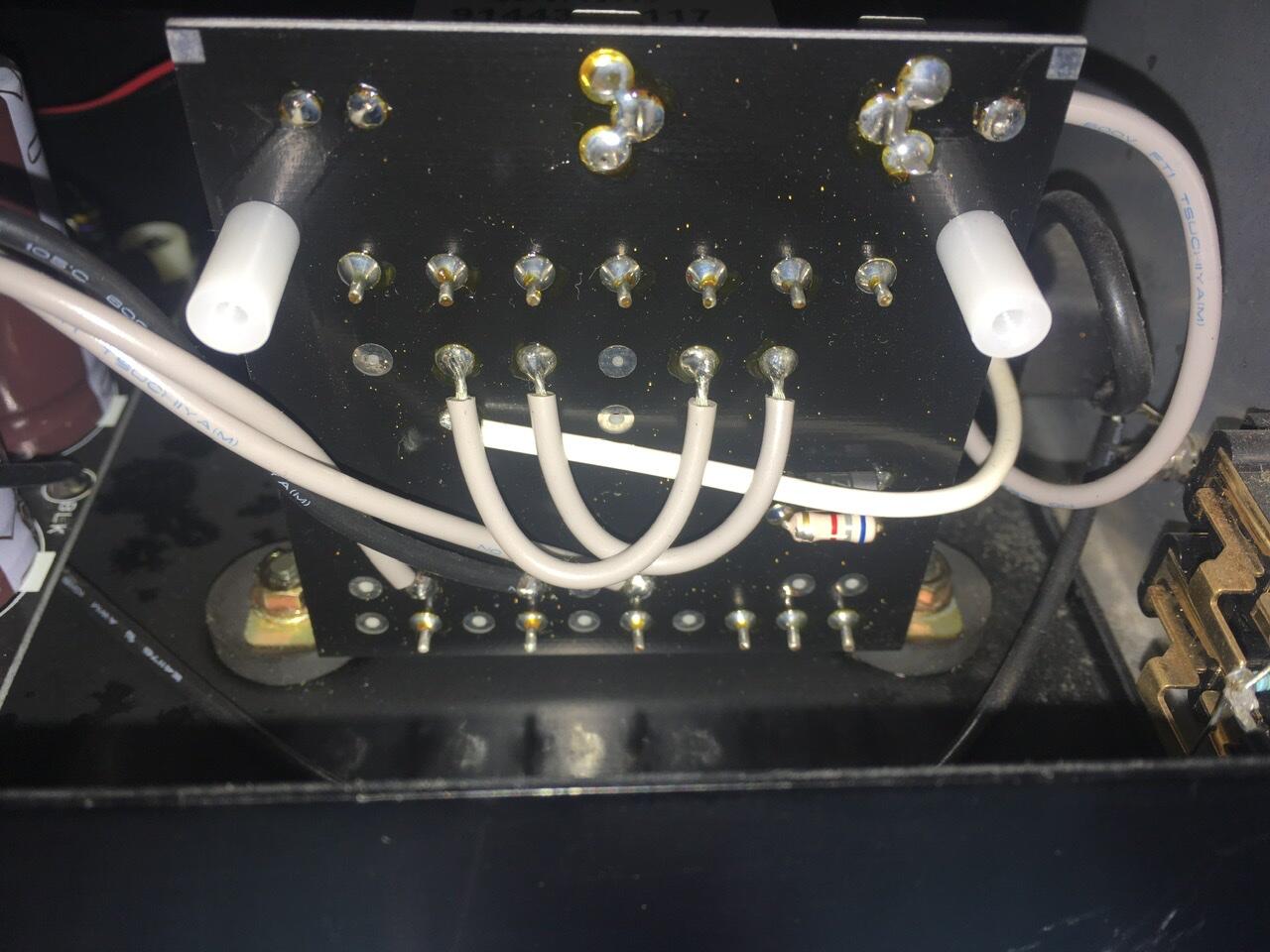

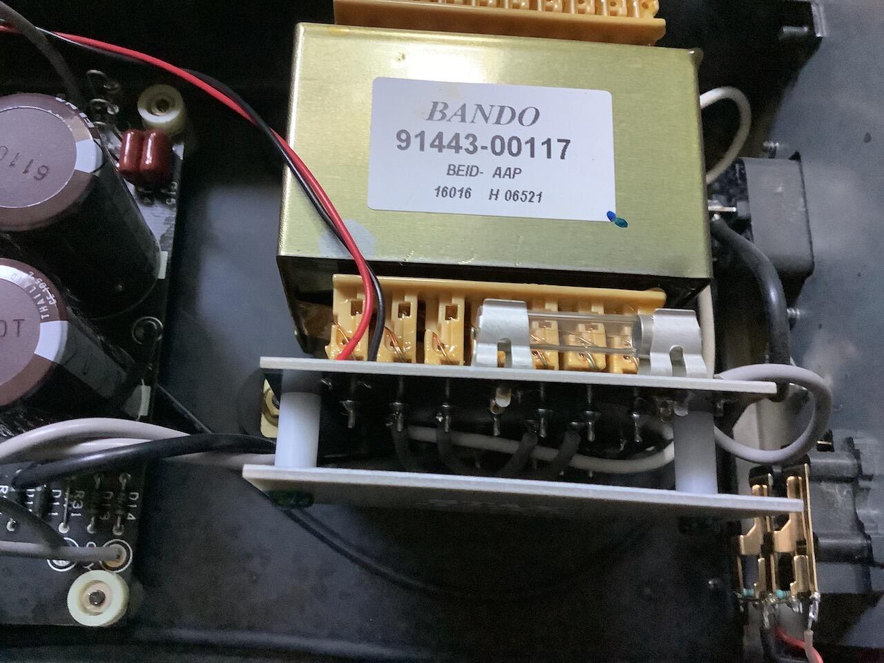

Vlaca Posted April 7, 2022 Report Share Posted April 7, 2022 (edited) Hi All! I bought an srm-313, 100V version. I want to reconfig to 240V. Somebody know the procedure? (I found srm1 reconfigure info, but not for 313.) It seems the transformer primary windigs has 7 pin.(Srm1 only 6 pin.) Edited April 7, 2022 by Vlaca added one photo Quote Link to comment Share on other sites More sharing options...

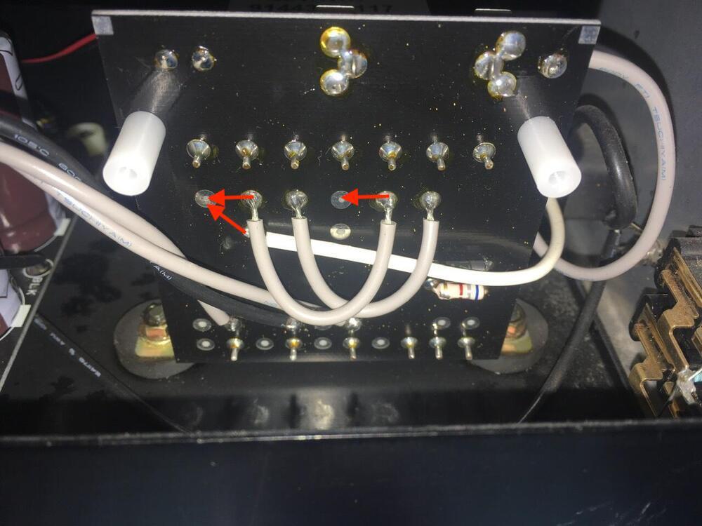

spritzer Posted April 7, 2022 Report Share Posted April 7, 2022 I've never seen that exact setup but it is basically the same as others. See those two gray links, they are the adjustment but you also need to move the white wire as seen here: 2 Quote Link to comment Share on other sites More sharing options...
Vlaca Posted April 8, 2022 Report Share Posted April 8, 2022 17 hours ago, spritzer said: I've never seen that exact setup but it is basically the same as others. See those two gray links, they are the adjustment but you also need to move the white wire as seen here: Ok i see the red lines, its connect serial the two primary windigs. The grey links need to remove?(These paralell connect the windigs, for lower voltage/bigger amperage.) Thank you so much! Quote Link to comment Share on other sites More sharing options...
spritzer Posted April 8, 2022 Report Share Posted April 8, 2022 Yes, the gray links need to be removed. You can use one of them to make the new connection. 1 Quote Link to comment Share on other sites More sharing options...
Vlaca Posted April 8, 2022 Report Share Posted April 8, 2022 36 minutes ago, spritzer said: Yes, the gray links need to be removed. You can use one of them to make the new connection. Ok, understand. Thank you! Quote Link to comment Share on other sites More sharing options...

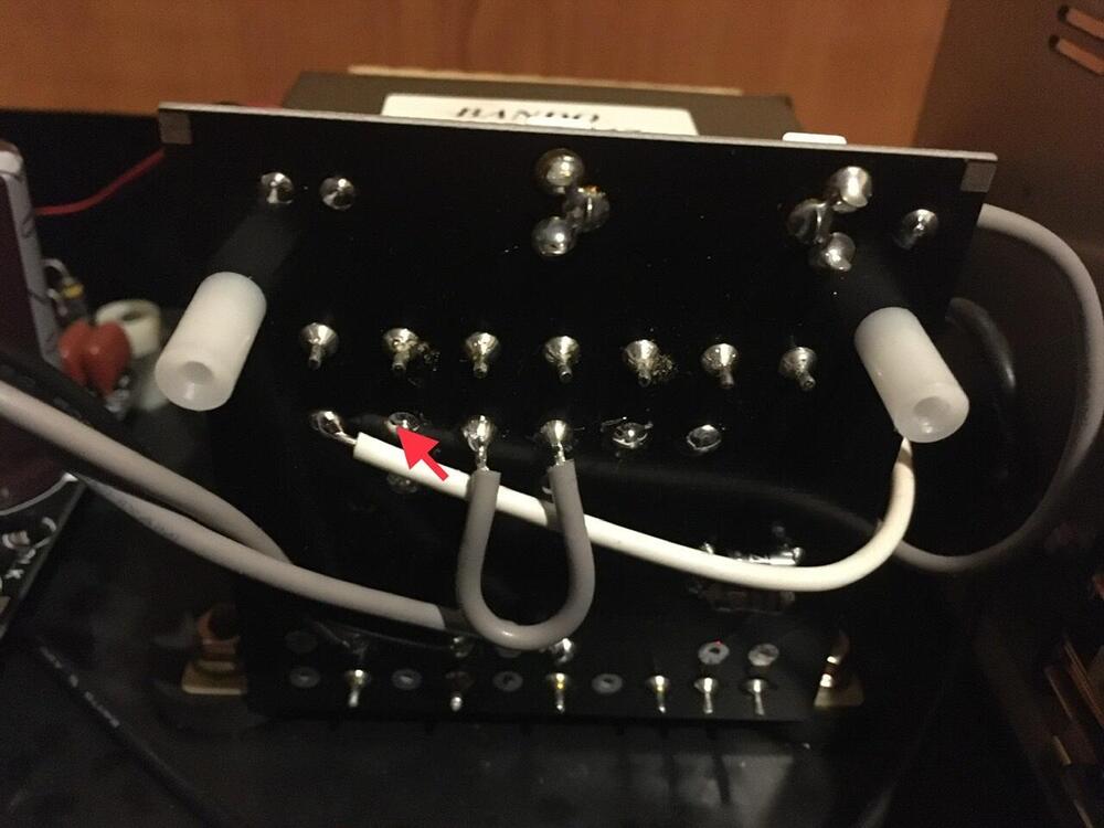

Vlaca Posted April 9, 2022 Report Share Posted April 9, 2022 19 hours ago, spritzer said: Yes, the gray links need to be removed. You can use one of them to make the new connection. Yeah, its working fine. 😀 Just one little issue(?). I measured the double secondary voltages.(grey,black,grey wires in bottom left) In original 100V config(with outboard step down transformer) : 2x225VAC Now in 240V config: 2x200VAC. Here in Hungary the official mains voltage 230 VAC. I measured 223VAC in mains socket.😅 Its ok to use the amp in 240V config(little less secundary voltage) or necessary to reconfigure to 220V? ( The white wire solder to the second pin(red arrow in pic), ok to 220V config?) Sorry for another questions and thank you for your support! 👍 Quote Link to comment Share on other sites More sharing options...
spritzer Posted April 9, 2022 Report Share Posted April 9, 2022 For actual 220VAC line voltage, feel free to move the white wire back to its former position. The rest of Europe is pushing well above 240V so that's what I always set the amps to. 1 2 Quote Link to comment Share on other sites More sharing options...

Vlaca Posted April 25, 2022 Report Share Posted April 25, 2022 6 hours ago, qqiao said: @spritzer Hi spritzer, could you kindly point me how to modify 313 from 100v to 120v? Thank you very much. I see vlaca's photo and he converted it to 240v. Hi! I painted the 120V setup (If i understand right the transformer windigs.) You need to move one jumper wire left, and the white wire to the leftmost pin. Please wait until Spitzer confirm this is the right setup. Quote Link to comment Share on other sites More sharing options...
spritzer Posted April 25, 2022 Report Share Posted April 25, 2022 That is correct except I'd move the white wire to the other empty hole as it would be connected through the jumper anyway. 1 Quote Link to comment Share on other sites More sharing options...

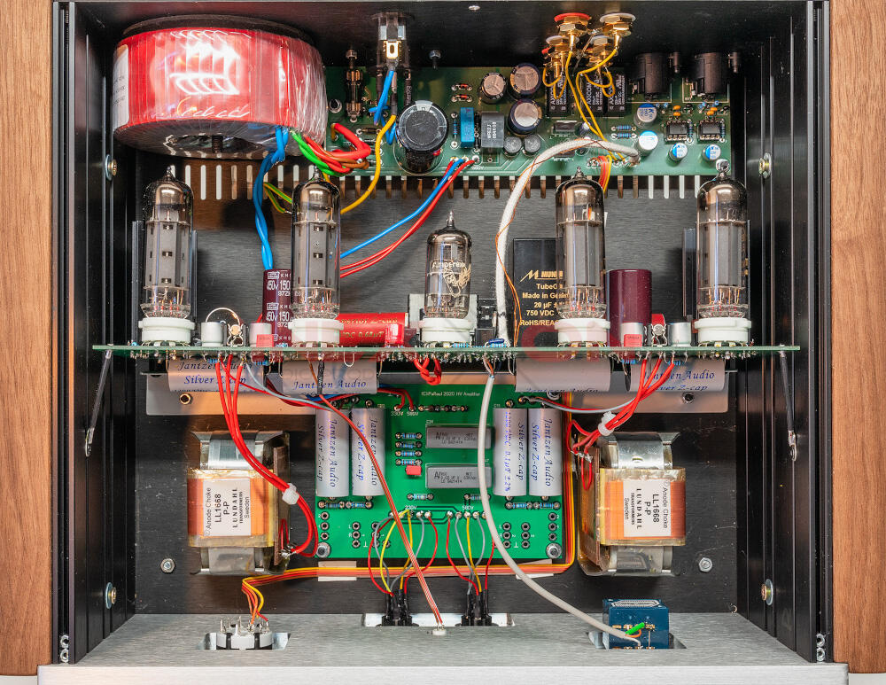

spritzer Posted May 4, 2022 Report Share Posted May 4, 2022 The Paltauf is a bad joke... I mean look at it: It's a speaker amp with the electrostatic signal taken off the plates through capacitors. Yeah... all the issues of doing that. 2 Quote Link to comment Share on other sites More sharing options...
