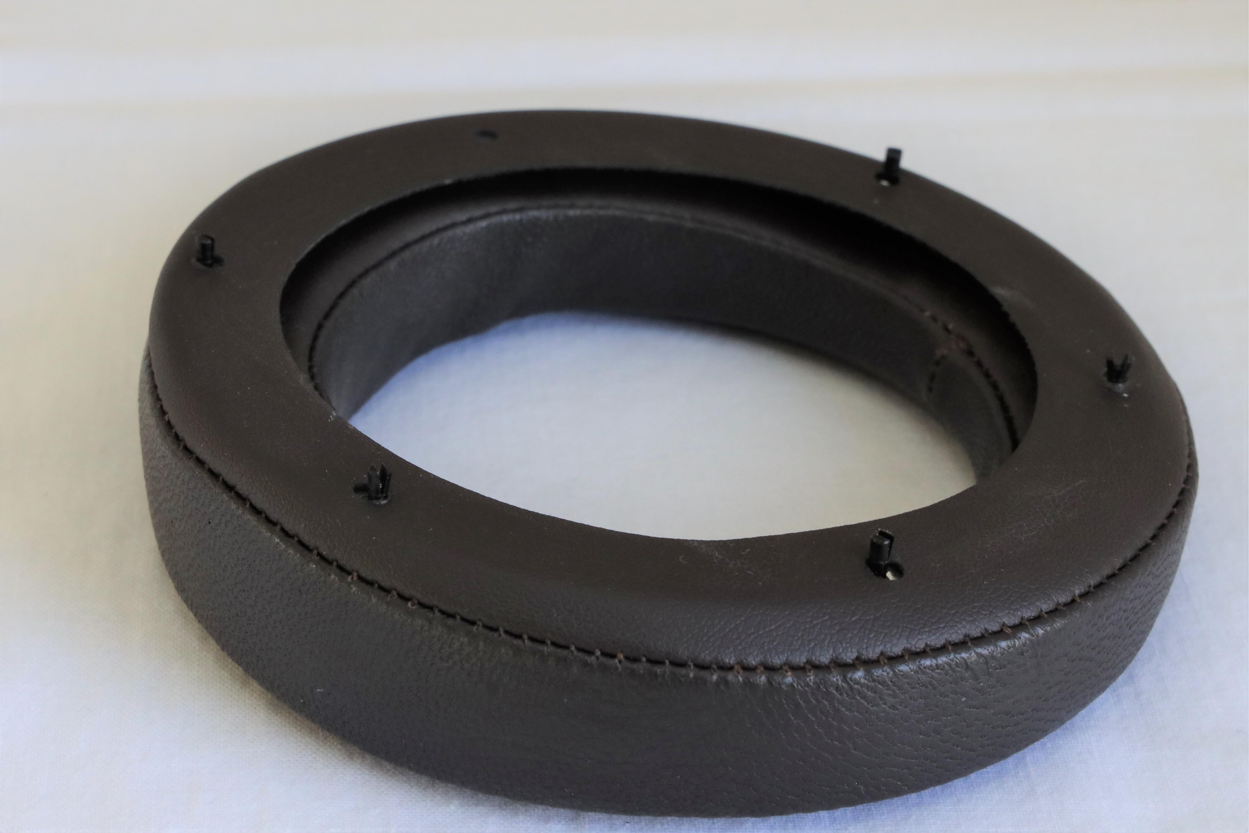

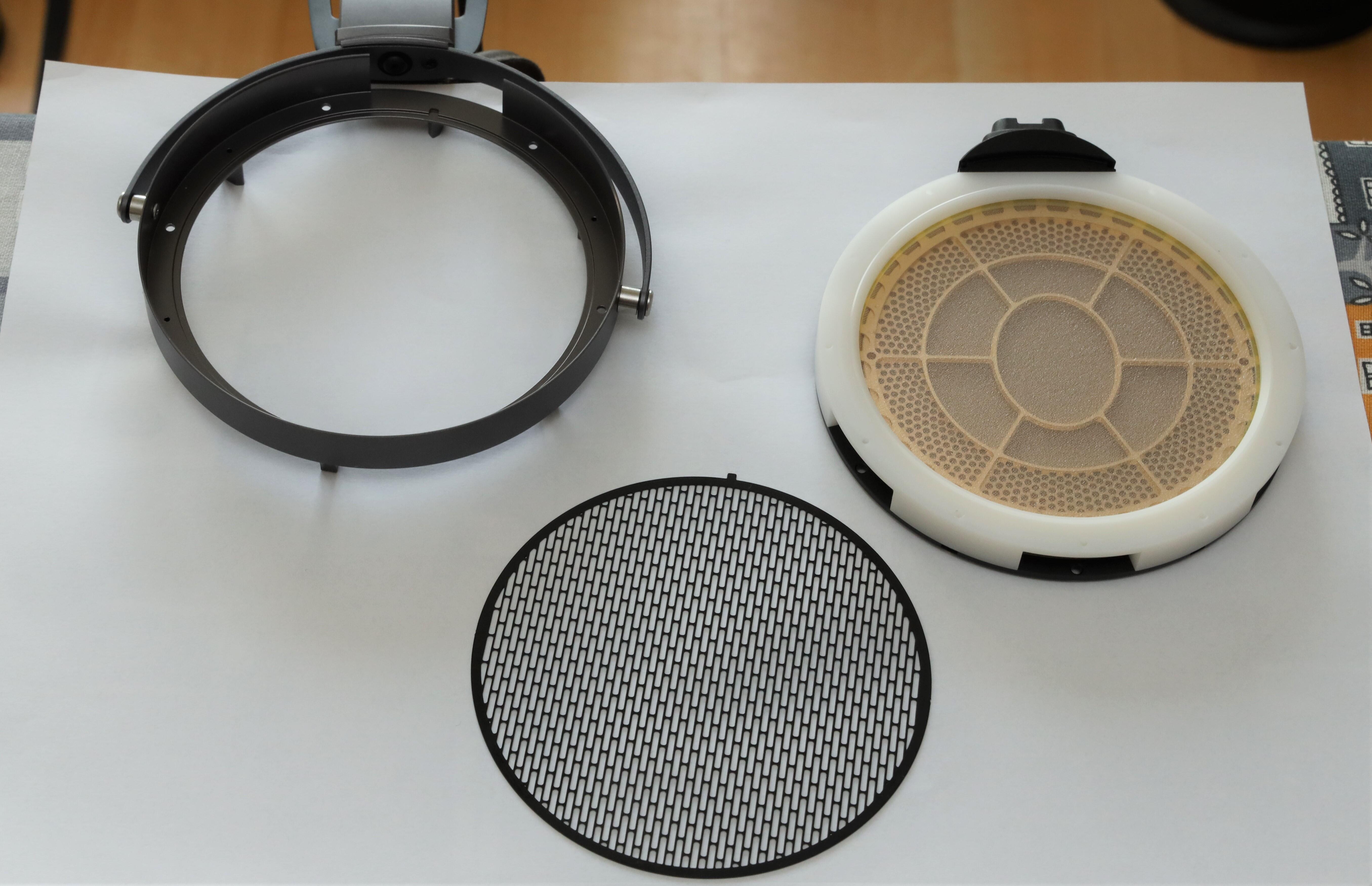

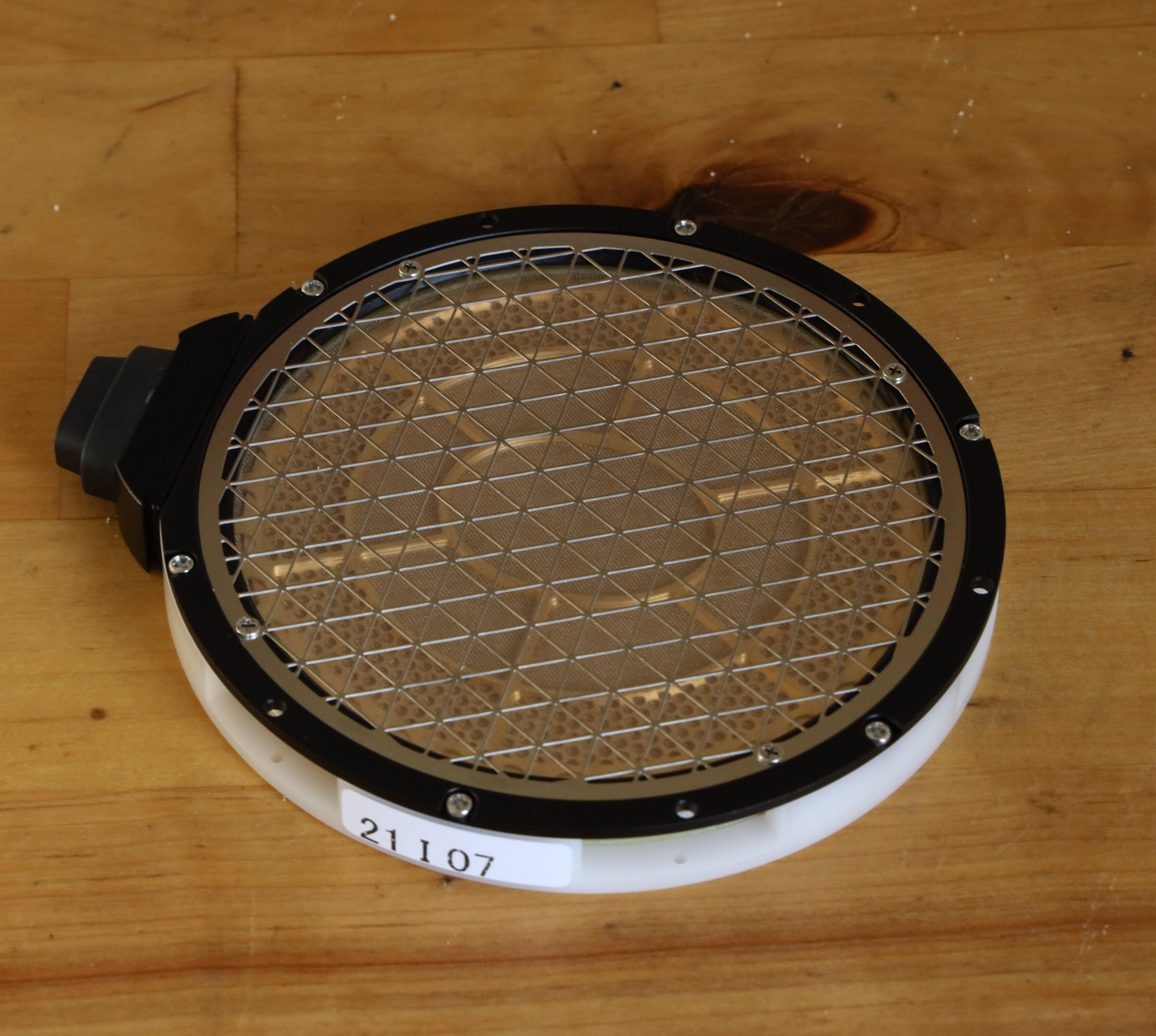

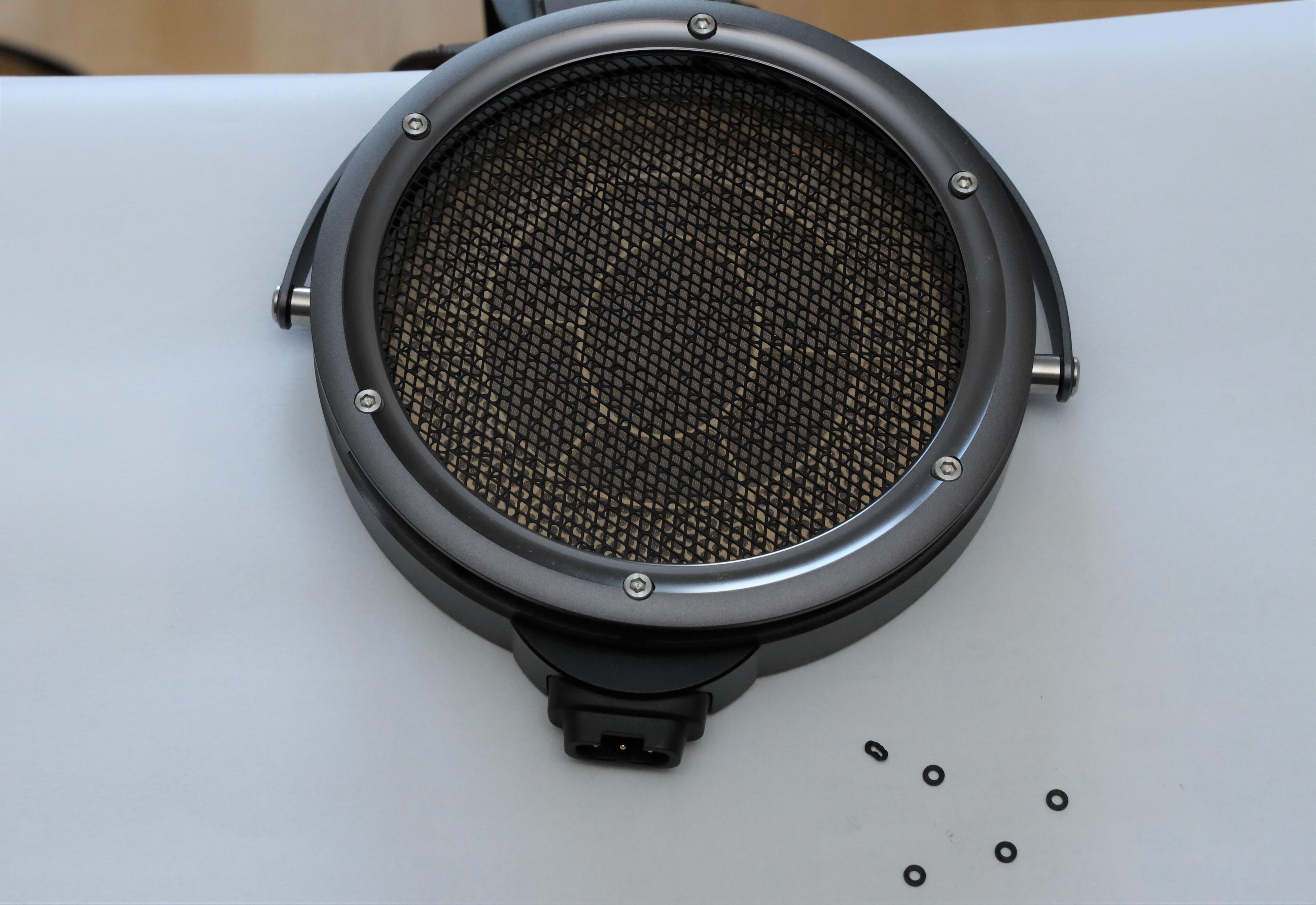

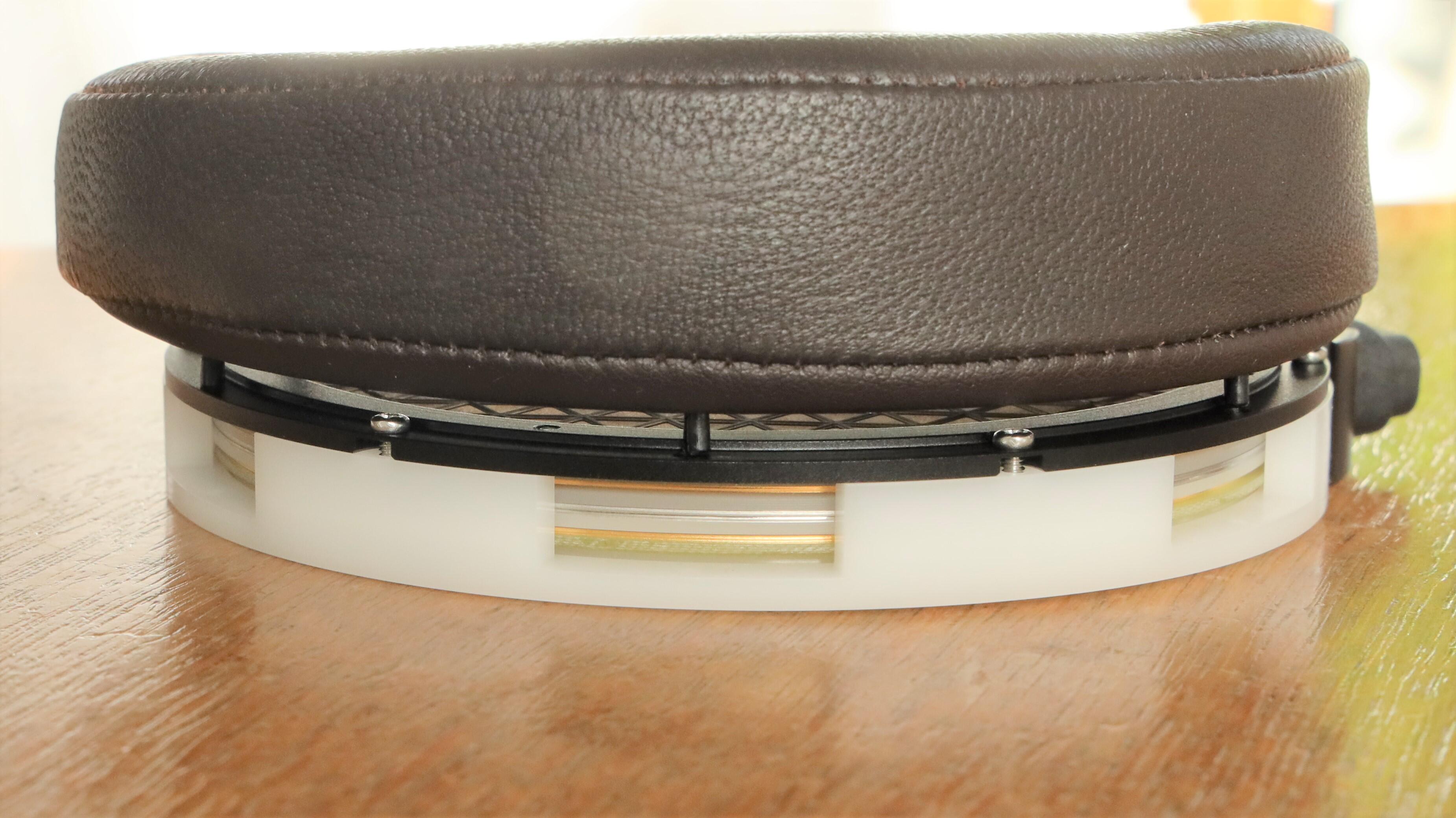

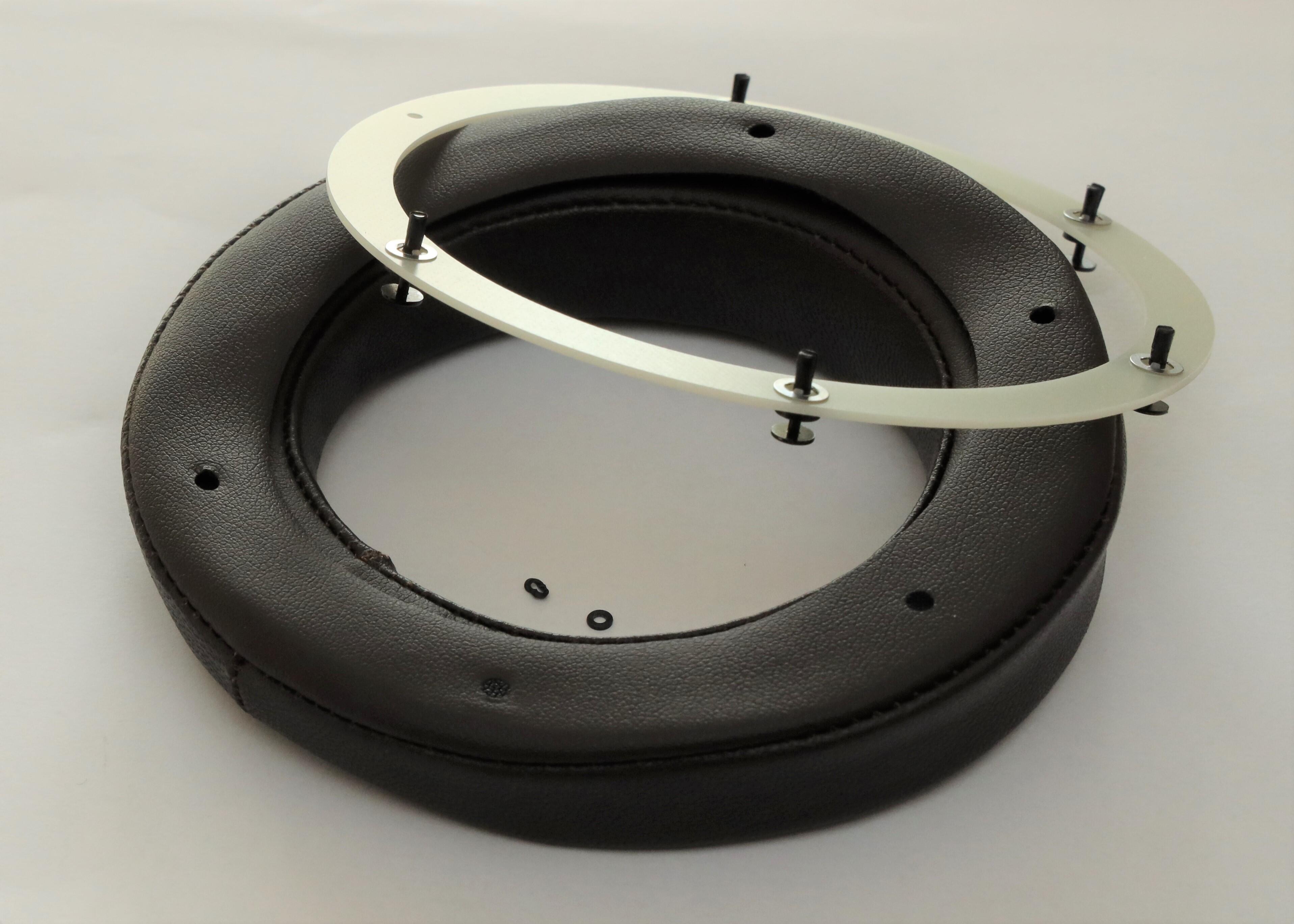

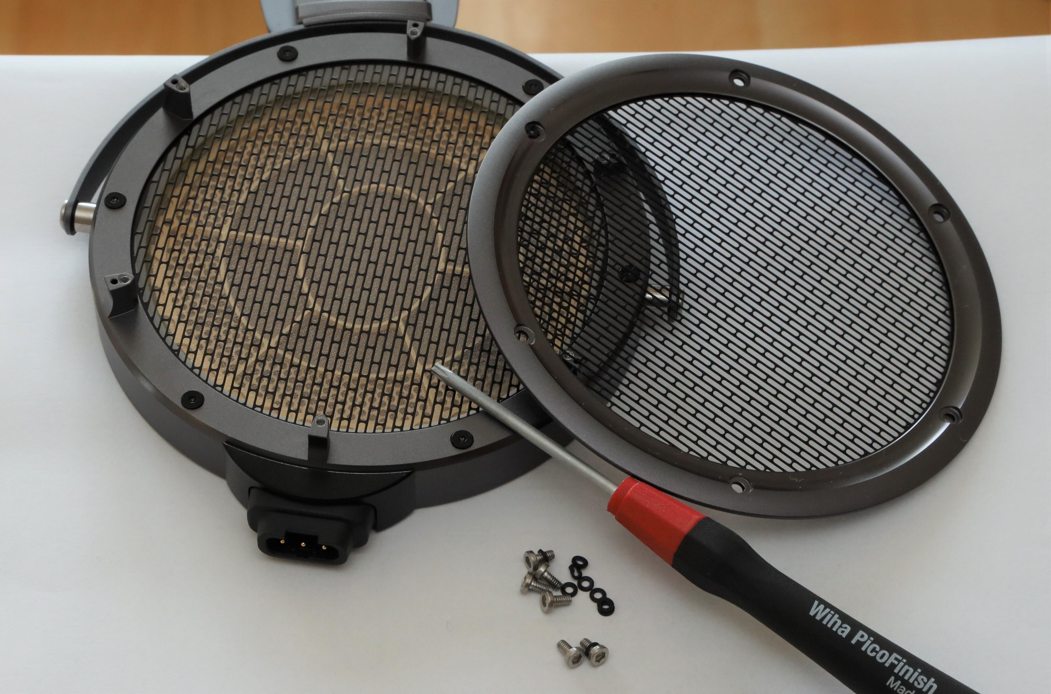

JoaMat Posted November 7, 2021 Report Share Posted November 7, 2021 (edited) Until trusted person gives a reliable review here, you might study the interior of the new Stax SR-X9000. I let the pictures speak for themselves. Edited November 7, 2021 by JoaMat 7 10 Quote Link to comment Share on other sites More sharing options...
spritzer Posted November 7, 2021 Report Share Posted November 7, 2021 Interesting how much is borrowed from the Omega but better implemented 30 years on. Funny to see only five rivets holding the earpads on as the sixth one interfered with the cable entry back then... One concern I have is the thin housing as on the original and how that might behave when pushing them. At least there is no fragile acrylic shell here which will break after 30 years... 2 Quote Link to comment Share on other sites More sharing options...

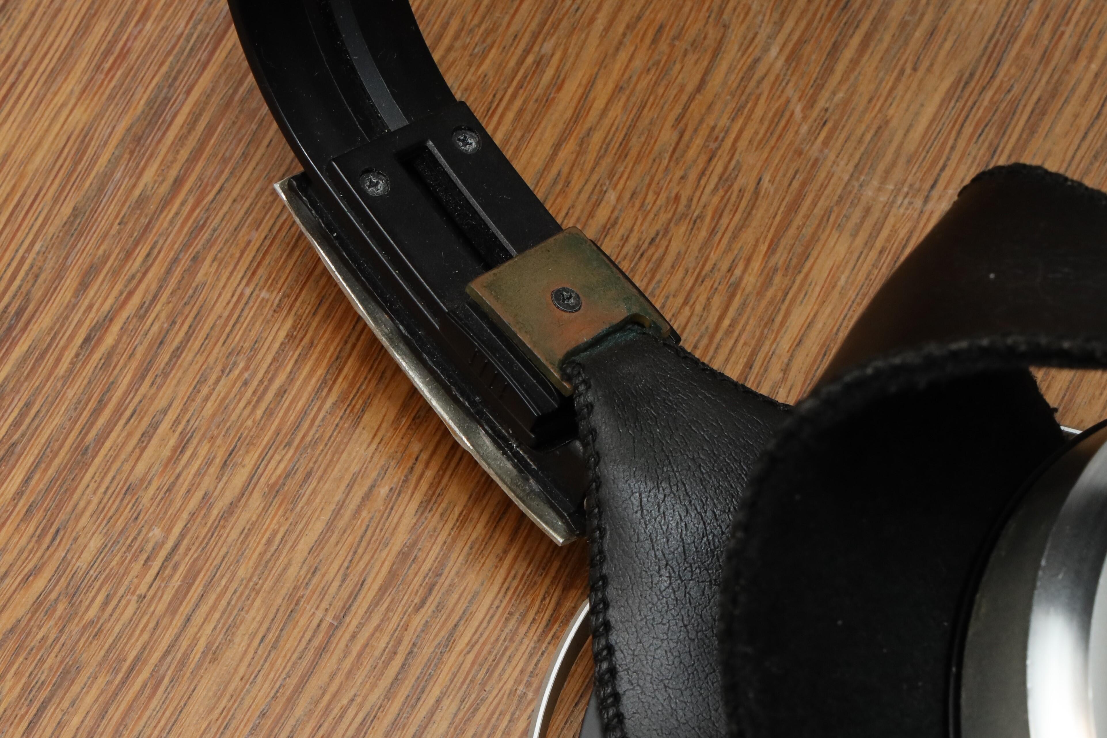

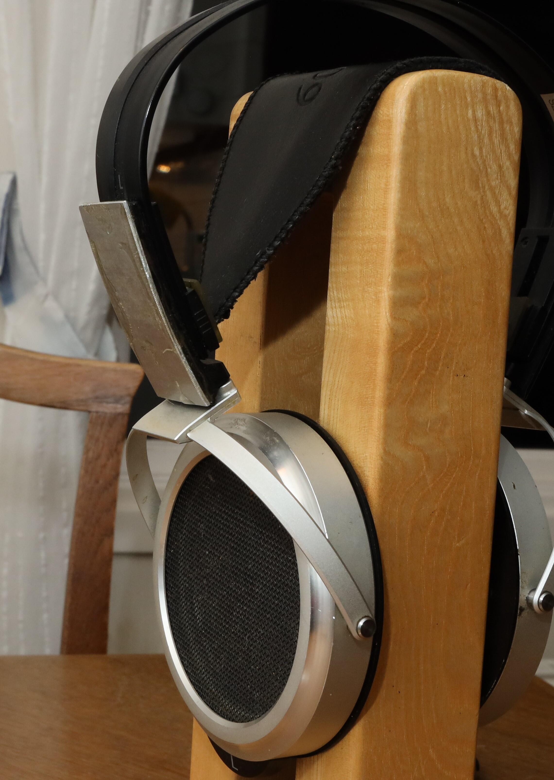

JoaMat Posted November 7, 2021 Report Share Posted November 7, 2021 (edited) This broke after a couple of years. But a piece of aluminum and 2 component epoxy fixed it and a cnc milled small PCB replaced another broken original part. Edited November 7, 2021 by JoaMat 3 1 Quote Link to comment Share on other sites More sharing options...
spritzer Posted November 7, 2021 Report Share Posted November 7, 2021 The 009 headband is such an utter pile of crap... The winner for the most stupid headband goes to one mystery electrostatic I'll be posting about soon. 1 Quote Link to comment Share on other sites More sharing options...
Four Kneez Posted November 7, 2021 Report Share Posted November 7, 2021 X9000 has been hard to get ahold of even at shows. Only one at CAF, and it’s paired with an LTA Z10e. For what it’s worth, reviews here have been very positive. I only spent a few minutes with it and would’ve preferred to run it on something like the BHSE which was also at the show, so I’ll refrain from giving impressions. Quote Link to comment Share on other sites More sharing options...

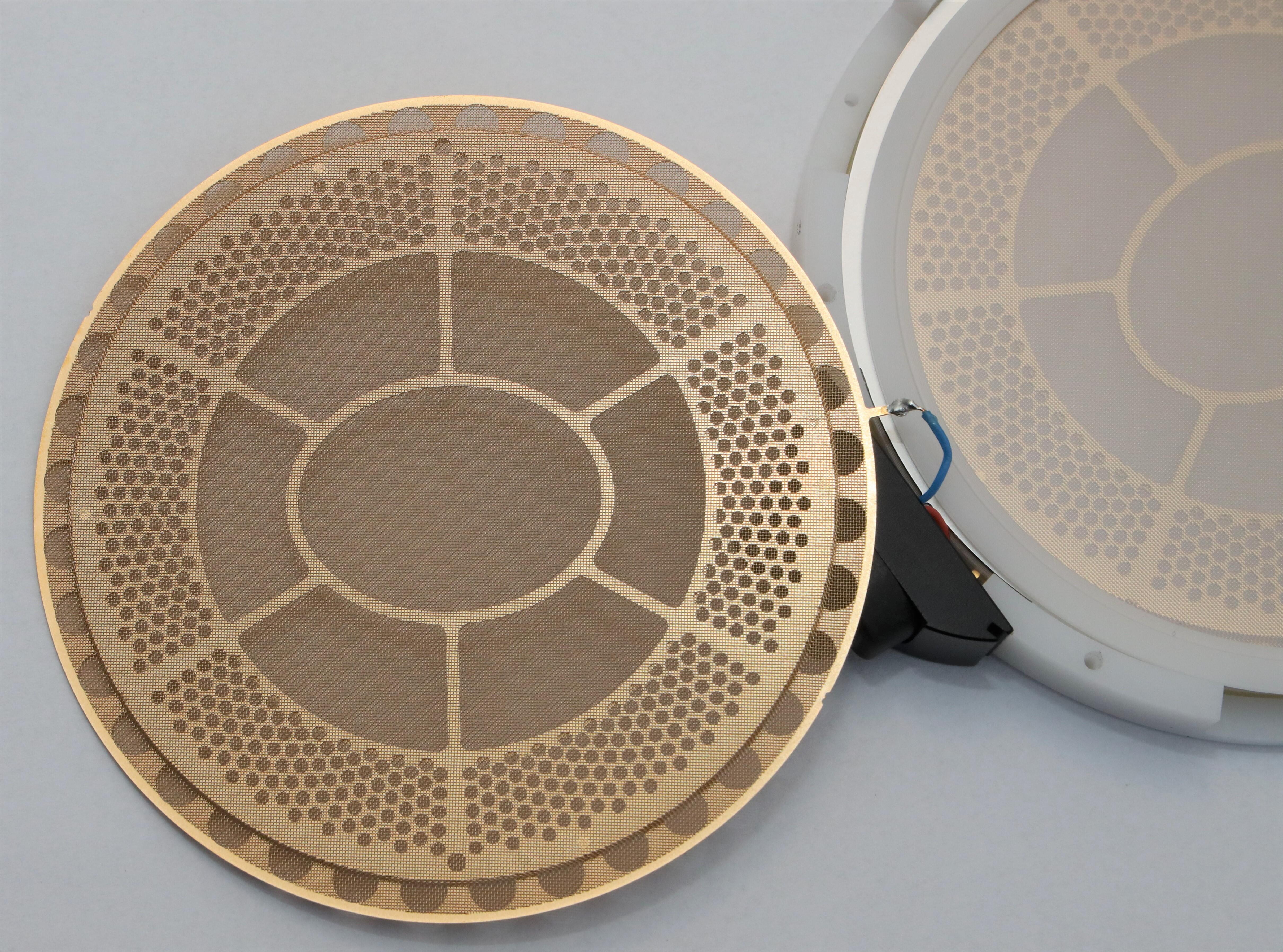

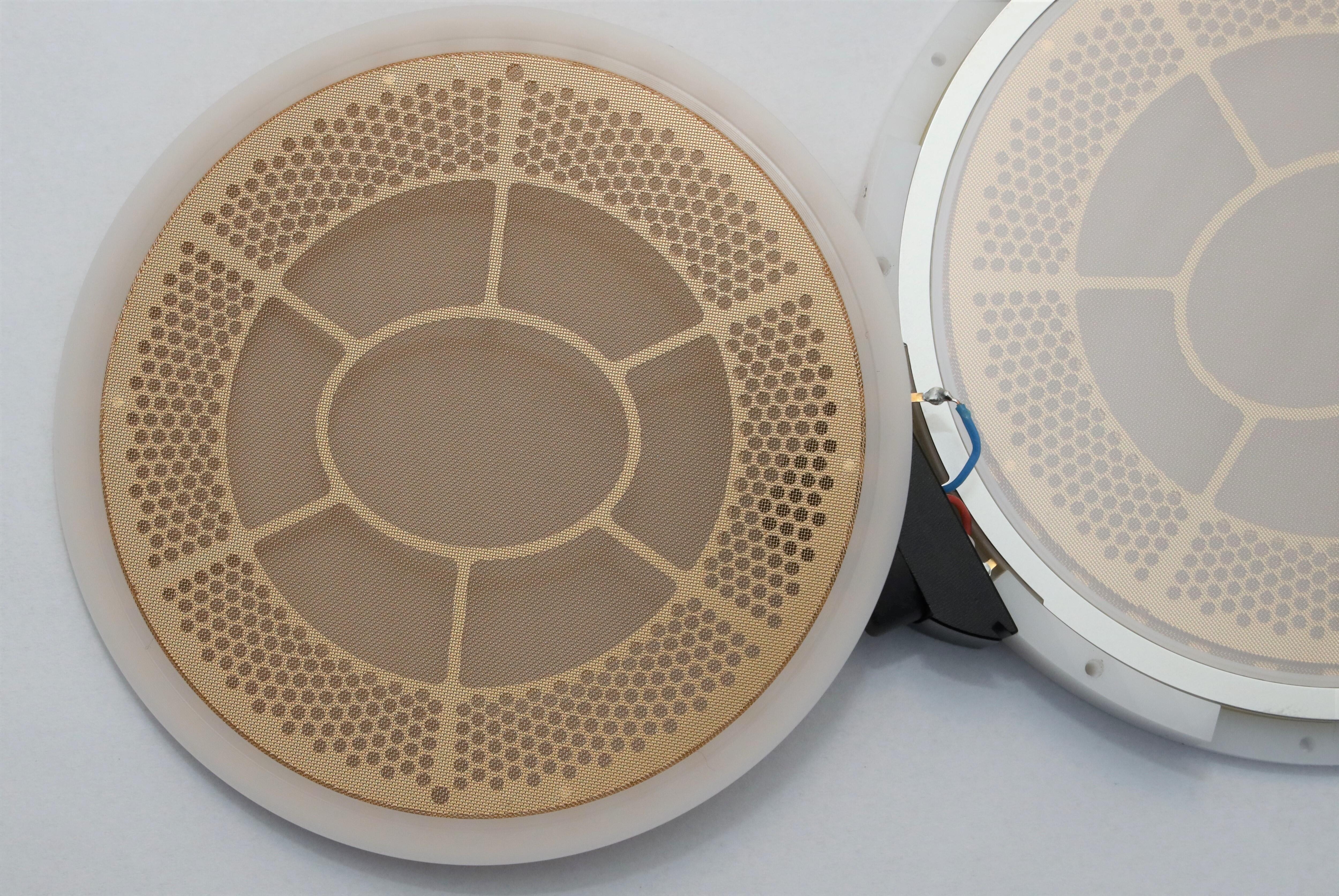

chinsettawong Posted November 8, 2021 Report Share Posted November 8, 2021 10 hours ago, JoaMat said: Until trusted person gives a reliable review here, you might study the interior of the new Stax SR-X9000. I let the pictures speak for themselves. Thanks for sharing the pictures. Have you a picture of the other side of the stator, the side that faces the diaphragm? What is the material and thickness of the spacers? Quote Link to comment Share on other sites More sharing options...
bwck2000 Posted November 8, 2021 Report Share Posted November 8, 2021 I wonder will the position of the bolts allow me to use a pair of the original sr-omega earpads? Quote Link to comment Share on other sites More sharing options...
JoaMat Posted November 8, 2021 Report Share Posted November 8, 2021 (edited) 6 hours ago, chinsettawong said: Thanks for sharing the pictures. Have you a picture of the other side of the stator, the side that faces the diaphragm? What is the material and thickness of the spacers? "Diaphragm" side of stator. Zoom in and you can see the structure of net (copper??). Stator with plastic ring. Outer diameter 94mm and inner 84mm. Thickness of diaphragm ring is 0,95mm on my digital caliper, so I would say spacer thickness 0,5mm. To me spacer material looks like aluminium. Edited November 8, 2021 by JoaMat 8 5 Quote Link to comment Share on other sites More sharing options...
judo Posted November 8, 2021 Report Share Posted November 8, 2021 What method they can do this stator structure? Quote Link to comment Share on other sites More sharing options...
