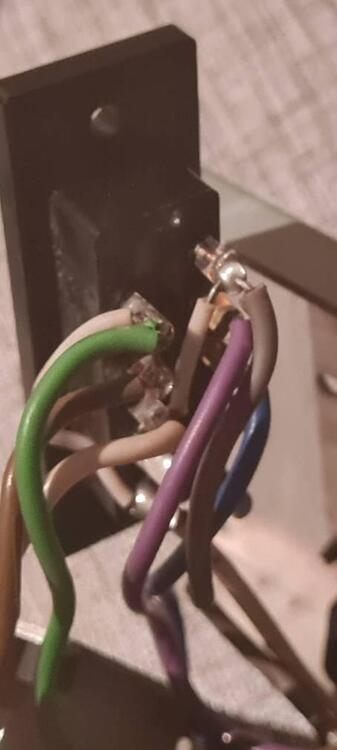

Bingturong Posted August 28, 2021 Report Share Posted August 28, 2021 I got an old type A SRM-1 Mk2 JDM, I want to convert it from 100v to 220v but there is no exterior jumper so I'll need to wire the voltage selector myself. From reading previous threads, what I should do is remove the jumper between green and brown and simply swap brown for blue right? Also even using a step down converter and having the amp successfully turned on there is still no sound what so ever. I replaced the electrolytics and there's power going into ever component I tested but complete silence. Curiously though the amp should be rated for 370V RMS but I'm getting around 420V RMS from the rails. I suspect it may be due to the stepdown transformer being rated 110-120v instead of the 100v, hence my desire to change the voltage. Quote Link to comment Share on other sites More sharing options...
Bingturong Posted August 29, 2021 Report Share Posted August 29, 2021 Right so apparently I didn't read enough. I found an old post by spritzer that said it worked find with his C-series SRM-1 Mk2 and meant for amps that didn't come with a jumper. Though mine isn't a c-series it didn't ship with a jumper but heck it should work. Tried it out and it powers on, no explosions, no burning, nothing. Plugged in a headphones AND there is still not audio. Though I have discovered that the normal bias does not energise at all whereelse the pro bias does, there's also a hissing sound too only from the pro bias. A quick voltage test from the rails show mid to upper 360V so it seems the voltage change has been a success. Given that the caps I used are rated at 400V, I think I may go find some new ones... My biggest worry though is the transformer is a goner so I'll test that out. Quote Link to comment Share on other sites More sharing options...
