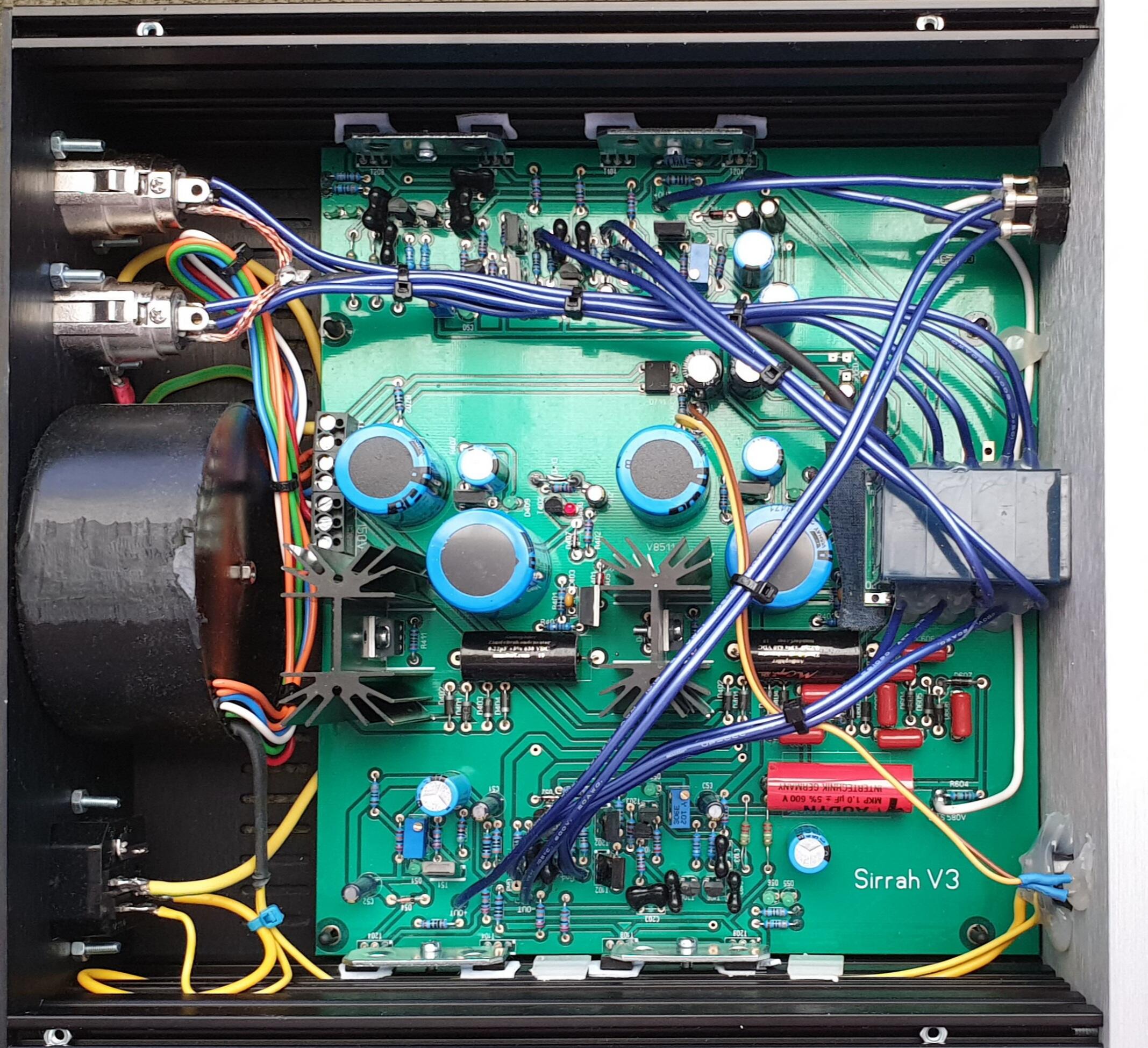

spritzer Posted September 3, 2020 Report Share Posted September 3, 2020 I wasn't sure about posting this but it kinda had to be done. Pic is from HF and the usual nonsense in the peanut gallery there: So this is the Sirrah V3 from high-amp.de...aka yet another slight twist on the Stax SRM-1 Mk2 or derivatives. For me it is just the build here and well... the total shitbox we have here. First off, what's up with all the hotglue? As somebody who has built hundreds of amps at this point... I don't even own a hotglue gun nor would I ever think of using this crap. Some other goodies, top of the transformer sanded for it to fit in the chassis, no insulation on the mains plug which means this would fail even the basic CE tests, nice bit of cloth underneath the pot there to presumably stop it from shorting something on the board and I just love all the transformer leads, not twisted in any way, coming really close to the input wiring. The hand cut heatpads on the output transistors are also nice and I very much doubt that tiny ballast resistor for the bias supply is rated to 600V.... On top of that, look up the design of this thing. Basically a SRM-212 with a full size power supply and some things changed. +/-200V rails, no CCS for the VAS stage and very little power. 1 1 3 1 2 Quote Link to comment Share on other sites More sharing options...
sillie Posted September 10, 2020 Report Share Posted September 10, 2020 I am a owner of such a shitbox that spritzer seems to like so much. I don't understand much about electronics and maybe the assembled construction has some flaws, but who cares in a closed box? Much more important is, how it sounds. I had owned many amplifiers from stax before, but the sirrah sounds just great. Very strong bass, neutral sound and fine resolution. And the power is enough even for hearing loud. I think it is made for people with normal hearing, not for hearing impaired. Quote Link to comment Share on other sites More sharing options...
Sherwood Posted September 10, 2020 Report Share Posted September 10, 2020 41 minutes ago, sillie said: I don't understand much about electronics Neither do I, so I listen to those who do. I suppose the other approach is to just not care about things you don't understand. 4 3 Quote Link to comment Share on other sites More sharing options...
billqs Posted September 10, 2020 Report Share Posted September 10, 2020 2 hours ago, sillie said: ...who cares in a closed box? Much more important is, how it sounds. Well, if an electronic component is put together in a slapdash manner such that a cursory inspection reveals faults, what does that say about electronic issues that might pop up down the road that don't show up right away? Also, if a company/person doesn't show a lot of competence in building the amp correctly, how competent are they about how they install circuits? I'm glad it sounds good to you. I just hope it lasts. 1 Quote Link to comment Share on other sites More sharing options...
ktm Posted September 10, 2020 Report Share Posted September 10, 2020 The whole shaving off the top of the main transformer scares me. Insulation is there for a reason. 1st order of business, try NOT to kill the user. 4 Quote Link to comment Share on other sites More sharing options...
jamesmking Posted September 10, 2020 Report Share Posted September 10, 2020 (edited) On 9/10/2020 at 1:51 PM, ktm said: 1st order of business, try NOT to kill the user. try not to kill the user until AFTER they have finished paying for it Equal rights for electrons! they should be allowed to travel freely and not be constrained by insulation... If they want to travel through your heart it just their way of being loving and friendly.... they are so misunderstood. Edited September 12, 2020 by jamesmking 2 4 Quote Link to comment Share on other sites More sharing options...
Pars Posted September 10, 2020 Report Share Posted September 10, 2020 1 hour ago, jamesmking said: try not to kill the user until AFTER they have finished paying for it, and posted their inflated review on HF... FTFY... 6 Quote Link to comment Share on other sites More sharing options...
gepardcv Posted September 10, 2020 Report Share Posted September 10, 2020 9 hours ago, sillie said: maybe the assembled construction has some flaws, but who cares in a closed box? Anyone who doesn't want to be injured. That photo shows a device which is a hazard for (1) electrical shock, and (2) a fire. 1 Quote Link to comment Share on other sites More sharing options...
spritzer Posted September 11, 2020 Report Share Posted September 11, 2020 It's been quite a while since somebody has come in and told us to just ignore everything even close to negative because it "sounds good". Sure, good for you but those of us who have been here a while know that was also said about other amps which turned into an absolute clusterfuck so yeah, keep that in mind. So a couple of things things, this amp doesn't swing enough voltage to really work. Even the SRM-252S has +/-250V rails and that is really the absolute minimum for this role. Only the utter dog turd that is the SRM-D10 uses +/-200V rails but then again, the off the shelf opamps it uses can't handle any more. Now the issue is just how much volume are you using and is the amp clipping. Setting aside the issue of headroom, can the amp handle normal transient swings? Second, what does it bring to the table that a SRM-353X doesn't do and better? 2 Quote Link to comment Share on other sites More sharing options...
sillie Posted September 13, 2020 Report Share Posted September 13, 2020 You made me feel insecure with all your comments. I searched the internet for the inside of other amplifiers from stax and other brands on the market. What I found was: No insulation on the mains plug No twistet transformer cables Glue to fix parts and cables. And now I wonder what ist different there from the sirrah? Quote Link to comment Share on other sites More sharing options...

Oak Forest Audio Dood Posted September 14, 2020 Report Share Posted September 14, 2020 On 9/3/2020 at 1:48 PM, spritzer said: I wasn't sure about posting this but it kinda had to be done. Pic is from HF and the usual nonsense in the peanut gallery there: So this is the Sirrah V3 from high-amp.de...aka yet another slight twist on the Stax SRM-1 Mk2 or derivatives. For me it is just the build here and well... the total shitbox we have here. First off, what's up with all the hotglue? As somebody who has built hundreds of amps at this point... I don't even own a hotglue gun nor would I ever think of using this crap. Some other goodies, top of the transformer sanded for it to fit in the chassis, no insulation on the mains plug which means this would fail even the basic CE tests, nice bit of cloth underneath the pot there to presumably stop it from shorting something on the board and I just love all the transformer leads, not twisted in any way, coming really close to the input wiring. The hand cut heatpads on the output transistors are also nice and I very much doubt that tiny ballast resistor for the bias supply is rated to 600V.... On top of that, look up the design of this thing. Basically a SRM-212 with a full size power supply and some things changed. +/-200V rails, no CCS for the VAS stage and very little power. AHHHH It's 650 EURO's for the shit box! An I've owned some shit boxs of DOOOOOOOOM [no relation to the BAD Mother F****** Drag Car under the same name] and I've lost a few headphones to said shit boxs. So I can't say I'd want to get into eStats with something so poorly built... Plus That's the same USD cost as a SRD-7 from @spritzer I guess yea you'd need get a power amp to put behind it. An the one I see recommend alot is like what... $150-200ish? So total cost of $900 or so But apparently you can still get a SRM 323S for like $525ish plus shipping so still cheaper than that thing...what's the consensus here around the 323S? Quote Link to comment Share on other sites More sharing options...
naiy8oaY Posted September 15, 2020 Report Share Posted September 15, 2020 14 hours ago, OakForestAudio said: AHHHH It's 650 EURO's for the shit box! With a little patience, that's enough for a 2nd hand SRM-727. That really makes that Sirrah a bad deal. 1 Quote Link to comment Share on other sites More sharing options...
