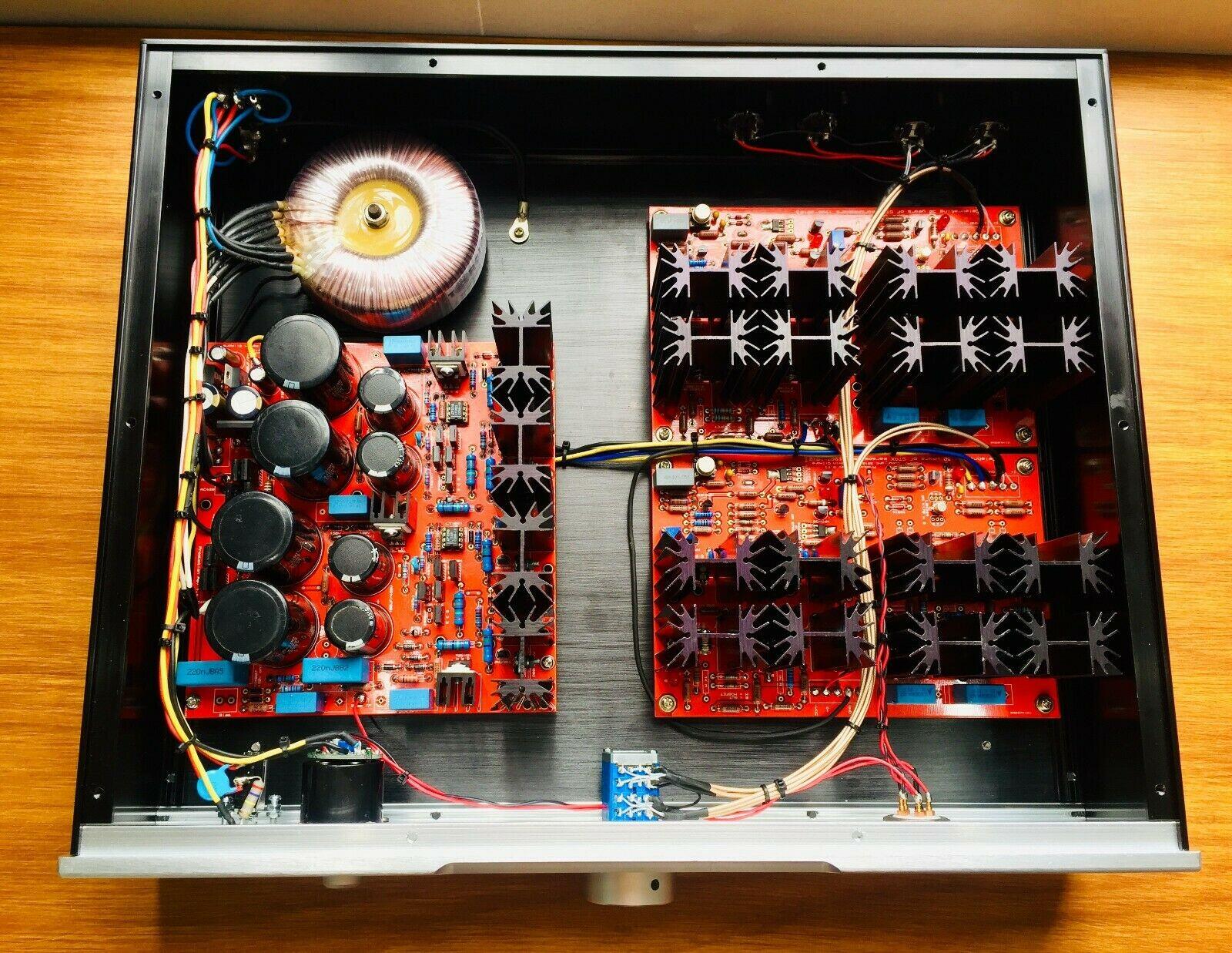

spritzer Posted August 6, 2020 Report Posted August 6, 2020 Ahh my ebay feed is such a rich source of crap. Now this: https://www.ebay.com/itm/184390225946?_trksid=p11021.c100851.m5053&_trkparms=aid%3D1110006%26algo%3DHOMESPLICE.SIM%26ao%3D1%26asc%3D20170803121420%26meid%3D7c8a959dd9b44639b572f30ba9d29c74%26pid%3D100851%26rk%3D4%26rkt%3D4%26mehot%3Dnone%26b%3D1%26sd%3D143674134487%26itm%3D184390225946%26pmt%3D0%26noa%3D1%26pg%3D11021%26algv%3DDefaultOrganic&ul_noapp=true Pics here for when the listing goes down. Standard KGSSHV but with a few twists: Notice that their are no terminal blocks which is bad but one bonus, this amp will kill your headphones. Can anybody spot it? It's not the twisted output leads which are a terrible idea... The bias is tied to the "bias tp" which is just for measuring the bias... before the ballast resistor!! So yeah, no ballast so say goodby to your diaphragms. Quote
ilikebananafudge Posted August 6, 2020 Report Posted August 6, 2020 (edited) Spritzer, these posts make me feel like I should only ever buy amps from you or Justin. Edit: forgot to include ecp audio! Edited August 6, 2020 by ilikebananafudge Quote
