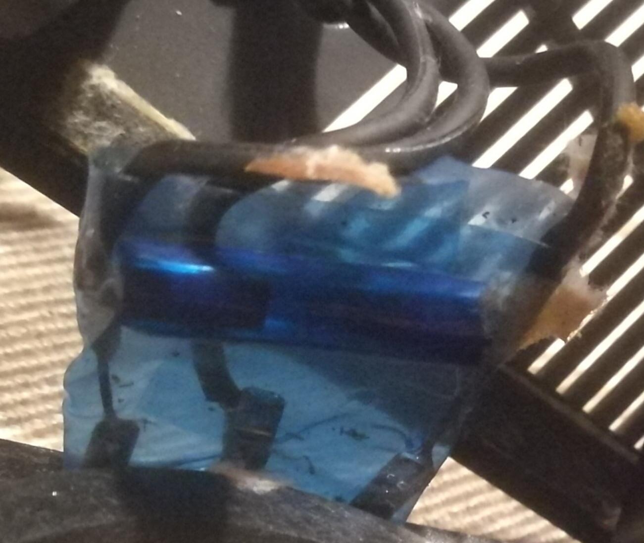

federicopol Posted February 10, 2019 Report Posted February 10, 2019 Hello, i am new here and since the Mafia reside here... i'm gonna ask for a help to the Padrino or some of his associates.... I recently bought a sra-12s that needs some love (a recap, a pot cleaning and an adding of a pro bias out), i got a discount on the original asking price and i got gifted a pair of stax sigma Normal bias ("because i don't know what to do with them if i sell the amplifier"). The Sigma are really ok, the drivers are ok, they simply need a cleaning AND a new damping because the original glass wool dampening have been removed. My question is: What can i use for remake the dampening? (I llan to use quilt batting, is that ok?) What shape the dampening should have? (Should i cover all the planes except the driver one, am i right?) And there seems to be a pair of resistor attached to the cable connecting the driver, are they normal? Thank you very much. Quote
spritzer Posted February 10, 2019 Report Posted February 10, 2019 Those are actually silistors and I'd remove them at this point. They don't age well and at 30+ years old... jut them off. The damping is on all sides of the housing and needs to be very dense or it won't work at all. 1 Quote

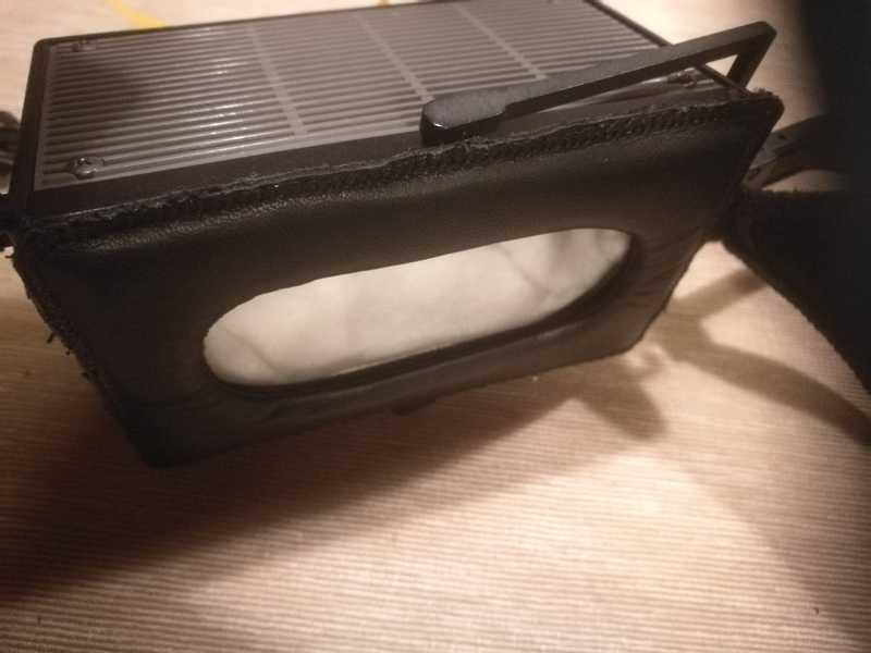

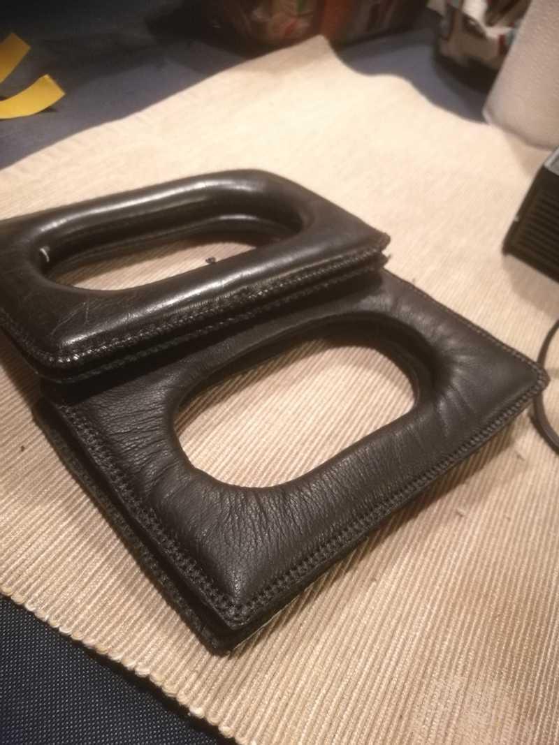

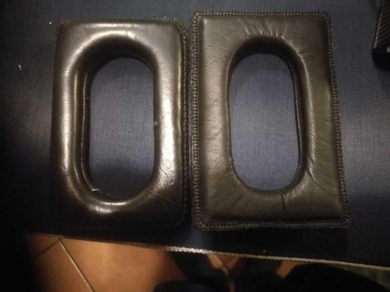

federicopol Posted February 12, 2019 Report Posted February 12, 2019 Hello, while i wait for some parts for restoring my sra12s i made some new earpads for my sigmas. I also made the internal dampening. Following the advice of Spritzer i used the most dense material i could find. By pure luck the material and quantities i used seems to be ok. The soundstage seems here, definitely the best of the headphones i own. The bass is present and clear so i am pretty happy of the final result. I decided to substitute the earpads because i don't feel comfortable using earpads that have been used by someone else for 30 years... I decided to not use a spare pair of lambda earpads because of the different shape of the lower back part. I made them in leather following the procedure Stax (or their supplier) probably used. I used an embroidery machine to sew the ear oval on the reverse side of fabrics, then i reversed the fabrics. With the fabrics now on the right side i added some low heigh memory foam cutted a couple of mm smaller than the finished earpad. Now i used the embroidery machine to close the earpads. Cutted the excess leather and here they are. They are a bit bigger than the original ones and are less stuffed, nothing dramatical but i will remade them the next time i have time to use the embroidery machine. The same method can be used to make them with a sewing machine for the oval and an overlock machine using 3 threads and a short lenght stitch. 7 Quote
