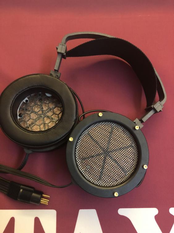

bwck2000 Posted February 5, 2019 Report Posted February 5, 2019 I have just made a prototype of my O1 clone. Now I am working on standardizing the procedure of making this headphone as well as its headphone box so that it doesn't look DIY 8 Quote
Sisterray Posted February 5, 2019 Report Posted February 5, 2019 Beautiful work! Your clone reminds me that I’m looking for some DIY approach to replacing the “headgear” of my 207 earspeakers. Outstanding transducers, cheap-looking execution. I often fear I’m going to break something by simply handling them. I don’t want to change the transducer housings, just everything else. The pads will be changed to the leather 507 pads in a couple of months. Quote
chinsettawong Posted February 5, 2019 Report Posted February 5, 2019 54 minutes ago, bwck2000 said: I have just made a prototype of my O1 clone. Now I am working on standardizing the procedure of making this headphone as well as its headphone box so that it doesn't look DIY They don’t look like DIY to me. Well done! Can you tell us more about it? What is the dimension of the driver? Quote
bwck2000 Posted February 5, 2019 Report Posted February 5, 2019 5 hours ago, chinsettawong said: They don’t look like DIY to me. Well done! Can you tell us more about it? What is the dimension of the driver? black-anodized CNC aluminium case, sheep skin with memory foam earpad, copper electrode with 25% more open area than typical stax models, carbon fiber skeleton on the electrode and plastic parts made of industrial grade 3D-printed nylon. The electrode design is similar to the omega driver I posted eariler in this thread. Regarding the diaphragm and the coating, I can't speak too much but the coating is nothing similar to what you can buy in Walmart or Amazon. the diaphragm's active area is 90mm. The sensitivity is similar to 007 but lower than that of 009. Its sound quality is very interesting. its tonality is similar to 007mk1 and less darker but the clone's detail revival ability and soundstage size surpasses 009. The only weakness I noticed is the bass. 007 gets more punchy bass and some people might prefer how the bass is presented on 009 more. IMO stax sacrifice quite a lot of other aspects of sound quality to produce a better bass on its top model. 3 Quote
