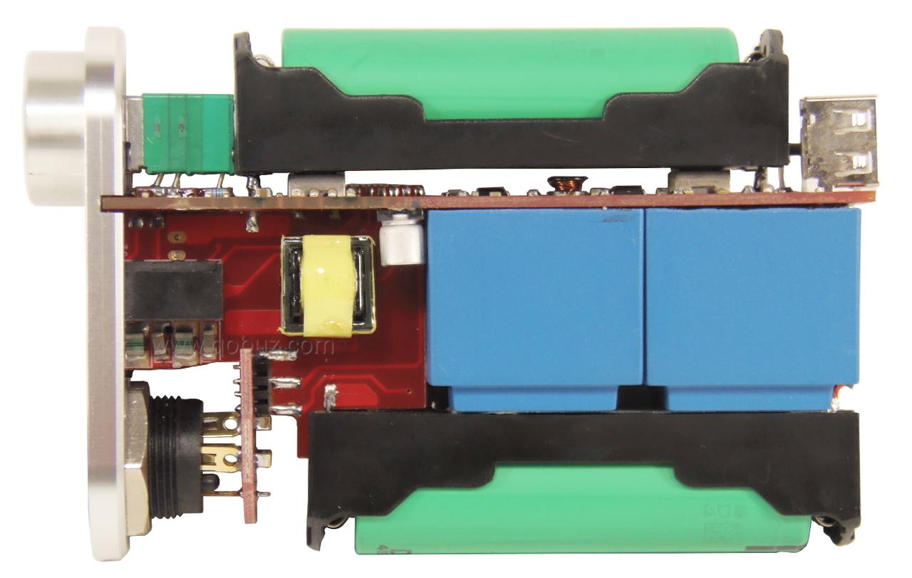

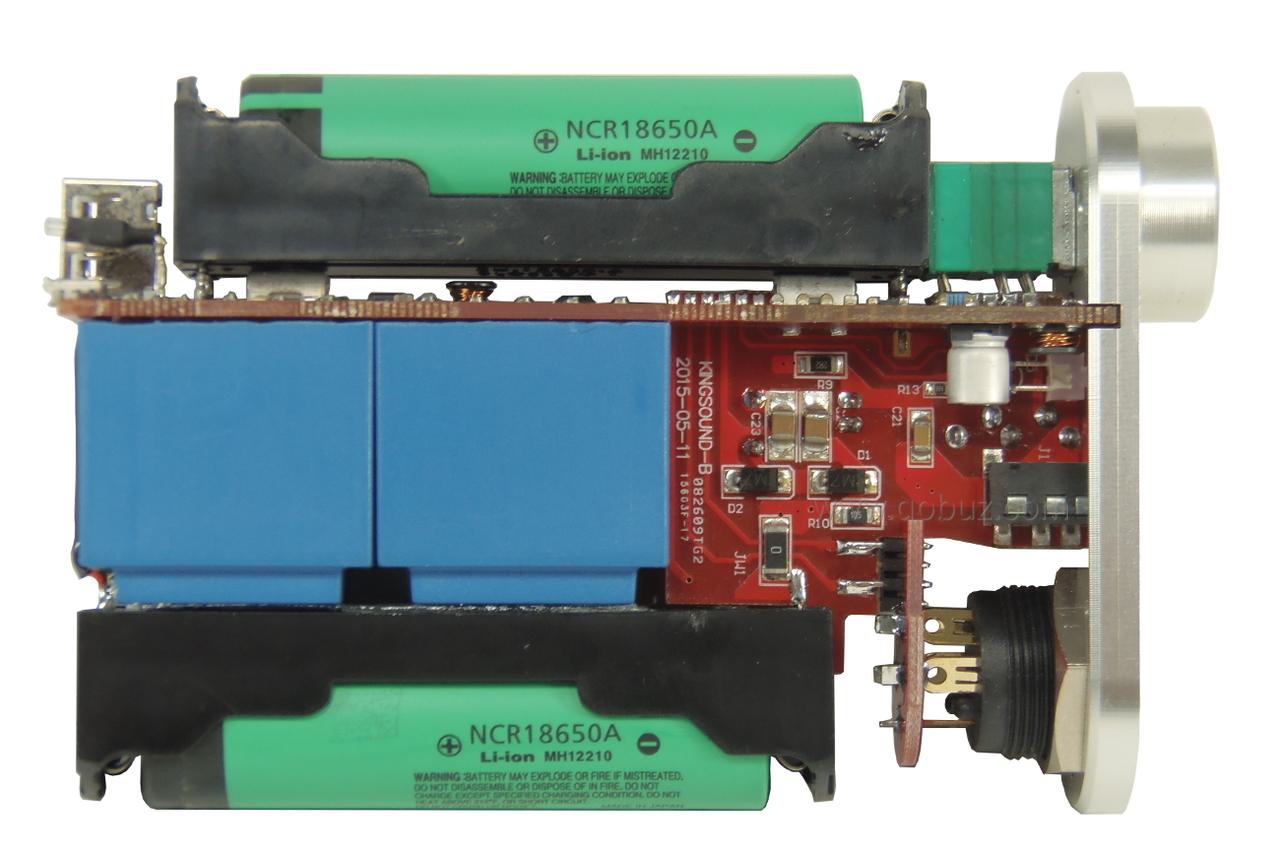

Well isn't this glorious...  ;)
Couple of chip amps driving the two blue transformers, real high quality stuff.  One thing I do wonder about, how did the bias drop down to 200V?   Here is a pic of the bias supply:
This is clearly a voltage doubler driven off the small transformer on the other side.  One quick issue, the ballast resistor is 1M so not a good idea to use this with Stax stuff....  Back on point, if the bias is +580V then there is no easy way to get 200V here unless you fit a voltage divider which could be a real problem with a supply like this.
