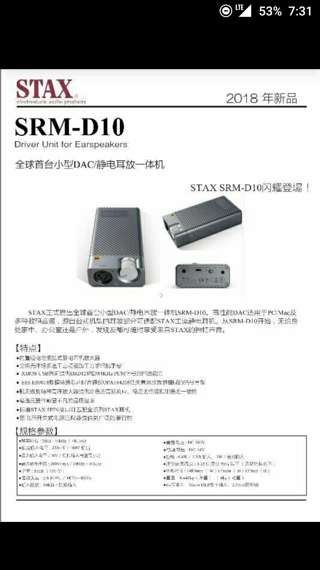

bwck2000 Posted February 11, 2018 Report Posted February 11, 2018 (edited) 12 minutes ago, spritzer said: I sold mine as I need to cut down on all these headphones... I did just buy two L300limited though for some unknown reason... I bought one before I heard someone who have gone to the 300ltd audition in Japan. He said there are noticeable differences between 700 and the ltd. Maybe its just electrode changes, not the diaphragm. I somehow regreted but anyway its just a collector's item, sound quality doesn't matter that much. What a silly idea to have electrostatics portable. Edited February 11, 2018 by bwck2000 1 Quote

padam Posted February 11, 2018 Report Posted February 11, 2018 2 hours ago, bwck2000 said: What a silly idea to have electrostatics portable. I guess it is better than the SRD-X Pro (at least it should be), certainly a lot smaller and with a DAC as well. Time to bring out those Sigma Pros to the streets. Quote

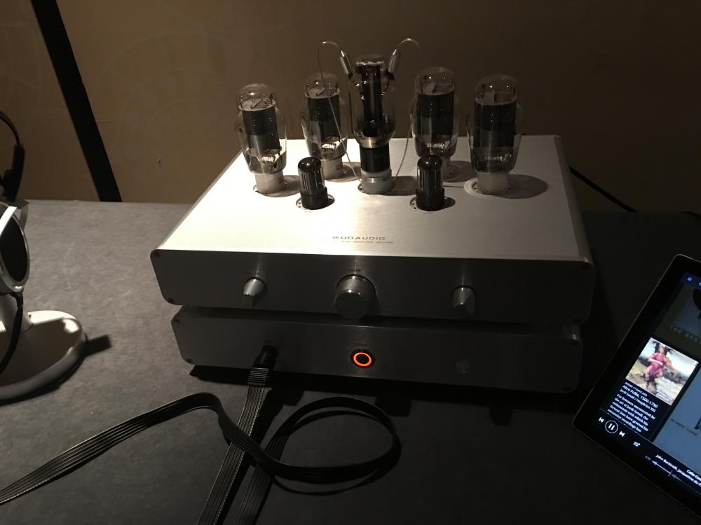

SeaWolf Posted February 19, 2018 Report Posted February 19, 2018 This was posted at the other place but I figured it should be put here too, credit JimL11 for the pic/original post. 300b s seem to be trending.. Quote

JimL Posted February 19, 2018 Report Posted February 19, 2018 So, a little more on the new Woo amp. One 6SN7 per side, two 300B outputs, "proprietary output technology." The Woo person refused to say any more about that, except he said the GES was output plate resistor and the WES was output chokes - common knowledge, and implied that this wasn't either of those. My BS sensors were on at that point. I asked about how they got enough gain and he was not forthcoming about that either. Forgot to ask if they are still using passive power supplies. Also, didn't notice at the time, but although it looks like the amp is the upper chassis, the headphone jack looks like it is coming out of the lower chassis, where the power button is. Don't know what that is about. Quote

kevin gilmore Posted February 19, 2018 Report Posted February 19, 2018 so the options for the new woo amp 1) plate resistors, they already said its not this 2) inductors, they already said its not this 3) center tapped inductor, you get about 6db of gain with this. 3a) push pull output transformer. all sorts of issues with gain and power with this 4) solid state current source maximum voltage gain of 6sn7 is about 20, maximum voltage gain of 300b is less than 4 somewhere there are likely to be input/interstage transformers and then you are still going to have trouble getting to a voltage gain of 500 or more if you want some feedback to reduce the distortion. the viva evidently is also low on gain, and uses and output transformer. why people produce shit like this I do not know 2 Quote

JimL Posted February 19, 2018 Report Posted February 19, 2018 19 minutes ago, spritzer said: We clearly need to come up with some crazy expensive amps to compensate for all of this. The insane Carbon is already planned and so is my version of the T2 but I'm going to be the very last with that one... This has transformer coupled written all over it for me. Even if they were to drive the 6SN7 and 300B's within an inch of their lives... simply no way to get the gain needed. Also Woo have never done anything even remotely novel, it's all cookie cutter crap done to the lowest possible standard. Case in point, feeding the output through to the PSU for some reason... Edit: Kevin reading my mind yet again. I'd say go the full hog, input transformer with stepup and splitting the phase into the 6SN7. Again stepping it up with transformers into the 300B's and then transformers yet again on the outputs. Might just get enough volume out of it that way... I asked about transformers and the Woo guy said no, but he may have thought I was only asking about output transformers. Quote
