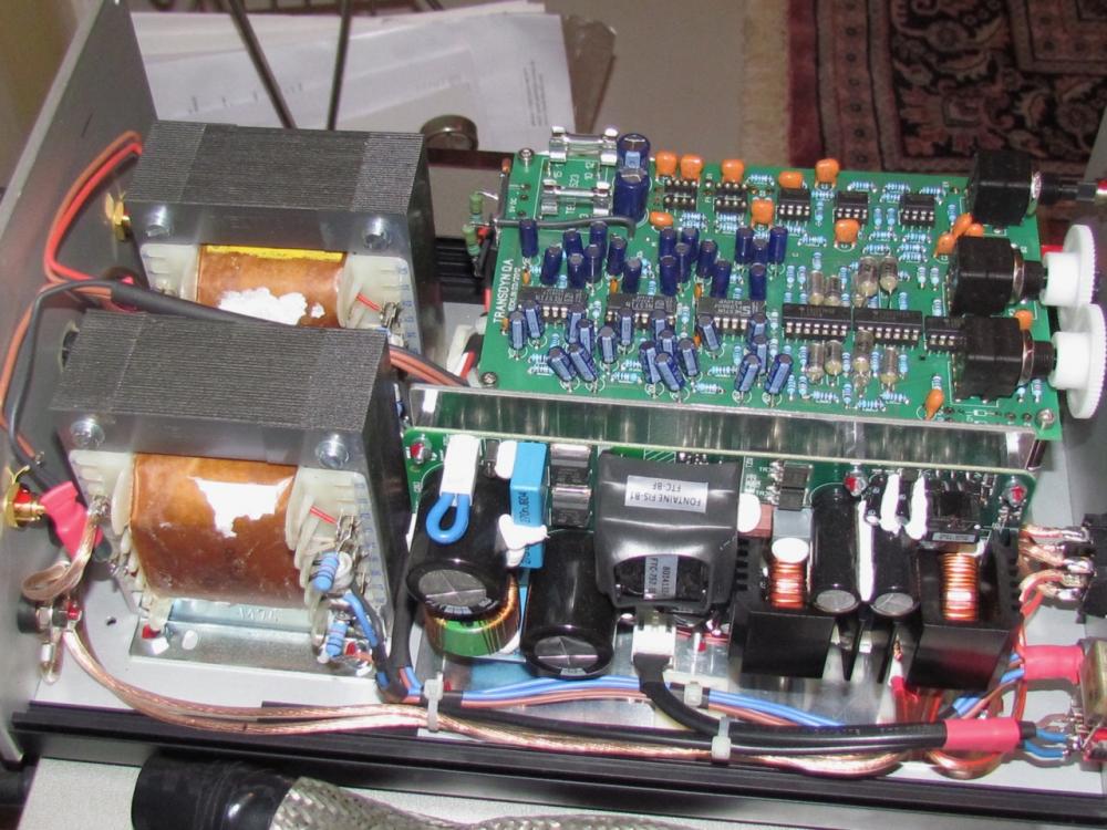

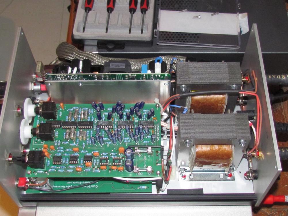

spritzer Posted October 9, 2017 Report Posted October 9, 2017 (edited) I just loved to see the inside pics of the "best electrostatic amp in the world" over on HF, the QA Jecklin Transdyn. So it's a badly built EQ board with a B&O IcePower 125ASX2 power amplifier module and a couple of cheap looking transformers. Also locating those two transformers side to side... yeah there will be some crosstalk. Edited October 9, 2017 by spritzer 1 Quote
GeorgeP Posted October 9, 2017 Report Posted October 9, 2017 Am surprised he actually posted these pictures instead of falling into a deep depression after realizing he paid thousands for it... Quote
kevin gilmore Posted October 9, 2017 Report Posted October 9, 2017 The volume pots are likely to be linear instead of log because one pot spins the other direction due to the gears 2 active bandpass filters per channel and 3 compand/expand per channel. Lots and lots of signal thru those electrolytics. So maybe an attempt at a near field equalizer? $4k euros for this. very sad 2 Quote
spritzer Posted October 9, 2017 Report Posted October 9, 2017 To take this pics and post "best amp evah!!" shows a special level of something... Some things stand out for me, the total lack of heat shrink on the mains switch which means the CE rating doesn't stand up to scrutiny. Also just the sheer level of hacking going on. Parts suspended in mid air and other marks of quality. Also just the general lack of giving a fuck... Quote

spritzer Posted October 10, 2017 Report Posted October 10, 2017 First off, anybody who plugs anything Stax into that box deserves the Darwin award, plain and simple. Going by that the new Floats are supposed to be compatible with the old ones we are dealing with a bias of +1500V... yeah...just about three times that of the Stax. Maybe they lowered it but I some how doubt it as those drivers need a lot of bias to work. That "Thinker" (the irony is palpable) states over and over again that the bias is 800V but how was that verified. Perhaps by measuring after the (32M) ballast resistor? Then we have the transformers, Stax used a ratio of 1:25 but Jecklin...1:120. So, even with a low input you are overdriving the fuck out of the Stax. I guess that is one way to get a "meaty" impression... Quote

kevin gilmore Posted October 10, 2017 Report Posted October 10, 2017 (edited) more than just an equalizer, there are 3 companders/expanders in there. so something like a stax ed1 plus a dbx3 (or possibly 3 band equalizer each feeding a compander/expander) for those not familiar with dbx... this thing http://www.ebay.com/itm/DBX-3BX-3-Band-Dynamic-Range-Expander-PARTS-OR-RESTORATION-ONLY-/202076549539?hash=item2f0cb371a3:g:T1IAAOSwm9tZ2pji one of the pictures over there shows the bias board partially populated, so the bias might be as low as 600v, who knows Edited October 10, 2017 by kevin gilmore Quote

dsavitsk Posted October 13, 2017 Report Posted October 13, 2017 $1400 seems high for $80 worth of transformers. On 10/9/2017 at 4:58 AM, spritzer said: Also locating those two transformers side to side... yeah there will be some crosstalk. Doubtful. But even if there is, there will be considerably more across your head. 1 Quote
