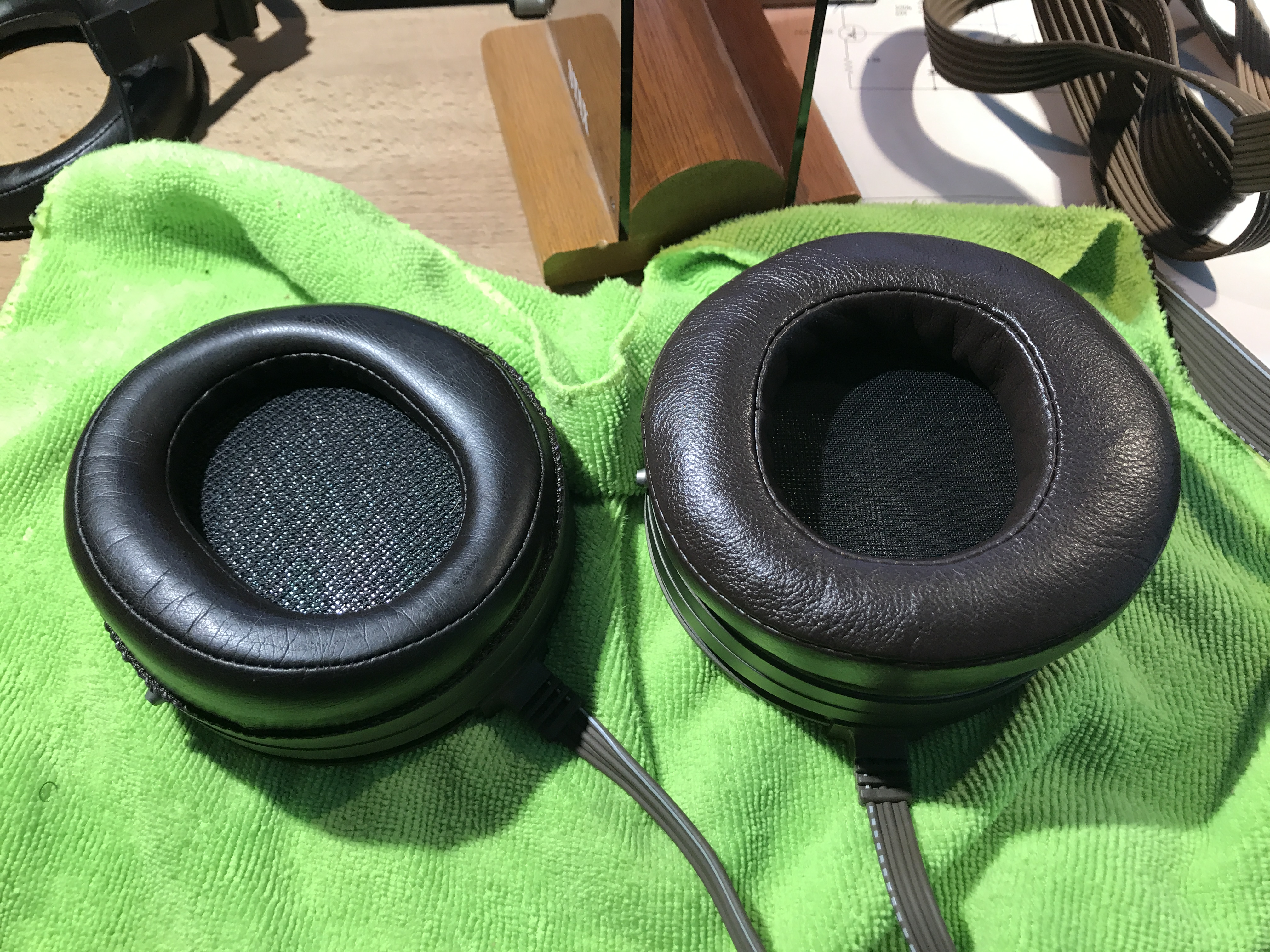

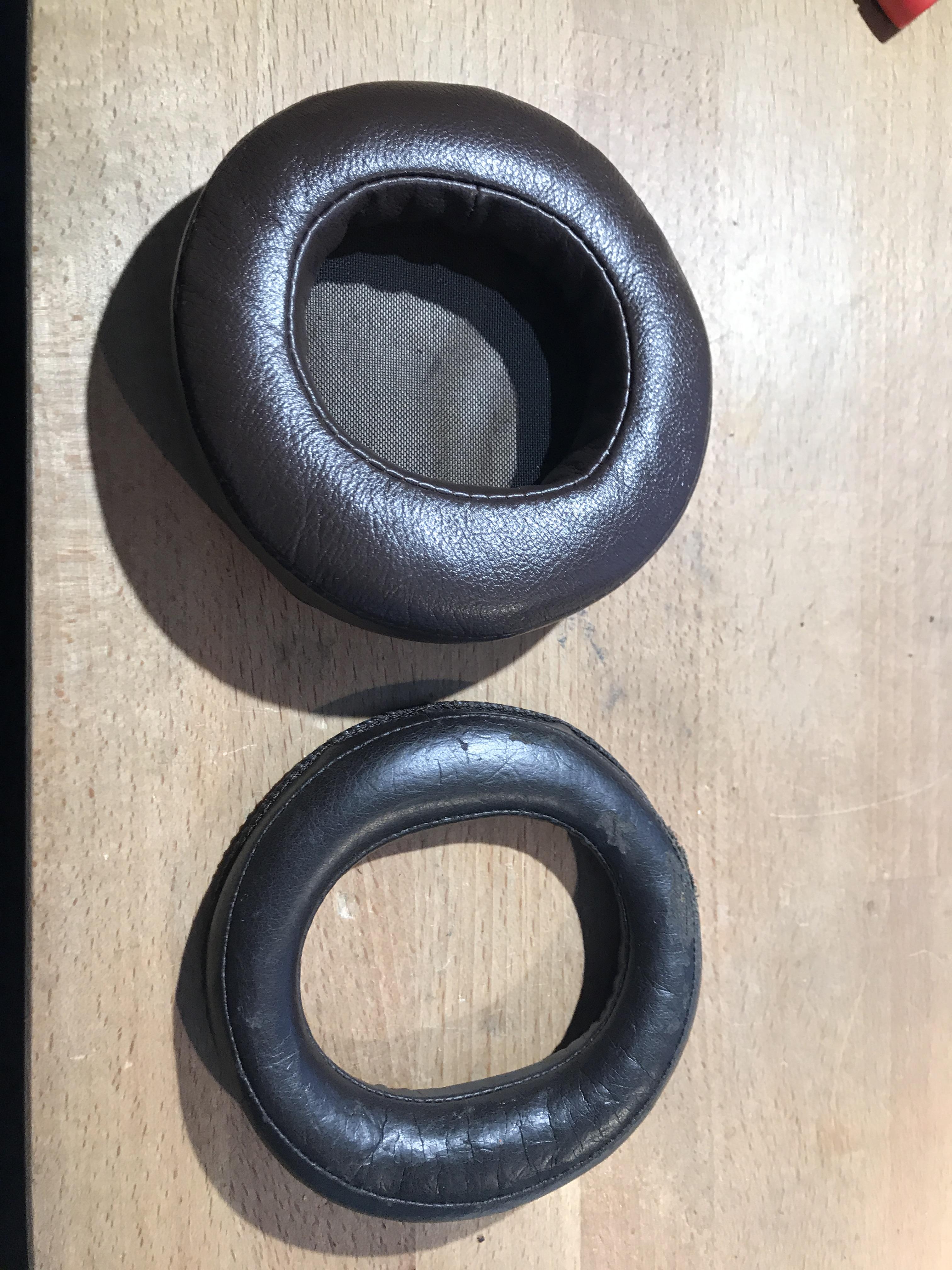

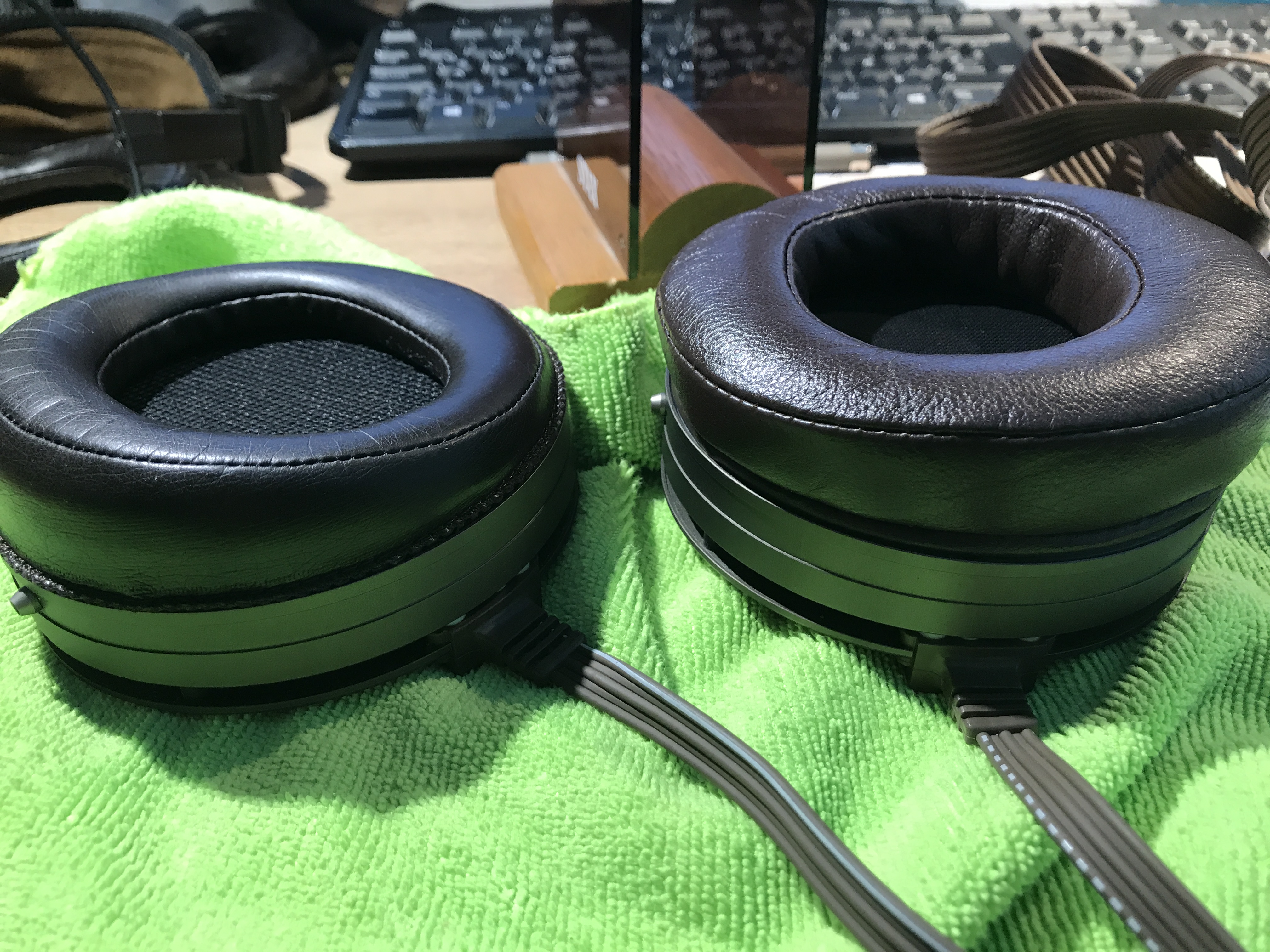

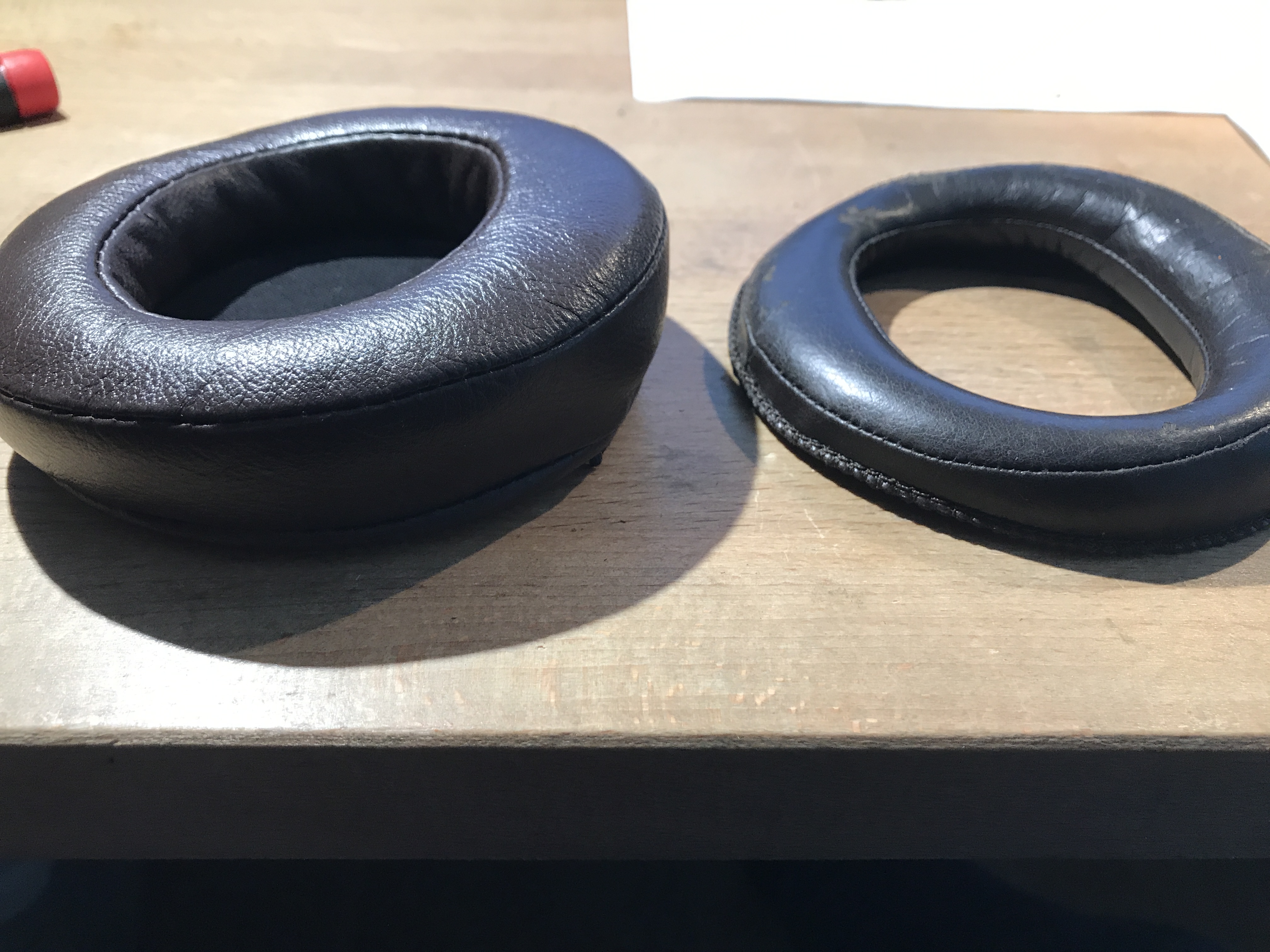

spritzer Posted June 7, 2017 Report Posted June 7, 2017 Hmmm I don't think I removed the loop out on any of ones I've done. Pop the hood and I'd know... In other news, as the SR-Omega owners know all to well...there are no more replacement earpads and the old ones are pretty much awful. Any set with the stock ones will be mimicking a block of wood by now and the replacements Stax used to sell were pretty fucked as they were just wrong. First of all they were black and then the dimensions were also wrong. They are all gone now as well so what to do... Well take a crusty set of earpads and re-engineer some new ones with the company that is making the earpads for my headphone project. Now they are real leather with memory foam. They are also thicker as they are much softer and the opening was made smaller to control the bass issues if the SR-Omega. Now this is the just the first prototype but what an utter fucking pain in the ass to install. I've sourced the pins Stax used and I'll order some new mounting rings for the next batch but yeah, not easy to install. Something I'm not sure can be changed but we'll see. Here they are mounted to the headphones: Yup, the "old" earpads are new old stock but mine won't last forever. Now how does it sound...bloody brilliant and they are so much more comfortable. Some more listening to be done on my part but some of my issues with the SR-Omega have been greatly diminished. 11 Quote

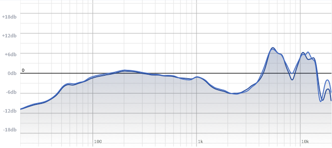

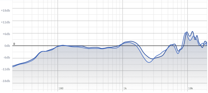

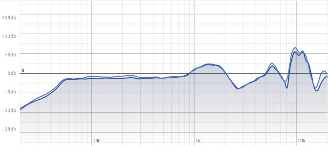

RudeWolf Posted June 9, 2017 Report Posted June 9, 2017 Here's how the Staxen I had measured. Lambda Pro Lambda Nova Classic For reference - HD800 Overall the Pro sounded more anemic and I preferred the LNC. The earlier roll-off is clearly audible. 1 Quote

morphsci Posted June 9, 2017 Report Posted June 9, 2017 3 hours ago, nopants said: if you have any extras i'd love to take a pair off your hands. i feel like the nos pair i found is a priceless antique at this point. how does it change the presentation? Yep I would love to try a pair as I can see the end of the rainbow for the pair of pads currently installed. Quote
spritzer Posted June 9, 2017 Report Posted June 9, 2017 This is the only set I have now but the plan is to have more made and keep a few around should people need them. They are not cheap though... Nothing terrible but my DIY phones project is running into silly money... In terms of the presentation, it is pretty much the same as the stock pads. They have so little padding that it made sense to make thicker pads and have them compress more. This is what Stax did with the 007's so it carries nicely onto these. There is maybe a smidge more bass control with these but it's hard to say. The bass is still a bit loose and the treble can bite a bit so regular SR-Omegas to these ears. 1 Quote
