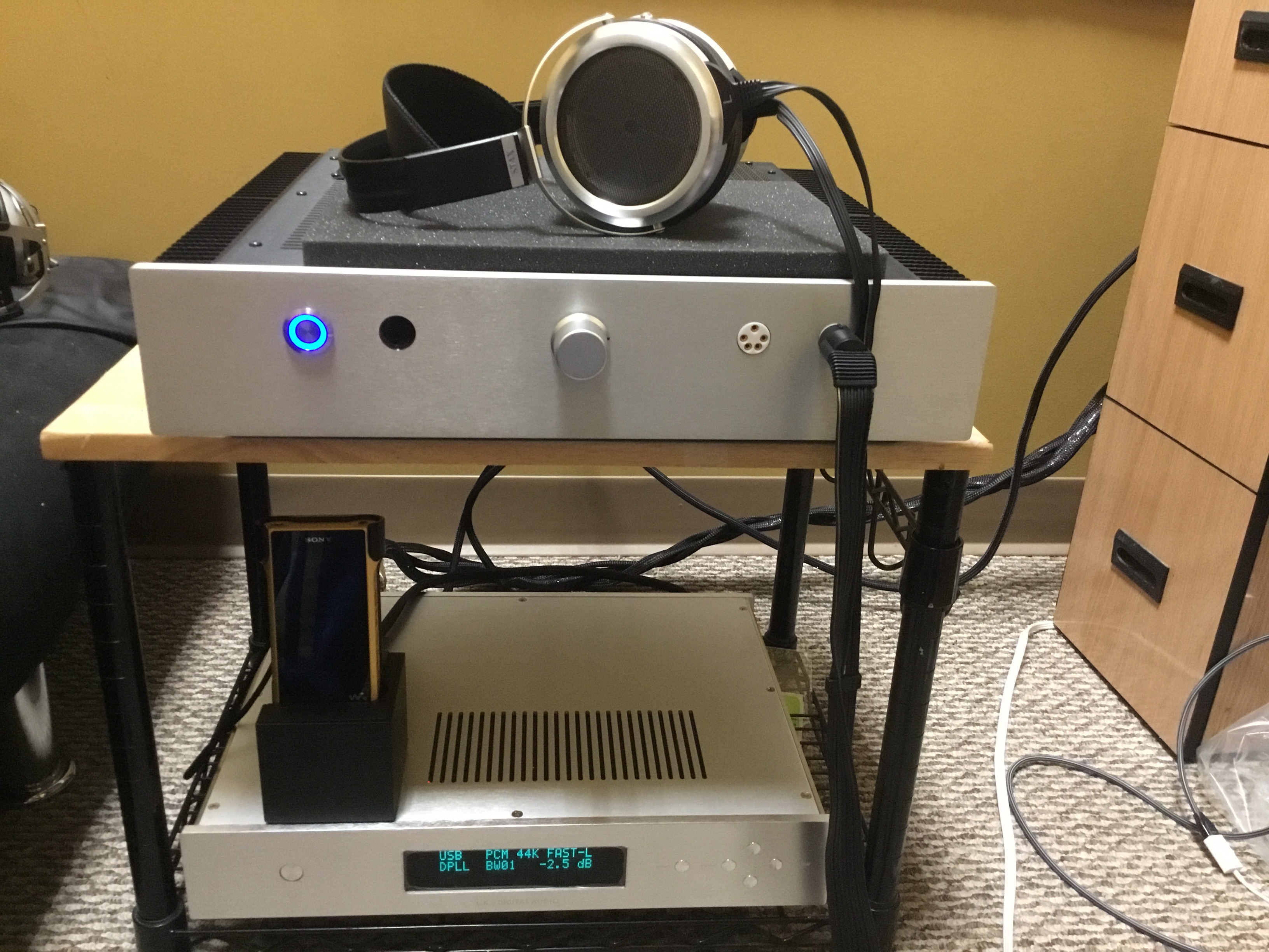

Whitigir Posted March 30, 2017 Report Posted March 30, 2017 I grabbed my DAC to go with my Carbon and new found addiction about Stax ! such expensive and dangerous Addiction 2 Quote
kunalraiker Posted March 30, 2017 Report Posted March 30, 2017 6 hours ago, Whitigir said: I grabbed my DAC to go with my Carbon and new found addiction about Stax ! such expensive and dangerous Addiction Nice brushed aluminium setup. Iam a huge Stax fan too. I have the 007 MK1 and waiting for a new amp. So currently without an amp. Musical bliss the stax, if you do decide to upgrade get a higher end DAC and things will change dramatically. Quote

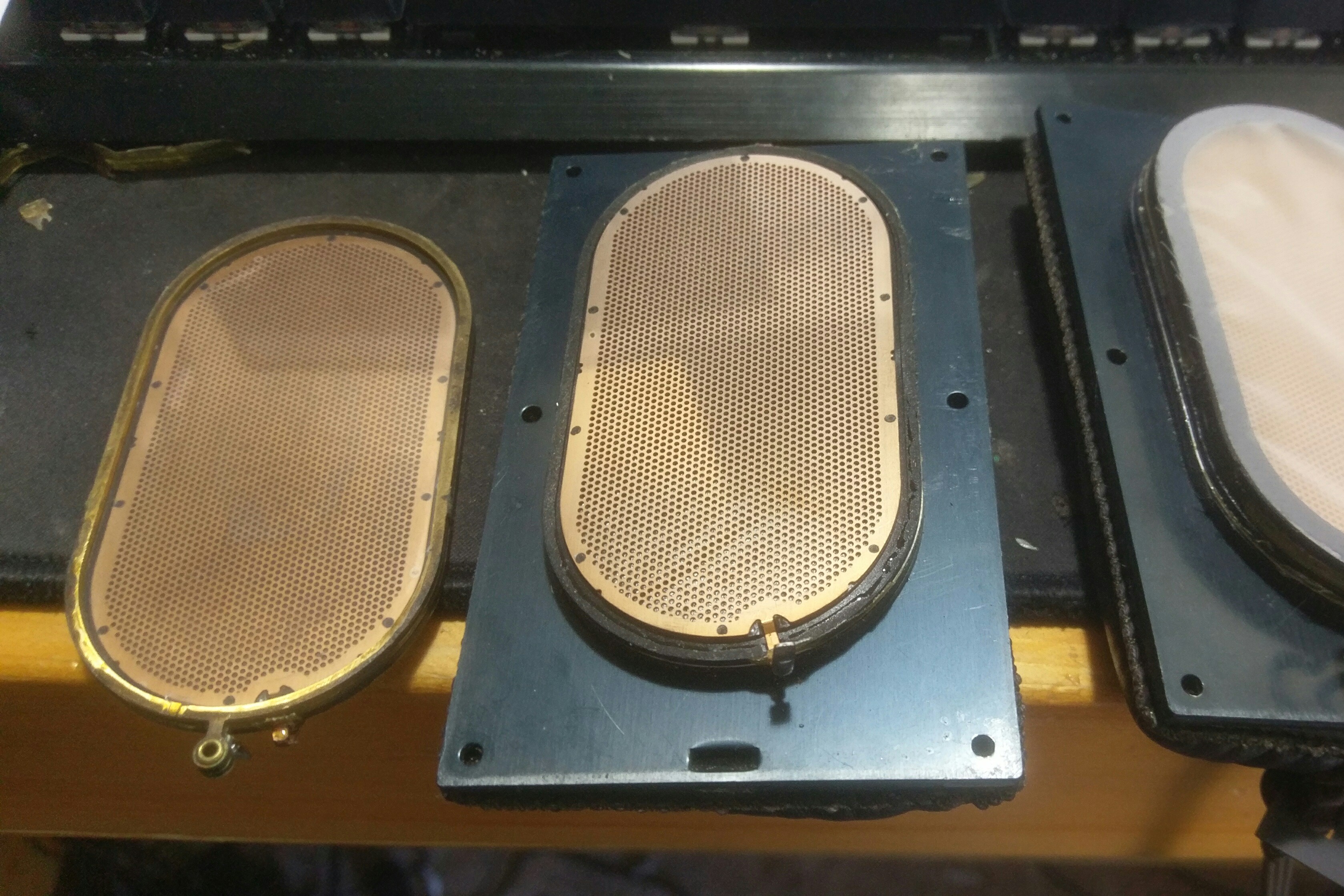

Arthrimus Posted April 7, 2017 Report Posted April 7, 2017 (edited) Now that all fear of taking apart Lambda drivers is gone I went out and acquired a Lambda Signature with channel imbalance. Drivers came apart just as easily (not incredibly easy) as my LNS driver. Recoated and singing beautifully. Lambda collection intensifies! Edited April 7, 2017 by Arthrimus 3 Quote

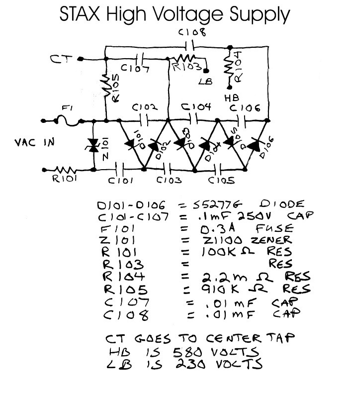

alcofribas Posted April 9, 2017 Report Posted April 9, 2017 Greetings, headcases, this is my first post. I've gone through this whole STAX thread with mounting alarm. First I learned that Woo WEEs were badly designed and had the potential to destroy cans. And then that it seems that it had actually happened several times! There are not many engineering projects that are simpler than designing a transformer/biasing box for electrostatic headphones. How could somebody get this so wrong? This doesn't raise my esteem for the average designer of boutique HiFi gear. So what's to be done? My first idea was to insert 4.7Meg resistors in series with the bias output, but maybe this is not sufficient. Later in the thread Birgir talked about putting his own biasing board. Did somebody ever trace the schematics for the WEE? Have there been variations during production? Has anybody written up the procedure to make them safe? I'm a speaker guy with a budget, and not a heavy heaphone user, and a KGSS or whatever is out of the question for now. The WEE seemed an excellent choice for me, since I own two high quality speaker amps, and an SRM-323 (mine's a 323II FWIW) won't drive my Birgir-modified Sigmas properly. I hit on the Sigmas five years ago after I Googled "headphones for people who don't like headphones" and really that's what they are and I love them. I haven't opened the WEE yet but it's disconnected now... 1 Quote
mypasswordis Posted April 10, 2017 Report Posted April 10, 2017 Sigmas are 6 pin normal bias so you shouldn't be able to plug them into an SRM323... Google Stax SRD7 schematics, then open up the WEE to compare. And read this: http://www.head-fi.org/t/677809/the-stax-thread-iii/8880#post_12611558 Quote
alcofribas Posted April 10, 2017 Report Posted April 10, 2017 Thanks for the tip, but this posts seems to be specifically about the SRD-7... does anyone have the circuit diagram? I know what the bias supply looks like in recent Stax (active) energizers, but first and foremost I'd like to know how biasing is done in a WEE. I know that according to Birgir it's a voltage tripler, without any protection whatsoever. Once I know this (I hope someone traced the circuit before, else I'll do it myself) I have to decide wether to tamper with the existing setup, or change the biasing board, as Birgir did at least one. I said my sigmas are Birgir-modified, and in this particular case he put SR-303 drivers in there, so they are pro-bias. I know he has several Sigma-404s under the belt. Quote
Arthrimus Posted April 10, 2017 Report Posted April 10, 2017 (edited) This is what you want. I've built it several times. Only issue is R103 and R104 should be 4.7m. You probably want to replace the bias circuit in the WEE entirely if you want to be safe. Edited April 10, 2017 by Arthrimus 1 Quote
alcofribas Posted April 10, 2017 Report Posted April 10, 2017 Thanks a lot Arthrimus. Now's my chance to figure out how a voltage doubler works. Unless I'm completely out of it, your circuit is meant for 117V, right? Pondering over this circuit reminded me that the WEE has a voltage conversion switch... and something clicked in my head. What, do they have a transformer to handle AC in there? And it looks like it... talk about overdesign. At least this gives some kind of protection, same kind as razors in bathrooms. Maybe the cans are not well protected, but at least their users are. That's something. Quote
