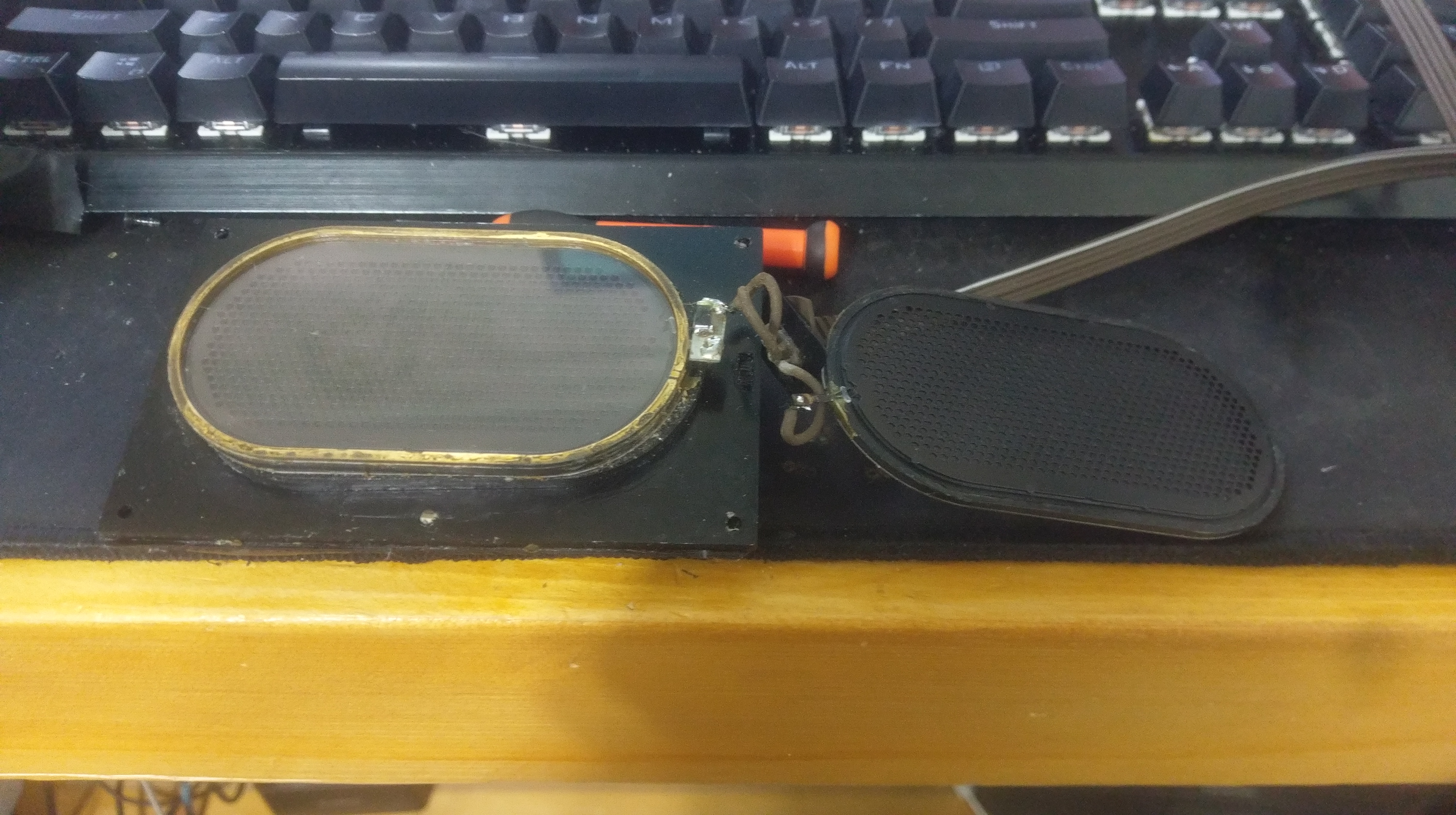

Tachikoma Posted March 24, 2017 Report Posted March 24, 2017 Wait, how did you crack the drivers open in the first place? Aren't they glued shut? Quote
DefQon Posted March 25, 2017 Report Posted March 25, 2017 (edited) They sure are, more like varnished shut and its a cunt separating the stators from the inner diaphragm ring without putting too much force potentially bending them. I learnt this the hard way with a LNS though it was already broken. Then I found it easier to clean off the varnish around the drivers first leaving a thin coat giving you easier access to the stator and diaphragm ring. Use a very thin, sharp and strong scalpel or surgeon's knife. Edited March 25, 2017 by DefQon Quote
Dusty Chalk Posted March 25, 2017 Report Posted March 25, 2017 2 hours ago, DefQon said: ...its a cunt separating the stators from the inner diaphragm ring without putting too much force potentially bending them. (squints) Mebbe we should rename this place to Cunt-Case. Quote
Arthrimus Posted March 25, 2017 Report Posted March 25, 2017 Well... The channel imbalance is gone. Thanks for the help Pirx and DefQon. Your posts gave me just enough information to get confident. The driver split apart just as expected and the recoat went without incident. They're singing properly for the first time since I've had them! 8 Quote
spritzer Posted March 25, 2017 Report Posted March 25, 2017 you did it correctly, don´t try to take apart the brass rings as it is just a pain Quote
Arthrimus Posted March 25, 2017 Report Posted March 25, 2017 (edited) 4 hours ago, Torpedo said: What did you use for the recoat? I used Endust antistatic gel. It's the same stuff I used to recoat my SR-5s a couple of years ago and it's held up fine. Edited March 25, 2017 by Arthrimus Quote
Torpedo Posted March 25, 2017 Report Posted March 25, 2017 Thanks! It's kind of paradoxical using an anti-static cleaner to coat electrostatic drivers. 1 Quote
DefQon Posted March 25, 2017 Report Posted March 25, 2017 What did you use to seal/glue the drivers back together? Quote
Arthrimus Posted March 26, 2017 Report Posted March 26, 2017 A very very thin coat of contact cement. 1 Quote
spritzer Posted March 26, 2017 Report Posted March 26, 2017 20 hours ago, Torpedo said: Thanks! It's kind of paradoxical using an anti-static cleaner to coat electrostatic drivers. It really isn't. The anti static stuff is just that as it creates a high resistance layer which is perfect for electrostatic use. Quote
Torpedo Posted March 26, 2017 Report Posted March 26, 2017 2 minutes ago, spritzer said: It really isn't. The anti static stuff is just that as it creates a high resistance layer which is perfect for electrostatic use. Sure, I get it, that's why I said "kind of" paradoxical. As I understand it, considering my very low knowledge, you want your electrostatic field to be perfectly controlled in intensity, to be the same on both drivers, and to be kept within the strict size of the material. An isolating layer can be very helpful to achieve that. Is the problem in the 009 losing its balance between channels related to this? Quote
