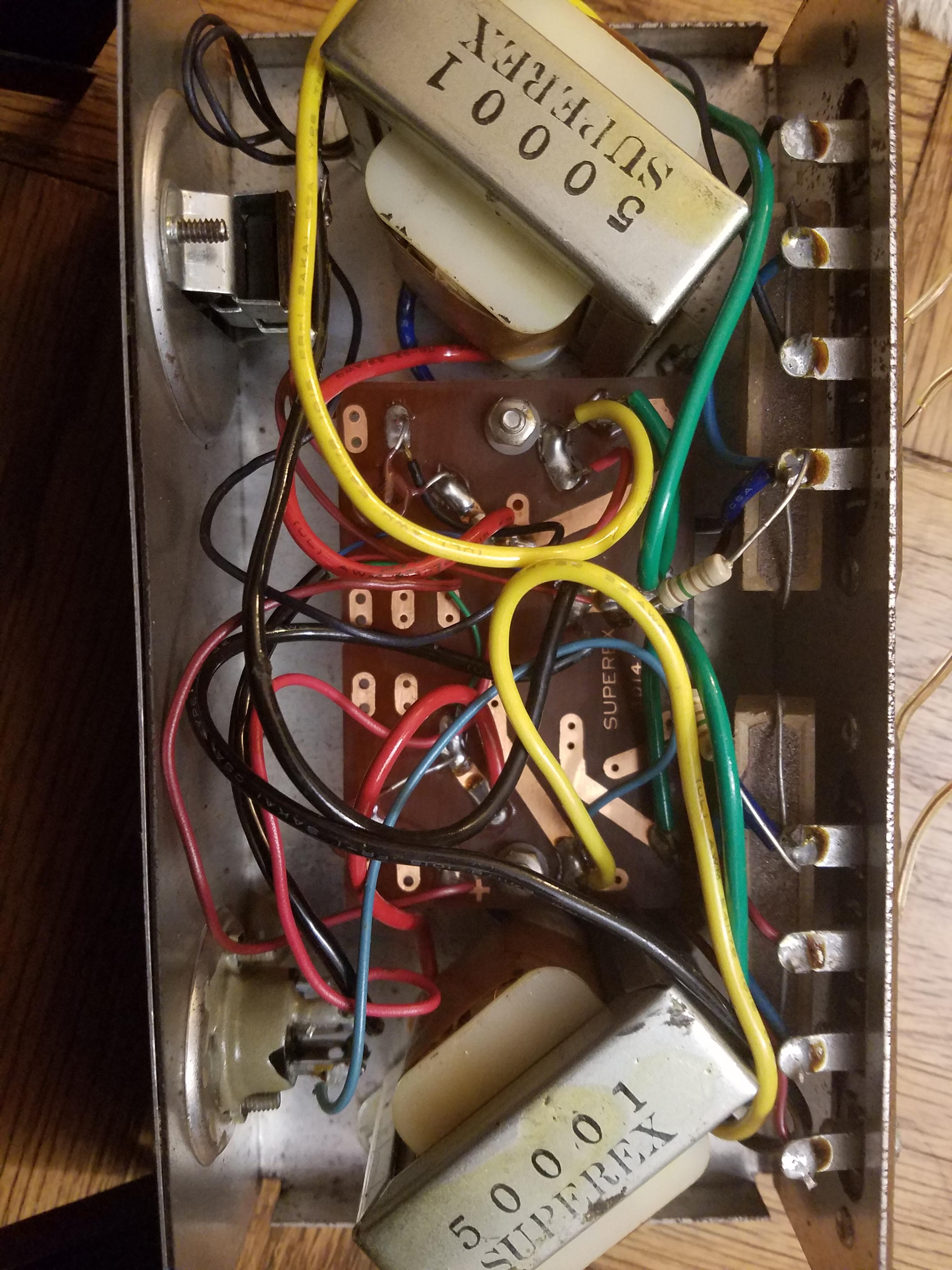

spritzer Posted February 14, 2017 Report Posted February 14, 2017 Ahh so these came with an energizer!! I didn't crack open the drivers to check but can you shoot a pic inside the adapter? Mine came with nothing like that... Black is clearly common so all drivers driven single ended. Quote
spritzer Posted February 14, 2017 Report Posted February 14, 2017 Excellent. Looks like green and yellow feed the transformers and blue and red from each of the yellow taps goes to the headphone socket as well. Output from the transformer seems to be black and red. Red going to the PCB where a cap is added as something (compensation perhaps) and then green and blue from the small black sheathed cable go the socket. Dynamic driven off the speaker taps with a single ended electret element.... Seems reasonable. Quote
wink Posted February 14, 2017 Report Posted February 14, 2017 (edited) Excellent indeed...... Edited February 14, 2017 by wink Quote
spritzer Posted February 14, 2017 Report Posted February 14, 2017 I'll hook up something to drive these or just fit some transformers in the earcups. Might be the easiest route... Quote
mypasswordis Posted February 14, 2017 Report Posted February 14, 2017 (edited) The earcups are massive but it's just enough to fit all the stuff that's already there, I don't think there's space to put anything else in If you can find one of the bespoke 5 pin Superex plugs to reterminate your EP5, I can hand off the energizer unit to you when you come to NYC and you can ship it back to me when you're done with it Edited February 14, 2017 by mypasswordis Quote

spritzer Posted February 15, 2017 Report Posted February 15, 2017 17 hours ago, mypasswordis said: The earcups are massive but it's just enough to fit all the stuff that's already there, I don't think there's space to put anything else in If you can find one of the bespoke 5 pin Superex plugs to reterminate your EP5, I can hand off the energizer unit to you when you come to NYC and you can ship it back to me when you're done with it I doubt I'll ever find the plug as it was molded. I might need the ratio of the transformer though at some point if my Suprex stuff doesn't have the same transformer. I might be able to squeeze a small mains transformer in there with the right ratio. 12 hours ago, kevin gilmore said: Best news ever yamas sucks Yup, the worst company ever. Their repair work is just legendary... Quote

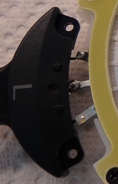

Laowei Posted February 19, 2017 Report Posted February 19, 2017 (edited) Replaced the cable in my SR-009 yesterday. They are playing great now. When soldering the wires to the stator and diaphragm tabs, I came across some details that I thought should be passed on. Desoldering all the wires and removing the old cable was not a problem. See the "Ants in My Stax" thread for 009 disassembly. Remove all the plastic parts mounting the cable to the ear pod, don't try to desolder the wires/cable with these in place -no room. On reassembly, first note orientation of the cable for each ear pod, The arrow on one side of the molded strain relief is to be assembled on the inside only (ear side) and will help ensure signal polarity between L&R channels. Soldering the +/- signal wires to the stator tabs was straightforward. Where it got interesting was when I went to solder the pro bias wires to the diaphragm tabs. The diaphragm solder tabs on my SR-009 are a small additional part that had been riveted to the actual diaphagm. The right side rivet was well attached and the wire/tab easily soldered. But the left side rivet was loose and the tab rotated wildly when I touched it with my solder tip. Took some doing, but got it soldered. Then to double check when done, I measured the continuity of each wire from solder tab to cable pin. All measured 0.01 ohm, except the left bias wire. That measured ~25 ohms and varied wildly as the tab was minimally rotated. I then attempted to solder the bias wire to the diaphragm directly, but did not want to heat too much and possible melt it. Also, the material did not take to solder (probably aluminum?) and so the reason for the riveted solder tab. I finally resorted to adding a blob of solder (with the bias wire) on the tab, and rotating until the tab wedged tight under the diaphragm. That ended up also measuring 0.01 ohm and was stable with the cable assembled. Powering up the headphones, I noticed that both L and R channels started playing at nearly the same time. Previously, the L channel took several seconds longer to start playing, and usually had a sllght and wandering imbalance with the R channel for the first 1/2 hour or so. I took that as amp warm up (KGST), as things settled in nicely after that time. Now, the central image is rock stable from the start up, and the soundstage is balanced and huge. Got me thinking that loose rivets may be a cause of imbalance in some SR-009s, and takes longer to fully charge? My 009s are around 3 years old. I did not take photos while I was working on them, but attached detailed photos from the "Ants in My Stax" thread from 2012. In those earlier headphones, Stax is seen to have used a screw and nut to assemble the solder tab to the central diaphragm. Later versions like mine were "cost reduced" to rivet that connection. When that changed over in production, I do not know. I could image the intermittent coming and going of stereo balance problems written about, may be due to a loose rivet and random cable handling. That might be something others with SR-009 channel imbalance issues may want to check out. Earside view (note arrow), circa 2012: Opposite view, circa 2012: Edited February 19, 2017 by Laowei 4 Quote
spritzer Posted February 19, 2017 Report Posted February 19, 2017 I'm pretty sure that the loose bias contact is the reason for some of the imbalance issues. Not sure why they would use such a weak mechanical contact there.. Quote
