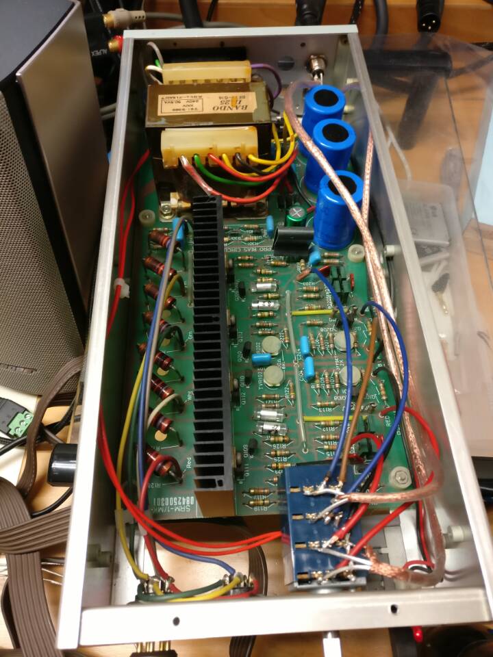

bwck2000 Posted February 11, 2017 Report Share Posted February 11, 2017 Attempt to add a xlr input to srm1/mk2 The balanced srm1mk2 is working but the sound is not pleasing,the sound is too aggressive ,too much highs,not as smooth as before as well It might Probably because of the use of silver-plated internal wires. ------------------------------------ Does anyone here have a 007mk2.9 with a serial no. of sz2-19xx? I saw a 007 mk2.9(bought in 2016) with such a serial no. but I once saw a 007 with a serial no. bigger than this one ,but in 2013 Quote Link to comment Share on other sites More sharing options...
spritzer Posted February 11, 2017 Report Share Posted February 11, 2017 Stax serial numbers mean absolutely nothing so you can't use them as any guide. That said, some retailers might have stock sitting for years before it is sold. Balanced and single ended should sound exactly the same and no...the wires are not at fault... Did you completely clone the - input off the + one? 2 Quote Link to comment Share on other sites More sharing options...
bwck2000 Posted February 11, 2017 Report Share Posted February 11, 2017 Yes ,completely The conversion is quite straight forward to make Quote Link to comment Share on other sites More sharing options...

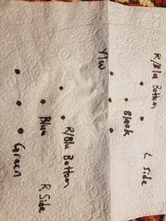

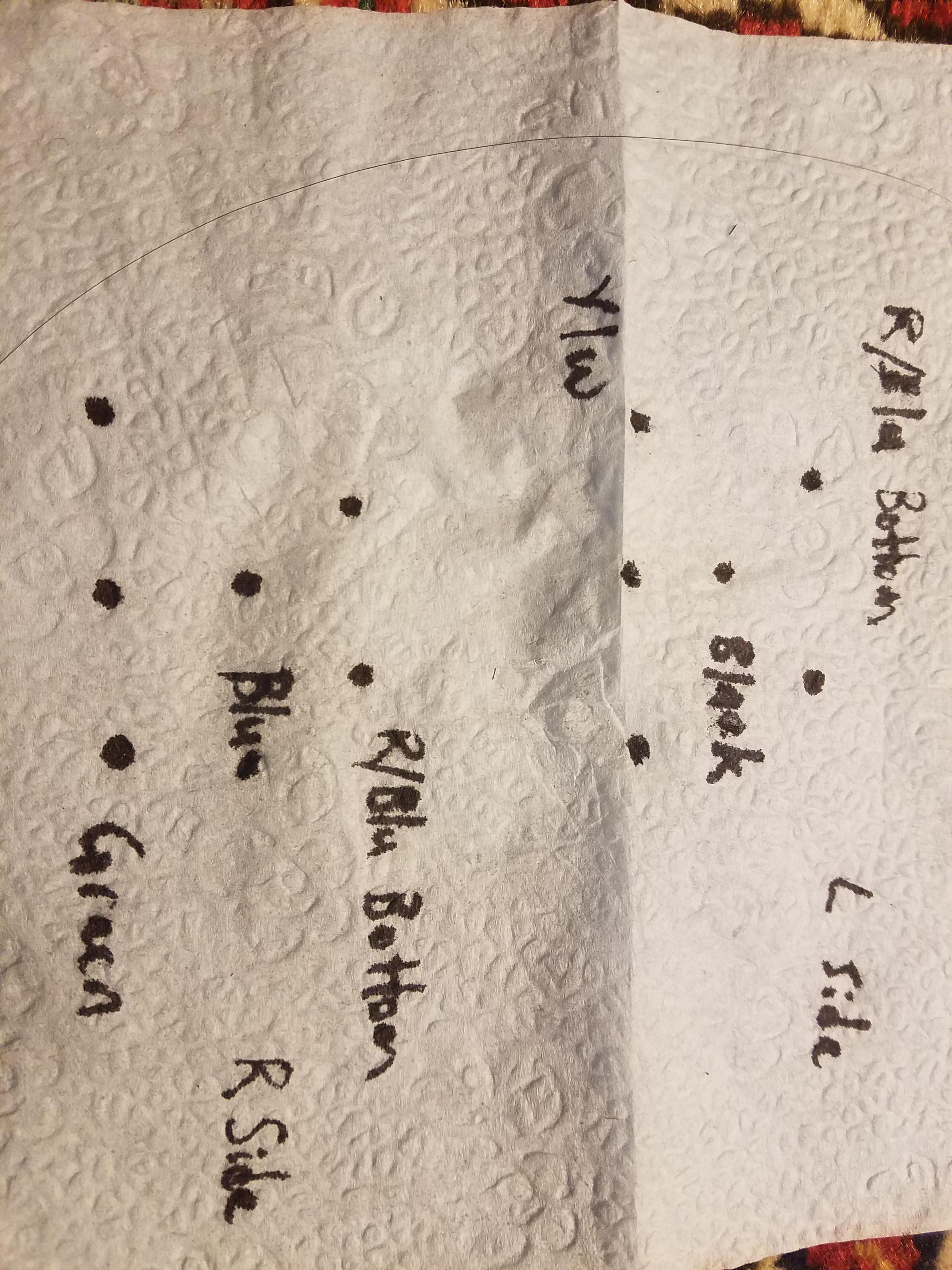

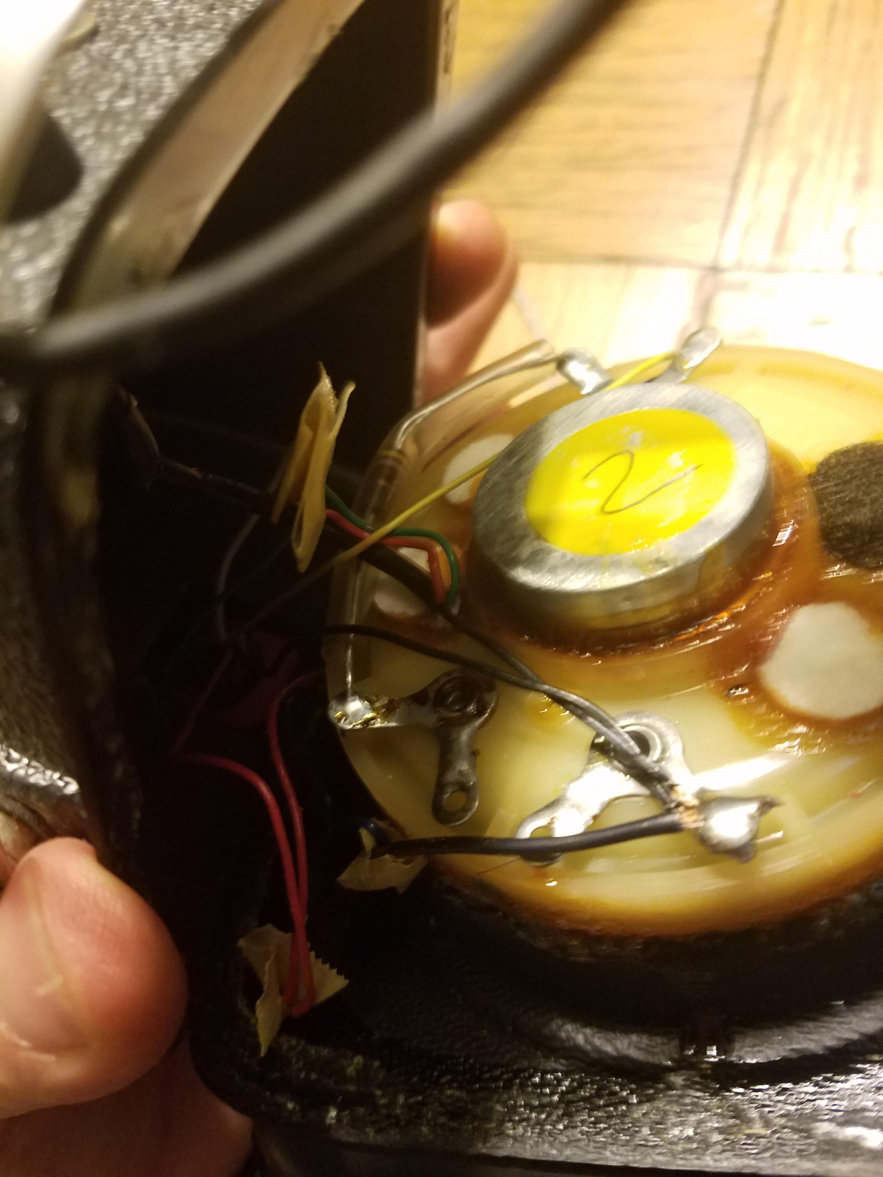

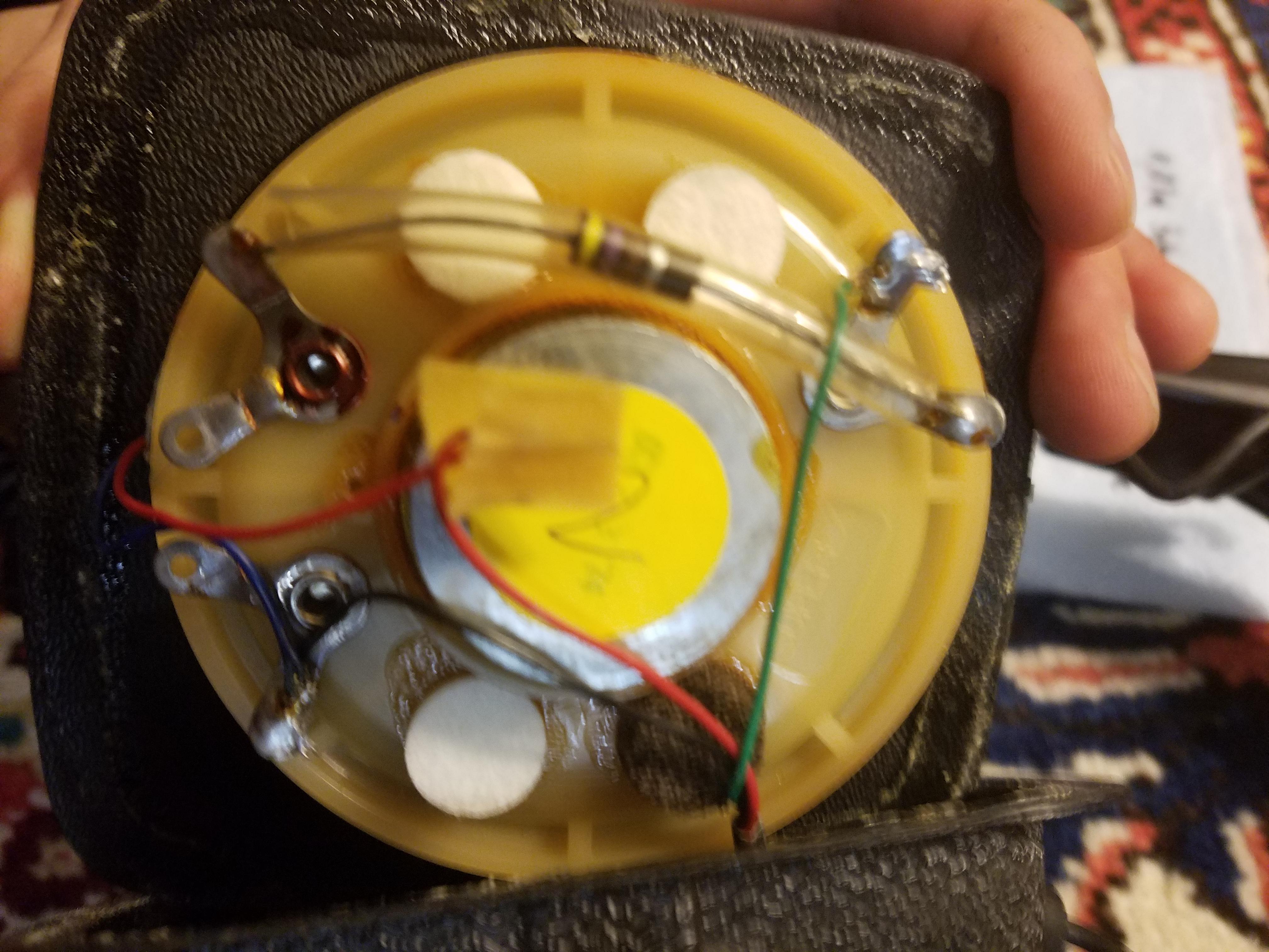

mypasswordis Posted February 14, 2017 Report Share Posted February 14, 2017 (edited) R/blue bottom means the crazy red wire that they soldered together and insulated with a piece of wax paper, which ends up next to a blue one at the bottom of the driver, held together with putty. Edit: the pinout I drew on the napkin is when you're staring at the plug straight on. Not the jack Edited February 14, 2017 by mypasswordis 1 Quote Link to comment Share on other sites More sharing options...
