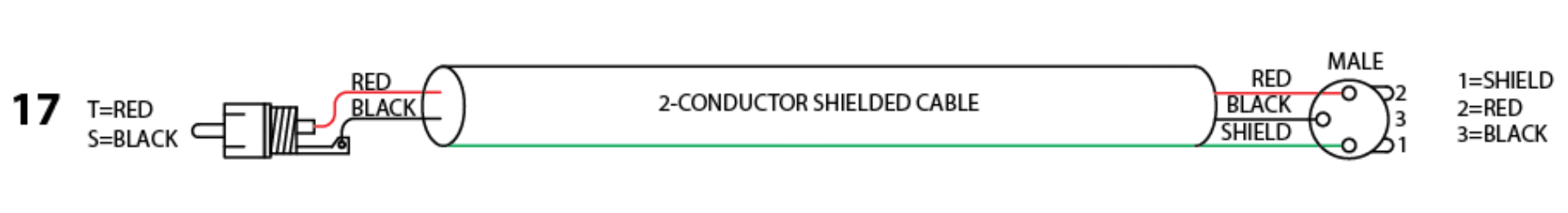

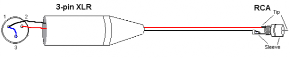

jgazal Posted January 29, 2017 Report Posted January 29, 2017 I'd like to ask for some advise on how to wire a cable to connect a source rca output to an electrostatic amplifier xlr input that have pin one connected to the chassis. I have male rca and xlr connectors and coaxial cable. I've read that the amplifier negative input fet must be shorted to ground. Which of the following two possibilities is correct? a - Strand two coaxial cables for each channel. Connect one center conductor between the rca + center pin and the xlr + pin two. Connect the other center conductor between the rca outer shell and the xlr - pin 3. Connect both coaxial cable shields to xlr pin 1 only. b - Use only one coaxial for each channel. Connect one center conductor between the rca + center pin and the xlr + pin two. Connect the coaxial cable shield between the rca outer shell and the xlr - pin 3 and short pin 3 to pin 1. In both cases, is a resistor between xlr - pin 3 and the rca outer shell (or xlr pin 1) necessary? Which resistance? Looking forward to hearing from you.
Dusty Chalk Posted January 29, 2017 Report Posted January 29, 2017 Doesn't it depend on the amp? A lot of amps that have balanced inputs do one of two ways -- you should check to make sure what the amp does, first.
jgazal Posted January 29, 2017 Report Posted January 29, 2017 Thank you for your advice. The input is a balanced dual fet LSK-389 and as far as I know it accepts a single ended signal as long as the negative one is tied to ground. People are used to insert a neutrik adapter which has (again AFAIK) the rca ground tied to both pin 1 and pin 3 inside the connector. But there is a paper in which Rane advises that option "a", i.e, the negative input fet of the amplifier is tied to the source ground. That's why I am still unsure what to do.

spritzer Posted January 30, 2017 Report Posted January 30, 2017 12 hours ago, jgazal said: Thank you for your advice. The input is a balanced dual fet LSK-389 and as far as I know it accepts a single ended signal as long as the negative one is tied to ground. People are used to insert a neutrik adapter which has (again AFAIK) the rca ground tied to both pin 1 and pin 3 inside the connector. But there is a paper in which Rane advises that option "a", i.e, the negative input fet of the amplifier is tied to the source ground. That's why I am still unsure what to do. Standard setup is to connect pin 3 to pin 1. On my amps everything is grounded together so that way works perfectly. 3 hours ago, emelius said: just out of curiosity, what's THE driver unit to pair with the sr-207?...w/o going stupid on cost... there's a store locally selling the 207s separate from the 2170 set...at not an unreasonable price... The 252S works perfectly for them but they do scale up nicely. Used 313 or something like that? 1
