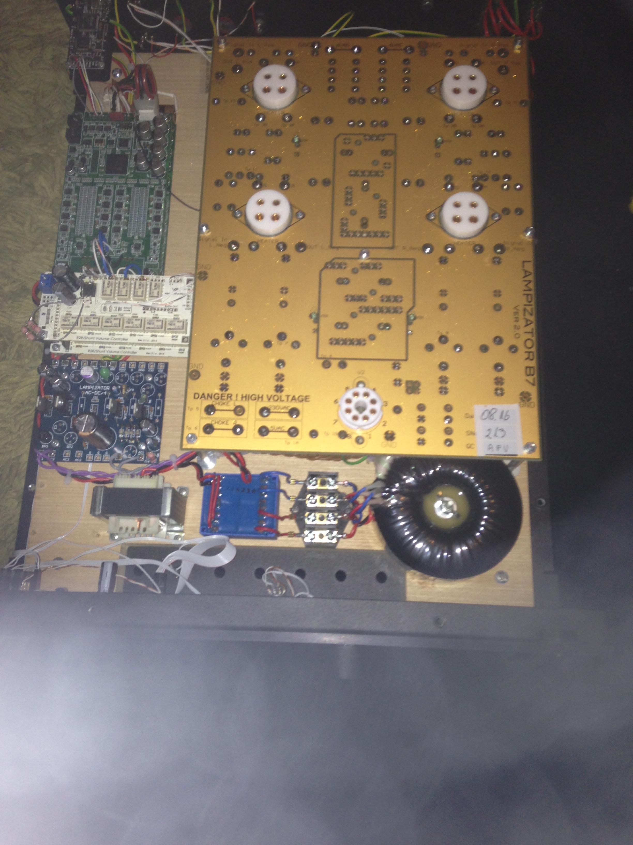

Dusty Chalk Posted December 1, 2016 Report Posted December 1, 2016 57 minutes ago, spritzer said: While on the subject of crappy dac's... I was sent some internal pics of the R2R Lampazitor dac today (Golden Gate I believe but who gives a fuck). Well let's put it this way, Single Power was better built than this pile of fail but what makes this utterly glorious is the actual dac... So this is a multi thousand $ dac and what does the actual conversion... a Soekris DAM1021 diy module. Yup... output directly off the end of that, fed into a relay volume control (again a DIY off the shelf module) and into what ever the fuck those tubes do. I'm waiting for permission to post the pics but this is utterly retarded... What about a discrete DAC? Does anyone make one of those? And would it even sound good? Quote

spritzer Posted December 2, 2016 Report Posted December 2, 2016 (edited) Indeed, it is a discrete R2R dac but it has quite a few issues. Fine at the 300$ price tag but at 7-10K? Not so much... Edited December 2, 2016 by spritzer Quote
JimL Posted December 2, 2016 Report Posted December 2, 2016 (edited) 3 hours ago, spritzer said: I'm waiting for permission to post the pics but this is utterly retarded... Don't have to wait. See my post from last Monday for some published internal pics of the Golden Gate taken from the 6 Moons review website and from Lampizator's own website. I especially love the way they bypassed the big capacitor with a smaller capacitor - is that electrical tape they are using, or duct tape? Inquiring minds want to know. 3 hours ago, spritzer said: 3 hours ago, spritzer said: Edited December 2, 2016 by JimL Sorry for the duplication. Quote

spritzer Posted December 2, 2016 Report Posted December 2, 2016 I just attached these as the world has to see this garbage. The list price is 19000$ plus the dac's which are 2000$. Yup...2k$ for two ~200$ modules. A few highlights for me are the mains transformer glued upside down into the wood with exposed mains wiring. Other parts glued into the bottom plate and almost no connectors used anywhere. I really think that is the best sign of a hack, shit is just tacked together with no care and they hope for the best. I think we have a new Single Power on our hands or Mikhail moved to Poland. 9 Quote

kevin gilmore Posted December 2, 2016 Report Posted December 2, 2016 the lampizator site clearly states that the tube stage does the I/v conversion. but the pictures clearly show the voltage output of the soekris dac (there is no current output) going directly to the attenuator modules, there are 2 because its balanced. there seems to be no discussion of the actual tube output stage, and rarely have I seen cathode followers done as dht, so its probably a low gain plate output stage likely with a plate resistor. Also the pictures would otherwise show 4 separate filament windings (well 5 counting the diode rectifier) if it was cathode follower. even Mikhail would have a hard time building a piece of crap like this. 1 Quote

kevin gilmore Posted December 2, 2016 Report Posted December 2, 2016 the 4 tube DHT version pictured last is definitely NOT srpp. Quote
dsavitsk Posted December 2, 2016 Report Posted December 2, 2016 I wasn't saying it was. I was saying that there is a long and documented history of Lampizator designing poor, dated, and/or inappropriate circuits and trying to pass them off as state of the art. Quote

JimL Posted December 3, 2016 Report Posted December 3, 2016 On December 2, 2016 at 3:22 AM, spritzer said: I just attached these as the world has to see this garbage. The list price is 19000$ plus the dac's which are 2000$. Yup...2k$ for two ~200$ modules. A few highlights for me are the mains transformer glued upside down into the wood with exposed mains wiring. Other parts glued into the bottom plate and almost no connectors used anywhere. I really think that is the best sign of a hack, shit is just tacked together with no care and they hope for the best. I think we have a new Single Power on our hands or Mikhail moved to Poland. Ah, Old World Craftsmanship! Quote
