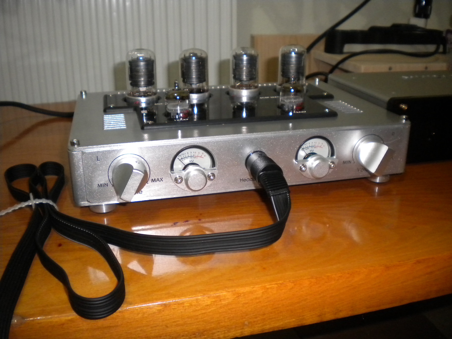

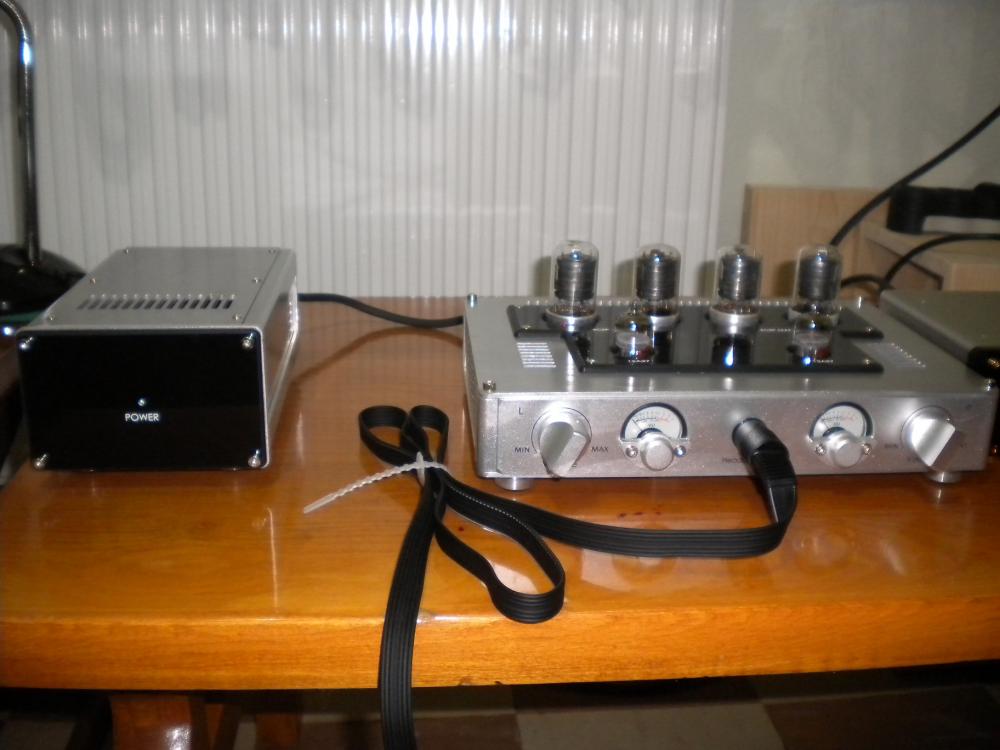

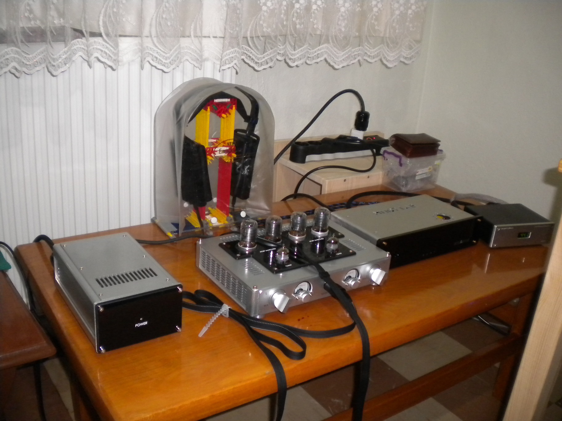

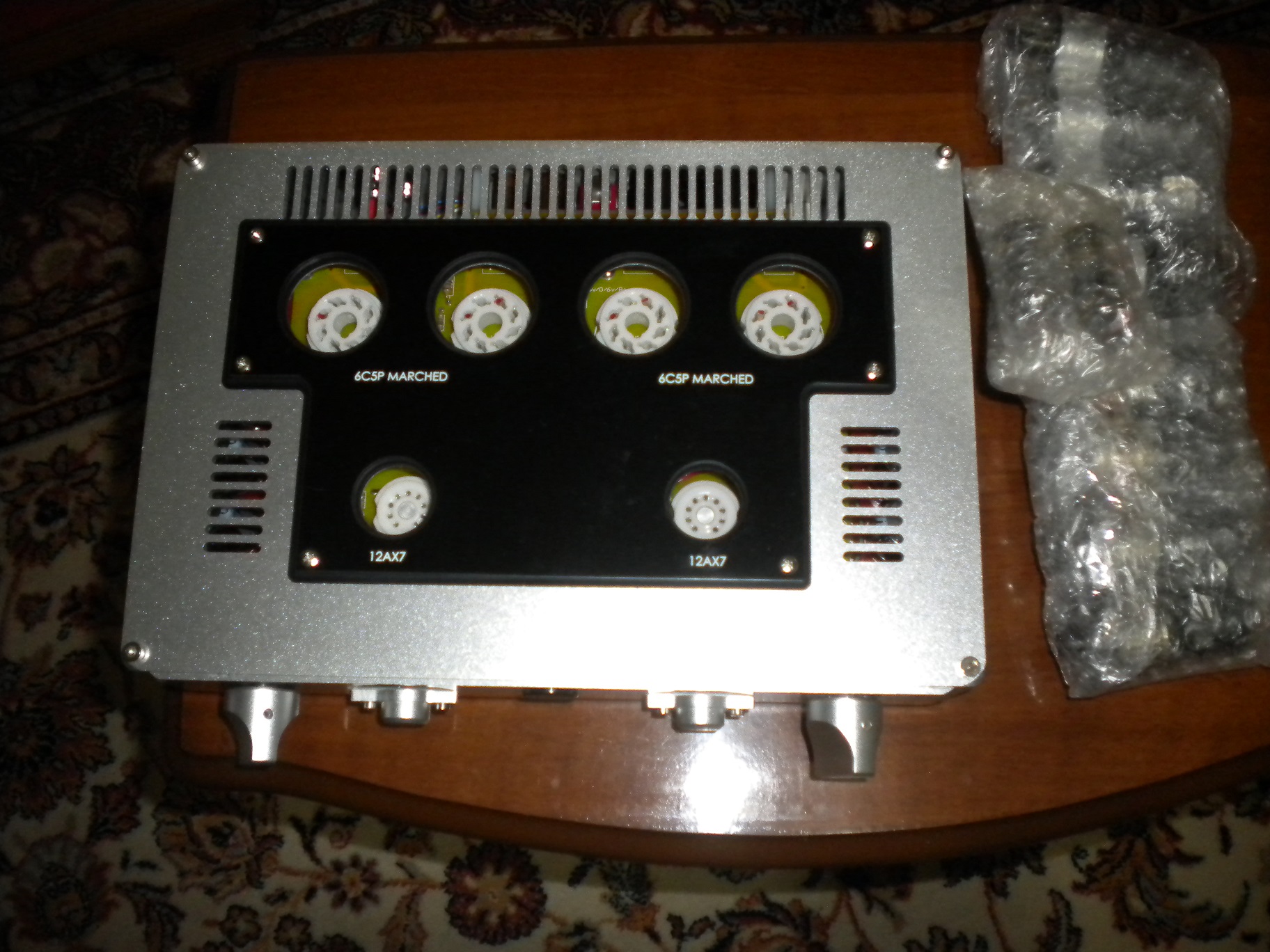

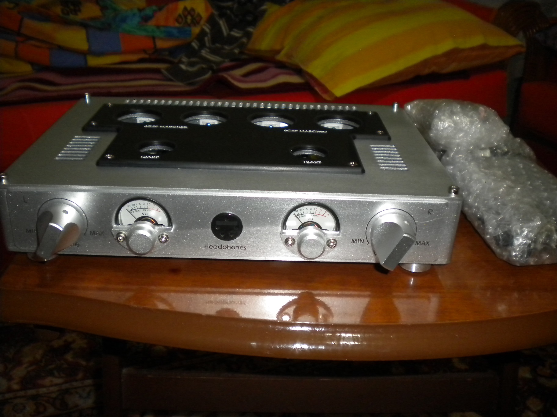

Sechtdamon Posted November 18, 2016 Report Posted November 18, 2016 (edited) Good thing happened too today, as comfortation. I got this today: This is the egmont clone that Birgir bought from China website. I was thinking for a long time for amplifier upgrade but I did not want to take 10 steps at a time, cuz I really want to progress slowly, for it's better and joyful to do. So with Birgir helping me a lot about lots of things, I bought it for the half of the price Birgir spent on it (not a discount, you can see how much he spent on this topic). Amplifier is extremely good for the money I spent, I've never listened it before modified but I read how bad it was before modified by him. But hey, he has magical hands. I mean, It is better than current top tier amps of Stax, imho. Thanks again Birgir. ps: I sold the bubble wraps and made some profit. Btw, I started to work about that top closure immediately. For a long time I wanted to work on granite. I'm making a granite cover for top of it. If I can succeed, I'll let you know when I start to work on full granite enclosures. And here is my current humble system: Edited November 19, 2016 by Sechtdamon 7 Quote

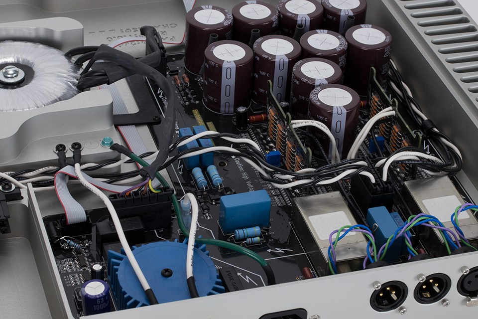

spritzer Posted November 23, 2016 Report Posted November 23, 2016 (edited) http://www.msbtechnology.com/amplifiers/headphone-amp-features/ Anybody want to guess what actually makes this thing tick? Look at all the bodges in a 37k$ amp... Edited November 23, 2016 by spritzer 1 Quote
Hopstretch Posted November 23, 2016 Report Posted November 23, 2016 I'm waiting for the Platinum Edition at $75K where they cryo all the bodges for you too. 2 Quote
nopants Posted November 23, 2016 Report Posted November 23, 2016 i wonder how much of the budget went towards the casework Quote
kevin gilmore Posted November 23, 2016 Report Posted November 23, 2016 (edited) the heatsinks and chassis bottom (and likely the top) are all sand castings. Pricy for sure. 450uf 300V power supply caps? Edited November 23, 2016 by kevin gilmore Quote
GeorgeP Posted November 23, 2016 Report Posted November 23, 2016 I think those are 450v chem-con caps - no boutique stuff here. guessing the chassis accounts for about 95% of the cost based on what can be seen here. Quote
spritzer Posted November 23, 2016 Report Posted November 23, 2016 That chassis is sure expensive but max 1k$ as they aren't doing one or two of them. As for the amp...the amount of suck on display is truly astounding. Also the sheer lack of proper engineering... Quote
GeorgeP Posted November 23, 2016 Report Posted November 23, 2016 in that case 60% then. also wondering what the heatsinks are for. Doesn't seem like anything is connected to them. Quote
kevin gilmore Posted November 23, 2016 Report Posted November 23, 2016 (edited) looking at the picture blown up. 450V, 330uf and if you look, 10 transistors, all in series, banks of 5. and lots of resistors to balance them all. (sot223-4 transistors) sure looks to be a bipolar version of the koss esp950. so its a voltage stacker. transistors are likely matched pnp and npn, and are rated for 250 to 300v (5 transistors with 900v total power supply) there are no power output transistors attached to the heatsinks input transformers are used as the phase splitters IF (more like when) it blows up, its impossible to repair. Edited November 23, 2016 by kevin gilmore 9 Quote

spritzer Posted November 24, 2016 Report Posted November 24, 2016 I just can't wait for the review to come on HF from a guy who was stupid enough to get those Woo monoblock piles of shit. Reminds me of when Ray got Skylab to review the A10 and we drove him into the ground for having zero electrostatic experience and thus...nothing useful to say. 2 Quote
JimL Posted November 24, 2016 Report Posted November 24, 2016 (edited) 5 hours ago, kevin gilmore said: looking at the picture blown up. 450V, 330uf and if you look, 10 transistors, all in series, banks of 5. and lots of resistors to balance them all. (sot223-4 transistors) sure looks to be a bipolar version of the koss esp950. so its a voltage stacker. transistors are likely matched pnp and npn, and are rated for 250 to 300v (5 transistors with 900v total power supply) there are no power output transistors attached to the heatsinks input transformers are used as the phase splitters IF (more like when) it blows up, its impossible to repair. Sure makes this statement 100% credible: "I spoke with MSB, as I expected they confirmed that they did all of the engineering work on the amp themselves, no outside source was used at any stage, contrary to some rumours here." BTW, anyone see any sign of a regulated power supply, or is it just lots of big electrolytic caps? Edited November 24, 2016 by JimL Quote
spritzer Posted November 24, 2016 Report Posted November 24, 2016 I can't see any signs of regulation but those heatshrink "things" between the caps intrigue me. Might just be a CRCRC supply or something like that. Needless to say...pretty shitty in a 2K amp let alone something this expensive. Quote
sorenb Posted November 24, 2016 Report Posted November 24, 2016 12 hours ago, kevin gilmore said: looking at the picture blown up. 450V, 330uf and if you look, 10 transistors, all in series, banks of 5. and lots of resistors to balance them all. (sot223-4 transistors) sure looks to be a bipolar version of the koss esp950. so its a voltage stacker. transistors are likely matched pnp and npn, and are rated for 250 to 300v (5 transistors with 900v total power supply) there are no power output transistors attached to the heatsinks input transformers are used as the phase splitters IF (more like when) it blows up, its impossible to repair. What happened to TOGTE btw? Quote
kevin gilmore Posted November 24, 2016 Report Posted November 24, 2016 those transistors are all obsolete, would have to be re-designed with available parts Quote
sorenb Posted November 24, 2016 Report Posted November 24, 2016 3 minutes ago, kevin gilmore said: those transistors are all obsolete, would have to be re-designed with available parts anything you plan on doing? Quote
kevin gilmore Posted November 24, 2016 Report Posted November 24, 2016 (edited) unlikely. I would never use a transformer to drive a voltage stacker like they are doing, something like 900v inside that transformer and i'm sure its not designed for that. Edited November 24, 2016 by kevin gilmore Quote
