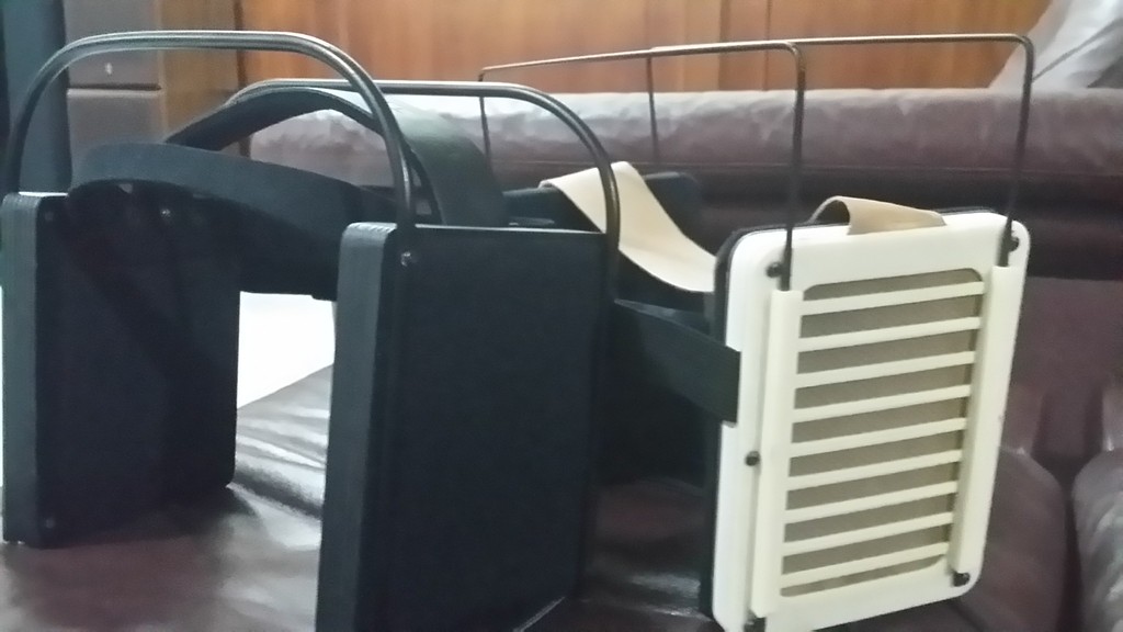

chinsettawong Posted September 8, 2016 Report Posted September 8, 2016 (edited) 46 minutes ago, insanity said: Thanks that is a very interesting fact to know. Do you have a dust free clean room to do your work or how do you prevent dust from entering the drivers? No, I don't have a clean room. I always spray paint my stators and it helps a lot with the noises. Here is my DIY version compares with the real JF. Edited September 8, 2016 by chinsettawong 5
mypasswordis Posted September 8, 2016 Report Posted September 8, 2016 Gorgeous work! I don't have access to my old PS2 Float at the moment to look over but hope you don't mind if I shoot you a few questions in a couple weeks. Quick obvious questions, though: what is the stator spacing and bias? Is it the same as the drivers in the new JF model?
chinsettawong Posted September 8, 2016 Report Posted September 8, 2016 20 minutes ago, mypasswordis said: Gorgeous work! I don't have access to my old PS2 Float at the moment to look over but hope you don't mind if I shoot you a few questions in a couple weeks. Quick obvious questions, though: what is the stator spacing and bias? Is it the same as the drivers in the new JF model? Thanks. I make these headphones to use with Stax compatible amps. The spacer thickness is 0.5 mm and bias voltage is 570V. 2
